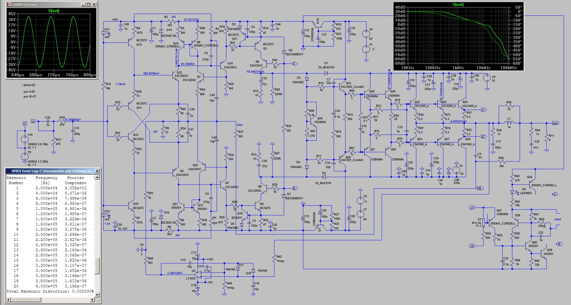

Hi guys. My Development Team Improved Dadods 100W CFA with Input Stage active load (current mirrors) and even lower distortion -100W:
https://www.diyaudio.com/community/threads/200w-mosfet-cfa-amp.243481/post-4857977

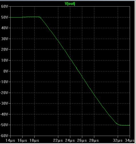

The amplifier turned out with very low distortion. Nice clipping. Little delay. Protection.

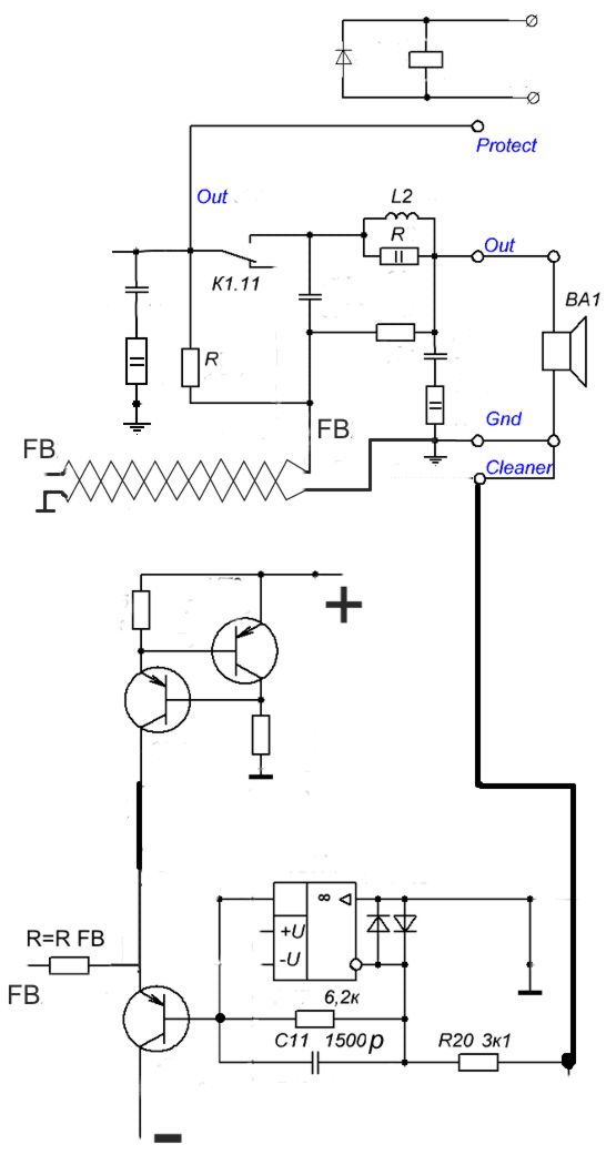

Andrew, the relay will not have time to protect the transistors. This circuit uses a fast trigger protection. The relay can be used for standard DC voltage output protection. Relay contacts must be covered by feedback. It is necessary to connect a high-resistance resistor in parallel with the relay contacts in order not to break the DC feedback.

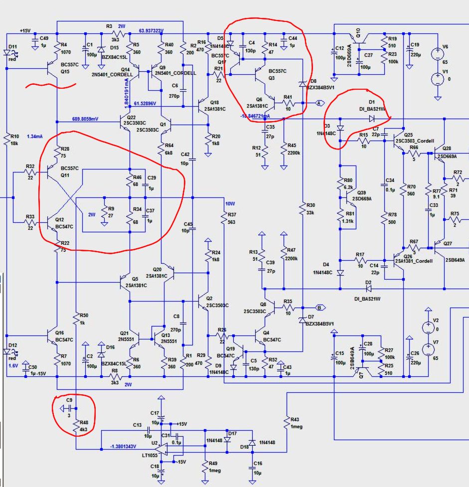

Hello de Ocampo. I showed the improvement in the diagram. 6.8 ohm resistors degrade thermal stability. Input transistors collector voltage-base equal to zero will not work normally.
I missed this thread.Hello de Ocampo. I showed the improvement in the diagram. 6.8 ohm resistors degrade thermal stability. Input transistors collector voltage-base equal to zero will not work normally.
I will not call it improvement, as overall feedback says transistor works with very low CE voltage. You used cascoded VAS, I tried it bat not need here where distortion is so low and it eats headroom. Different compensation, way?
