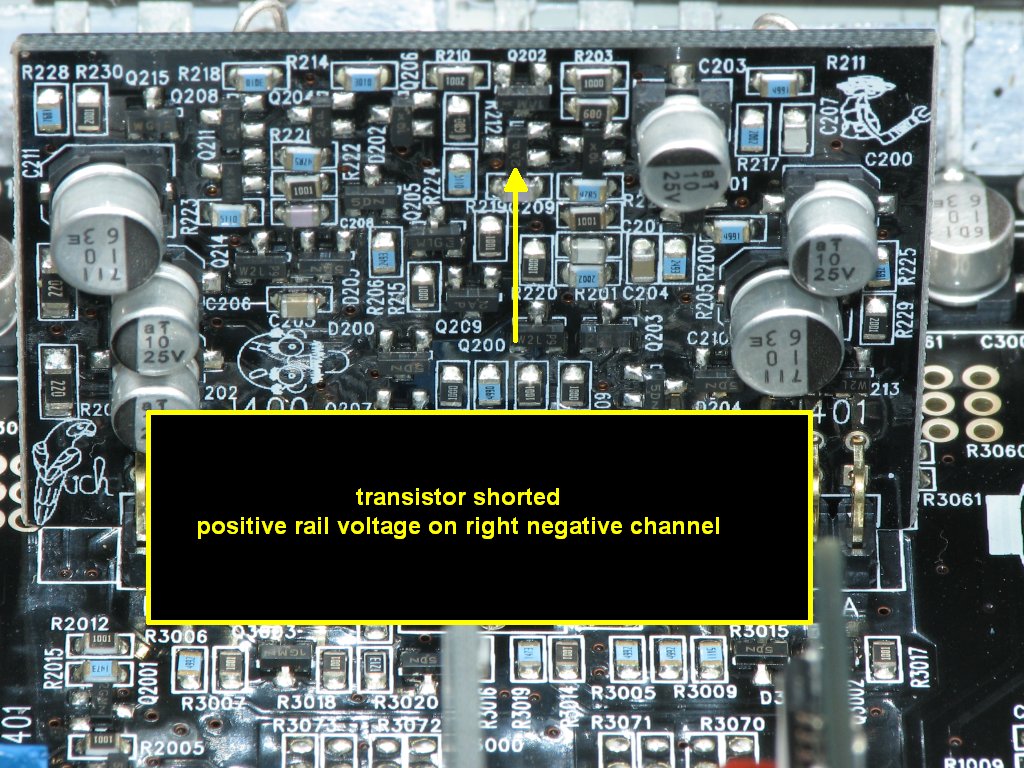

If the other driver cards aren't heating up lie this one, I'd think that there is a problem that needs to be found. If the other driver cards are the same model number (on the card), use the resistance of the various components around the component that's heating up too much to see if you can find the defect.

OK, I will play with the bias a little to see if it makes a difference then proceed to the driver card.
The cards appear to be identical (numbers match but will compare component population and values) so I'll pull a card from both amps and perform comparison testing (there isn't enough room to probe with the cards installed.) Sure am glad I added ChipQuik to my last order.
Do you have any concerns about testing the card from the P300-1 in the P400-2? I'm not really considering it but if I can't find a fault it would be a useful point of reference.
