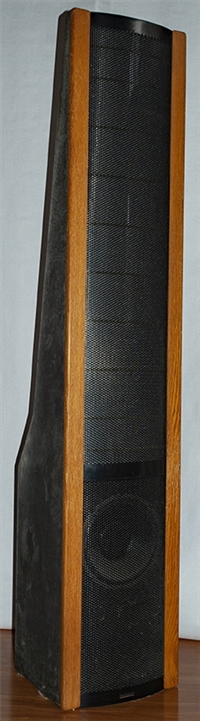

The Martin Logan ESL with 5 kHz sine, the same experimental setup as the 200 Hz square wave:
Signal of the sine wave in the amplifier input at the top, 20 mV/cm, 40 mVpp
Mid microphone signal 5 mV/cm, 6 mVpp
Down current signal 500 mA/cm, 1.25 app (output current of the amplifier into the input of the Martin Logan ESL).
As you can see, in contrast to the rectangle, there is full agreement of the waveforms of all three signals (amplifier input, amplifier output or loudspeaker input and microphone signal)

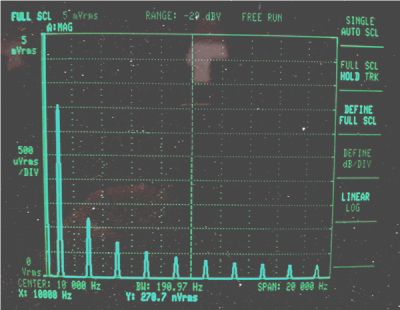

FT linear of the current signal 1.25 app, center frequency 25 kHz:
FT log of the current signal 1.25 app, center frequency 25 kHz:

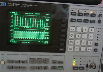

Hi BenToronto
"That's a software o'scope?
Good if we could learn more about all the pieces in the measurement loop because sometimes the faulty part is in the tool not the device being tested."
The FFT analyzer is a HP 3561A.
This analog scope is a Tektronix 7602 with a 7A26, 1 MOhm input, and a 7A24 50 Ohm input.
The sine and square wave generator is a HP 3310 B.
The current probe is a Tektronix P6042, the output is connected to the 7A24.
For the measurement of the high voltage amplifier output, inside the Martin Logan box, the Tektronix high voltage probes P6015 are used, connected to the 7A26.
"That last FT display, is it log or linear?
Likely your speaker would be around .1% THD and that would be visible as -60dB on a log scale but not as 1/1000 on a linear scale. (But linear is OK for the square wave products.)"
This FT display you have mentioned has a linear y-axis.
In the last new post I have presented a linear as well as a log plot of the FT current signal of the amplifier output.

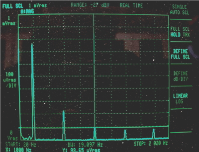

The Martin Logan ESL with 1 kHz sine wave, the same experimental setup as with the 200 Hz square wave:
Low level signal of the sine wave in the amplifier input at the top, 5 mV/cm, 6 mVpp
Mid microphone signal 5 mV/cm, 1 mVpp
Down current signal 50 mA/cm, 60 mApp (output current of the amplifier into the input of the Martin Logan ESL).
As you can see, in contrast to the square wave, there is full agreement of the waveforms of all three signals (amplifier input, amplifier output or loudspeaker input and microphone signal)
FT linear of the microphone signal 1 mVpp, center frequency 1 kHz:

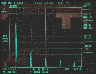

High level signal of the sine wave in the amplifier input at the top, 20 mV / cm, 40 mVpp
Mid microphone signal 5 mV/cm, 5 mVpp
Down current signal 200 mA/cm, 400 mApp (output current of the amplifier into the input of the Martin Logan ESL).
FT of the current signal 400 mApp, center frequency 1 kHz:
FT linear of the microphone signal 5 mVpp, center frequency 1 kHz:
