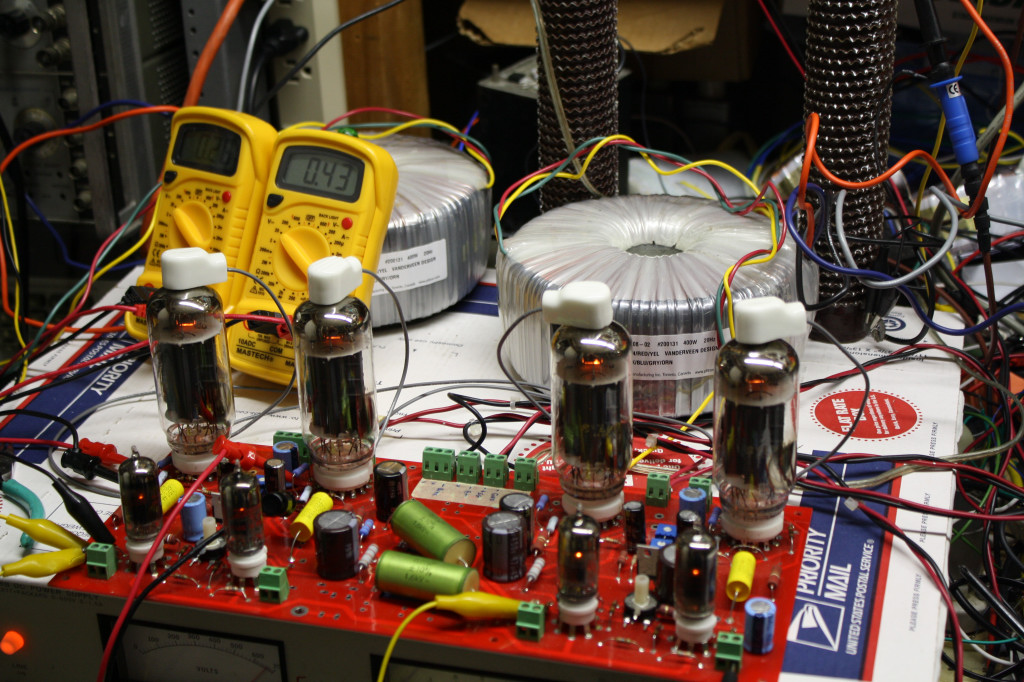

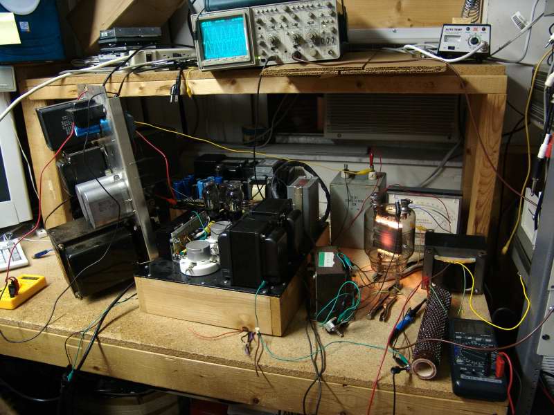

I started down the road to a 100+ WPC SE tube amp 5 or 6 years ago using 833A's. I paid a transformer winder who makes OPT's that are well respected on this forum to make me a prototype OPT. I put together a quick and highly unsafe prototype amp to test the OPT. The results were not good enough for HiFi use but it would make a wicked 200 watt SE guitar amp. I may build it some day, but I really have no use for it. The picture shows the prototype. The large chassis on the left is a power supply out of an old Motorola base station transmitter. It is rated for 1500 volts at 500 mA. The yellow Radio Shack clip lead carries the 1500 volt output! The amp chassis in the middle is my 845SE amp with the output tubes removed. The 833A is connected with clip leads. Note the high tech vice grips and hose clamps socket for the 833A. The custom OPT is to the right of the 833A and the 500 watt load resistor is in front of it.
6 years ago there was a thread about making a big amp using paralleled 807's. Someone mentioned some surplus Plitron OPT's that were rated for 400 watts at 20 Hz for $137 each. I grabbed a pair and so did a few other forum members. They were all sold in 3 or 4 days. I have been using them for experiments ever since, but they really want to find a happy home in a nice BIG amp. At low power (150 watts) the 3db points are below 6 Hz (my measurement limit) and 70 KHz. I have run them up to 525 watts at 1KHz.
I took one of Pete Millett's big red boards (engineers amp), paralleled both channels, stuffed it with 35LR6's, and connected both channels to one of these OPT's. I used a bench supply that goes to 650 volts and limits at 1.7 amps. At full tilt the amp made 525 watts at 5% distortion (just into clipping) and drew about 1.3 amps. The pictures show operation at 504 watts, the 3% distortion point.
When the time comes I think that I will do a pair of mono block amps in rack mount chassis. Probably 4 RU each. I have tubes that are bigger than the 35LR6, so 4 will be enough for anything short of continuous sine wave operation. I just finished a driver board design for the little 125 WPC amp that will also work here. I will need to find a suitable power supply probably using a big toroid, or a combination of smaller ones.

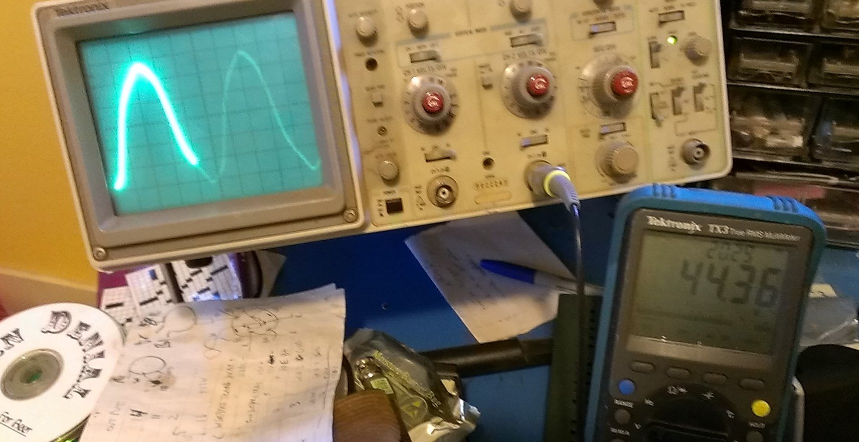

Impressive. Wish I could have got some of those plitrons. That was a total steal at that price! And they don't make them anymore. So I went and took some shots of my scope and voltmeter showing 500 watt output of one side at 1kHz, clipped 625 watts, and for those that don't believe me, an unclipped 492 watt 20Hz output into 4 ohms. Only problem is I can't post pics from my phone so it'll have to wait til I get to work Monday since I don't pay for internet at home. I know, sounds like a cop out but its true!

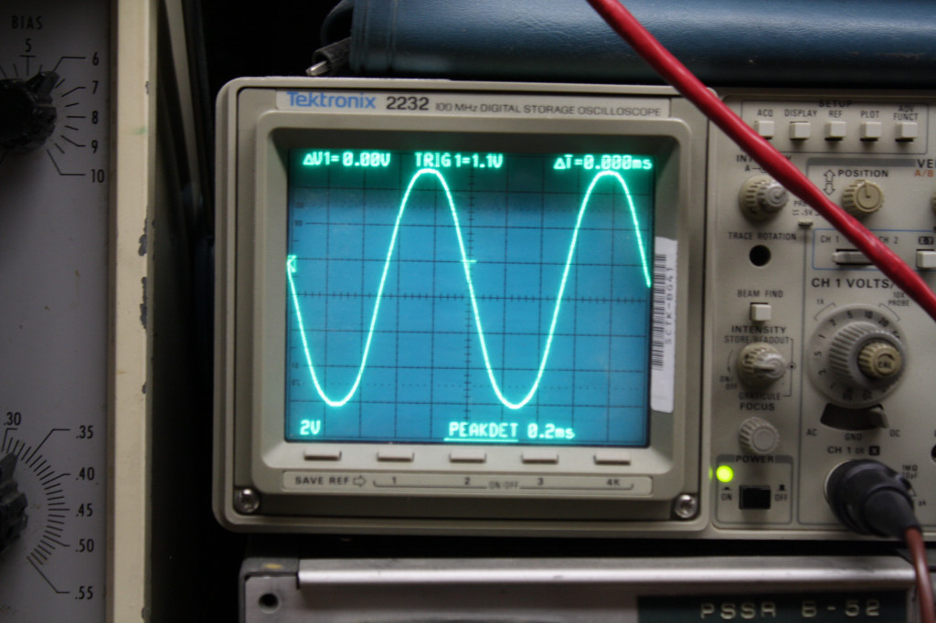

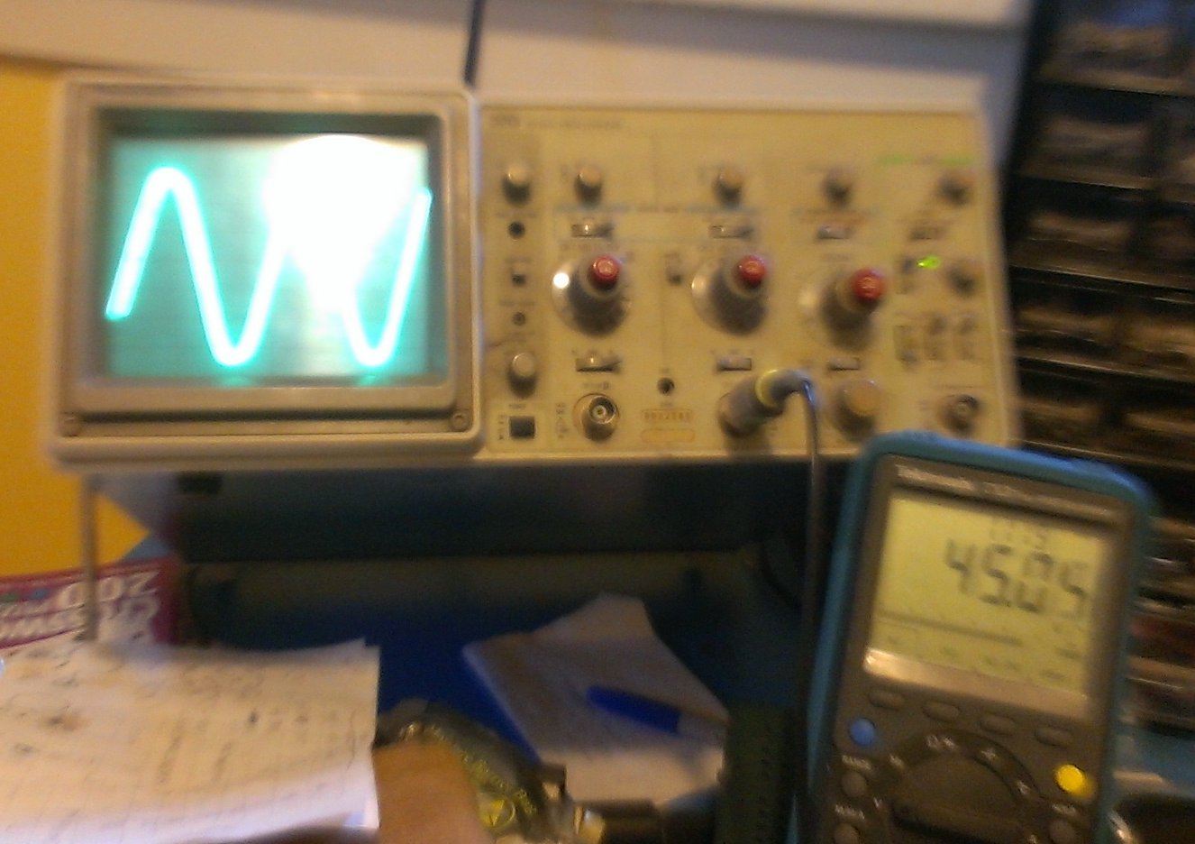

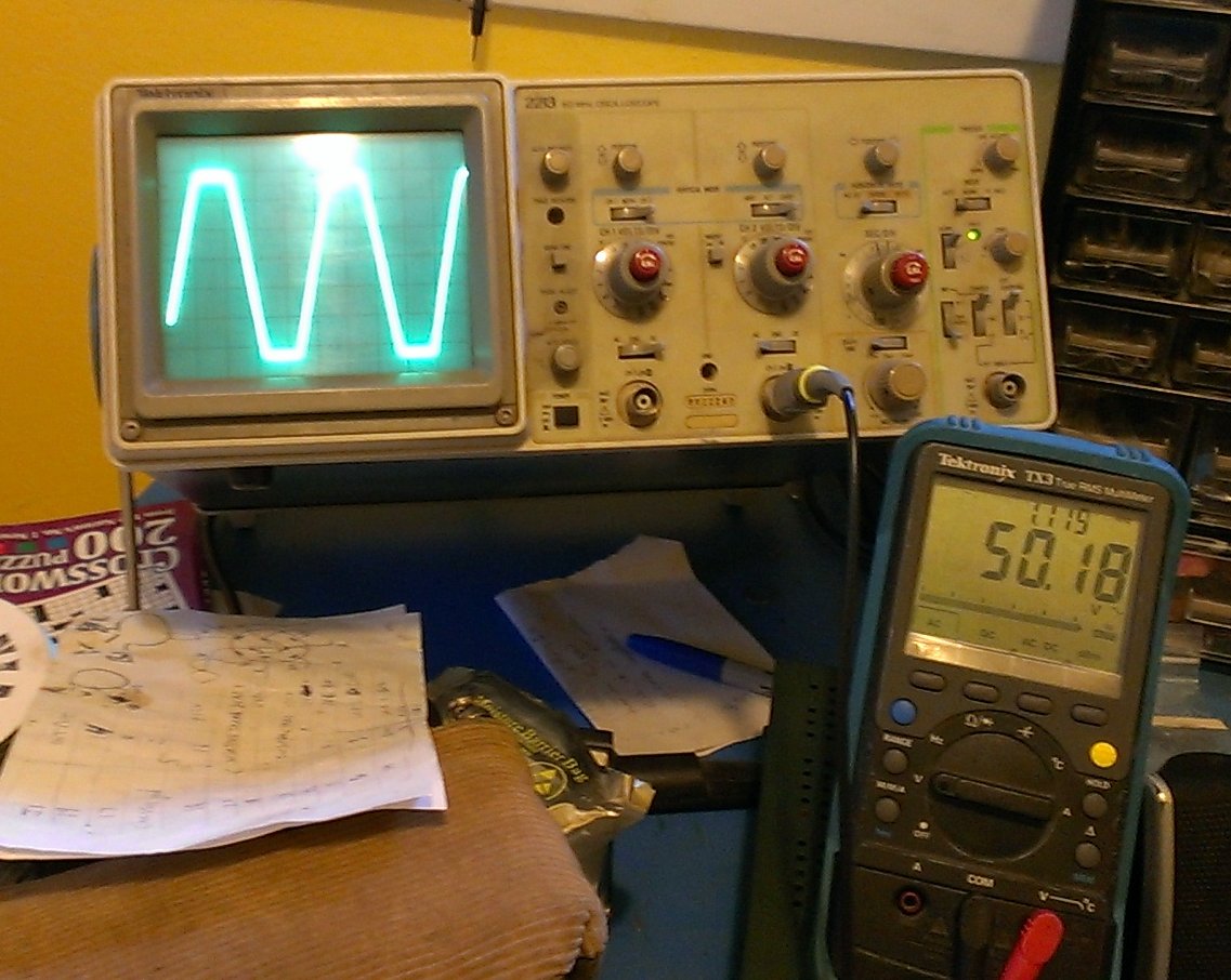

As promised, here are some output results. Sorry for the flash on my scope screen! First one shows 45VAC RMS into 4 ohms, the second clipped at over 50, and the last is the output at 20 Hz. The frequency is displayed in the top corner of my handheld meter. There is some distortion thereat 20Hz. Some of that is from my subpar signal generator though. It doesn't do the best at low frequencies, I really need to get a better one. But you can see there is no crossover distortion or clipping going on with full output at that frequency.
You appear to be under a misconception?, crossover distortion occurs at very LOW power levels, not at high power levels (and isn't something that valve amps do anyway).
