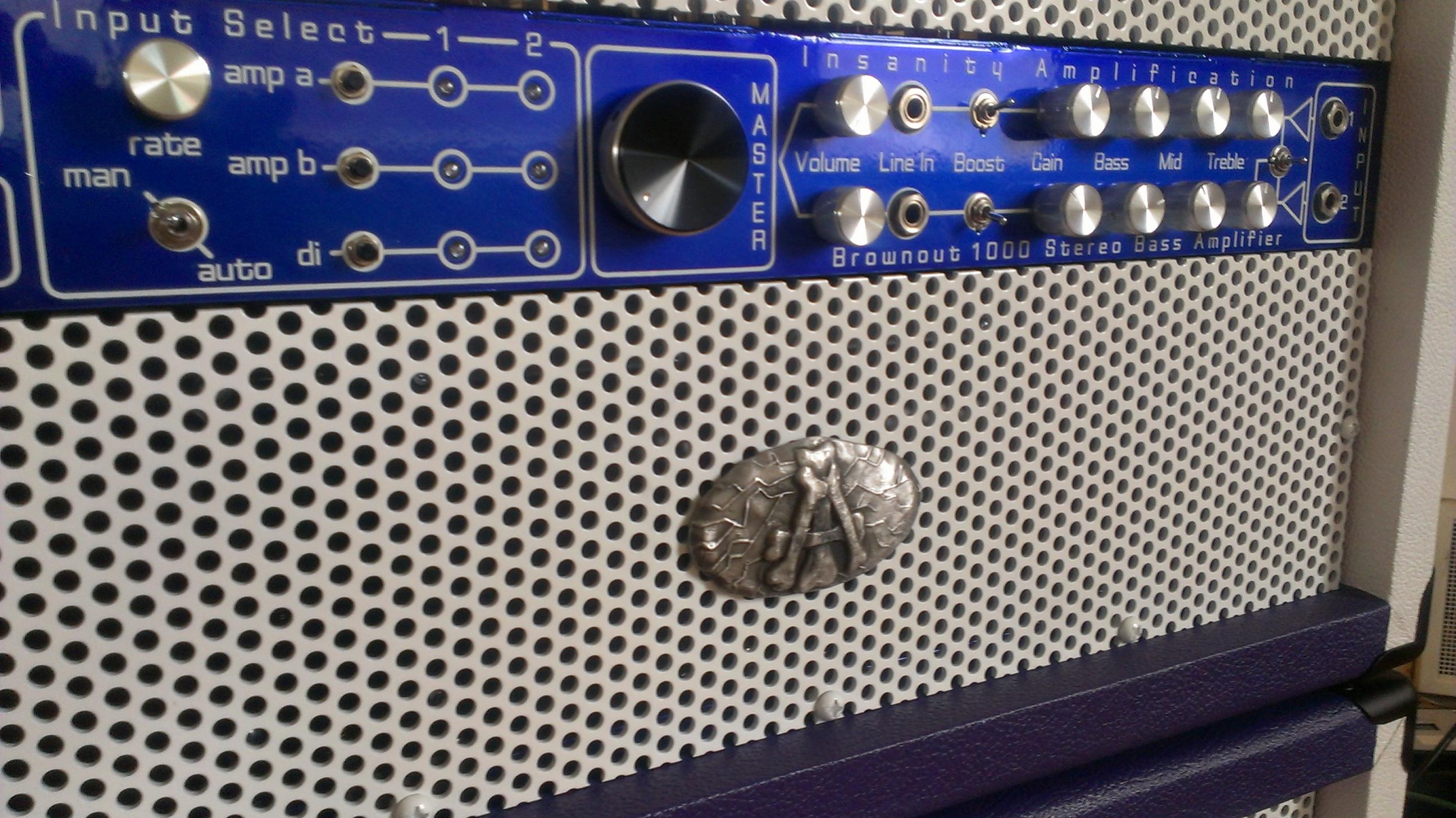

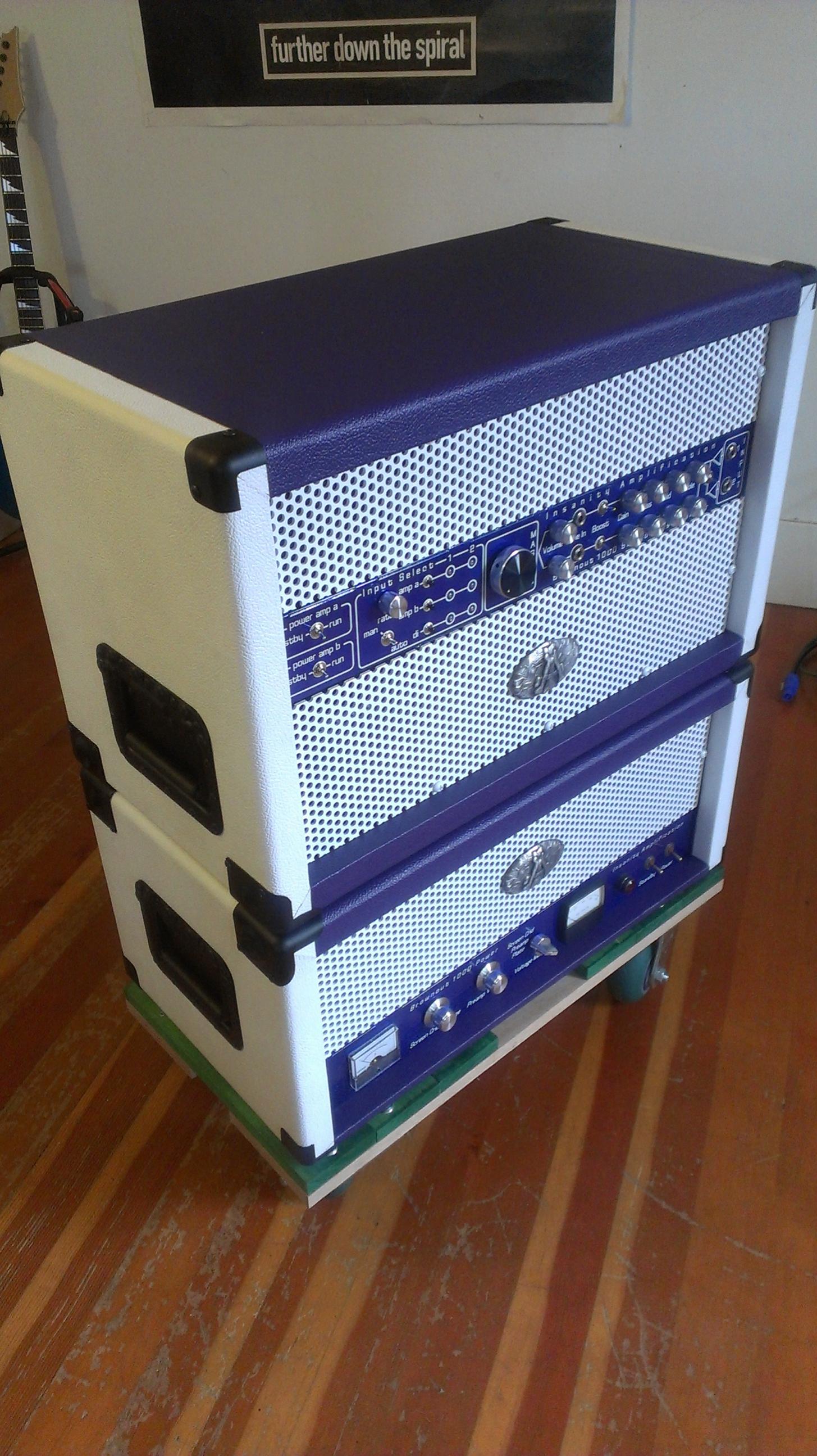

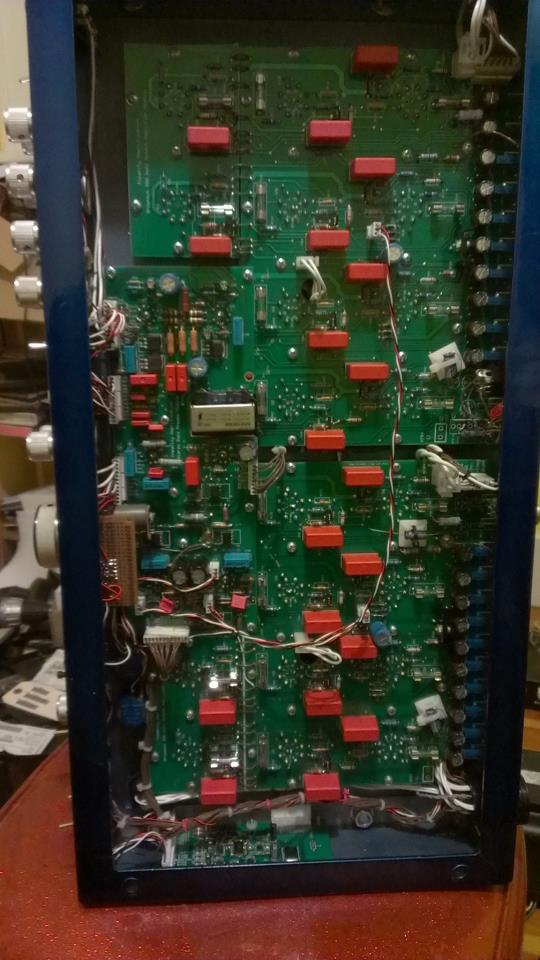

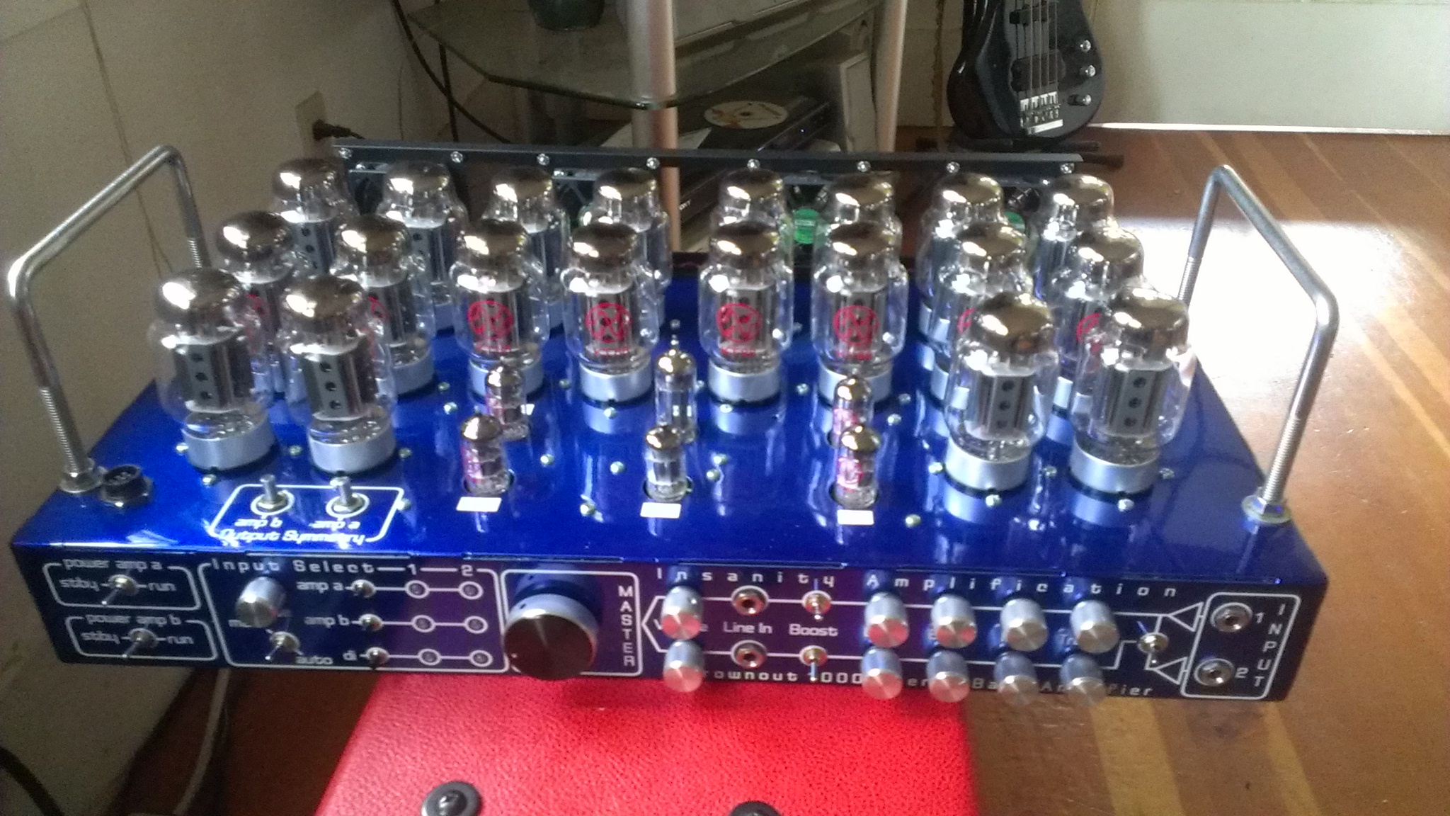

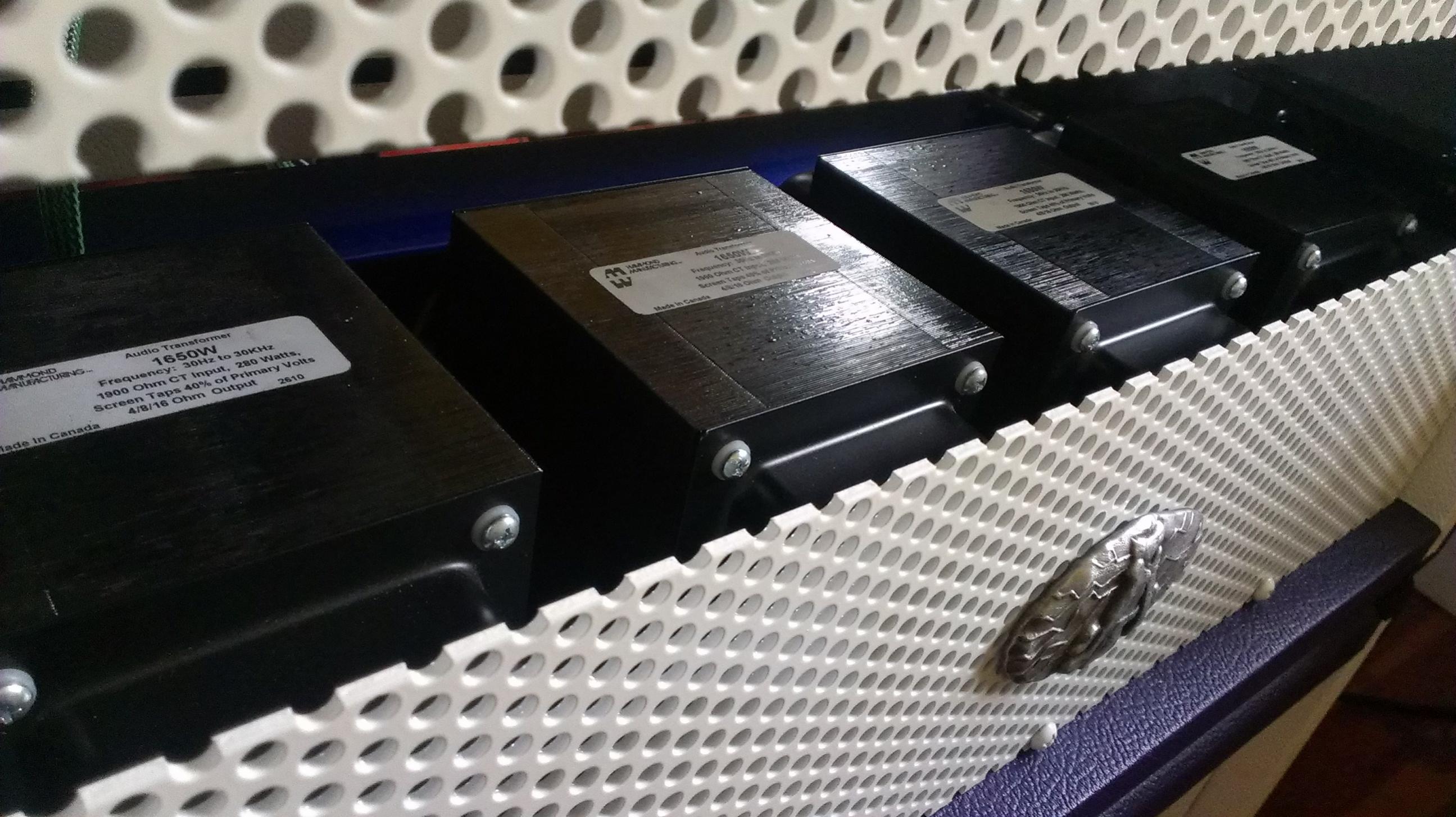

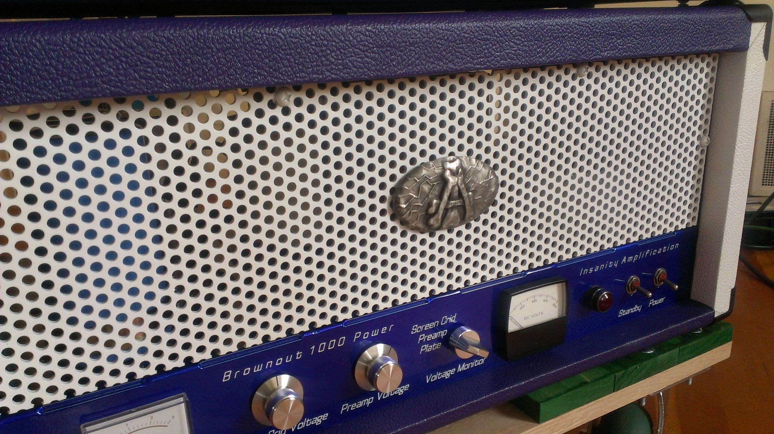

Alright boys and girls, here it is. I'm done...after about over 3 years of working between other projects, lots of testing, tweaking, and circuit changes, my 500 watt per channel stereo bass amplifier "Brownout 1000" with stereo preamp is finally finished. It did not quite deliver a full 1000 watts RMS before clipping while testing, however. I only got about 940 total but the line voltage at the wall outlet would drop from 120V to 113V where I was testing which I attribute to old wiring in my house which was built in the early 1900's. Running one side at a time will yield over 500 watts RMS output before clipping. So that amp lives up to its name! I ended up getting a custom toroid wound for the plate supply. It idles at 650VDC with 20 kt88's biased at 30mA each. At 1000 watts output the unit drew just under 17 amps from a 120VAC outlet, and 2.5 amps from the plate supply which at that point was 580V. Full power frequency response is very good. -3dB points are 15Hz and 23kHz. I designed it for bass guitar amplification and the fundamental frequency of low B on a 5 string bass is 30Hz. The amps will deliver full power at this frequency. I have not run it at high volume into bass cabinets yet. Low power yes but mostly through the line out into a practice amp so far. All power testing has been done with large resistive loads. I need someone to help me move it out of my house to my jam space since the amplifier weighs about 150 lbs and the power supply is around 80. Here are a few shots...
