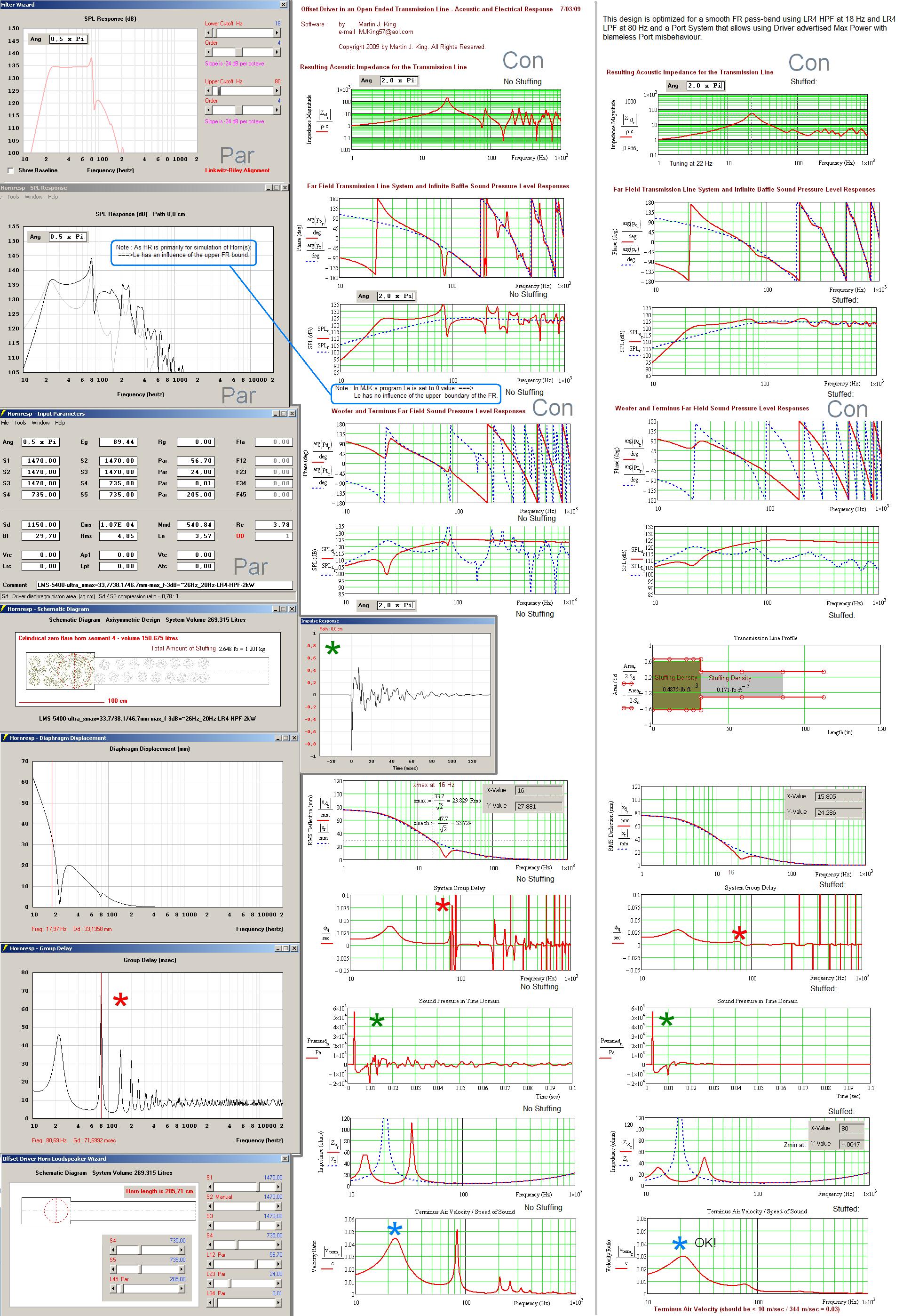

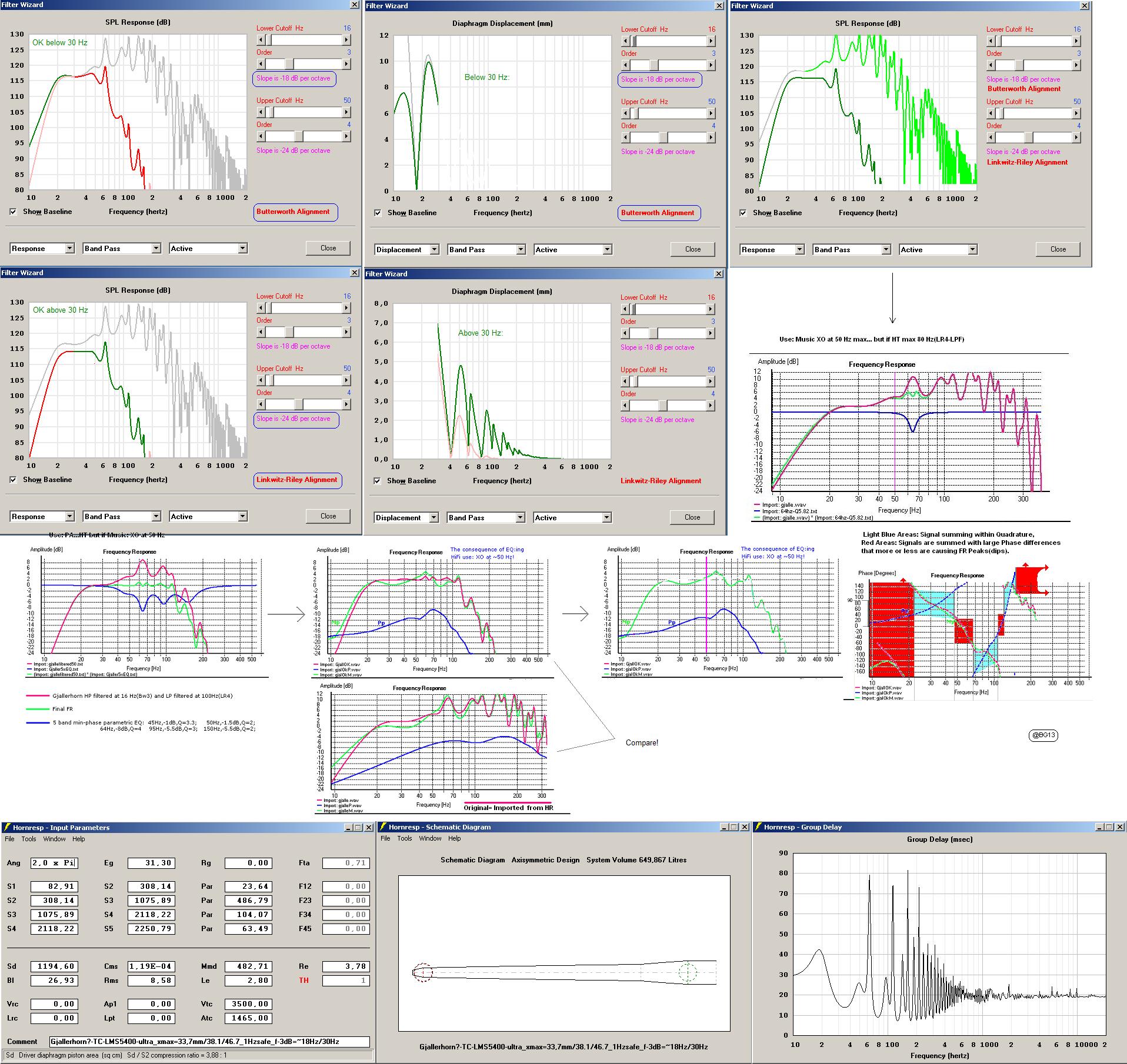

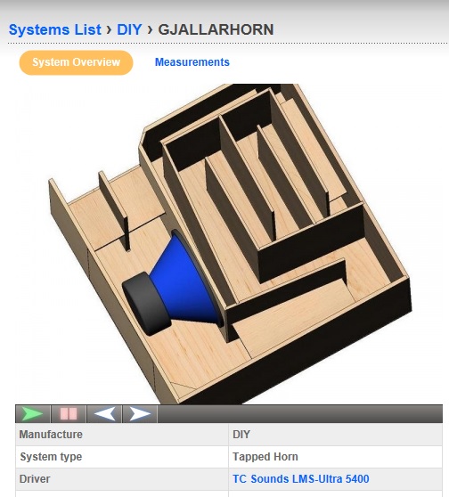

..keep looking at the folded horn idea but don't know how to use Hornresp to make sure I am getting the absolute maximum out of it. I can model a more simpler BR box in Bass Box Pro..
Hi Silent Screamer,
I suggest to use(learn) HR instead of BBP that cannot deal with quarter-wave resonances as soon as they appear in any enclosure.
Due to the recently added possibility in the HR Wizard: A Filter option is added that when invoked gives a good indication of how good the in-band plausible performance would turn out in the reality.
Have a look at a Ported Quarter-Wave design using the TC Sounds LMS Ultra 5400 driver optimized for, IMO to enable great performance if Ported:
Especially compare the Filtered HR FR with the superior MJK FR plot when using damping material.
..The problem is when I put the Gjallerhorn figures in Hornresp the figures don't look as good as a BR box. I don't know if a folded horn would be better, or if the BBP figures are overly optimistic...
Agree. A folded Horn would be huge...m^3 size at least...BBP, WinISD are IMO best to avoid...

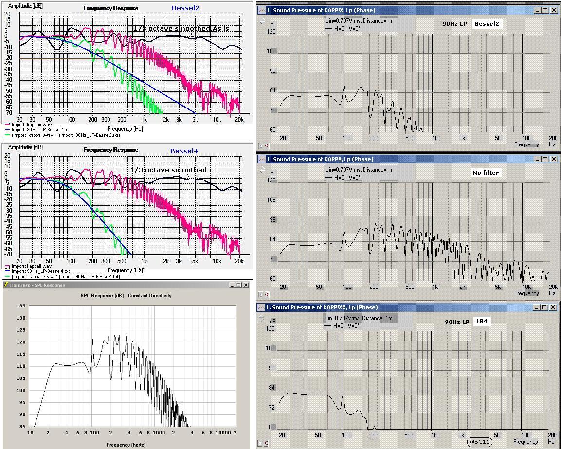

The Second of posted pictures is an addition to the simulations, earlier posted here:
http://www.diyaudio.com/forums/atta...y-system-eminence-kappa-pro-lfii_-375l_th.jpg
http://www.diyaudio.com/forums/atta...tem-eminence-kappa-pro-lfii_-375l_th_plot.jpg

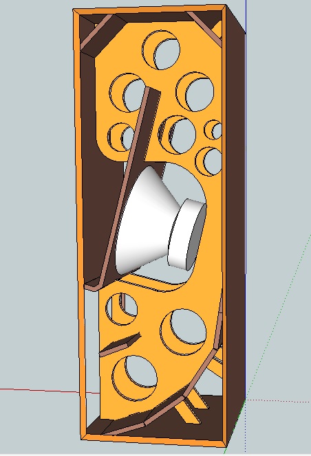

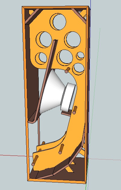

Further refinement on the idea… Trying to kill two birds with one stone. Create well braced internals, and keep the curved sections of the horn expansion more consistent. Once the bracing is complete, build the outside casing around it. Or partially build the outside case, but allow easy fitment of internal bracing. Also thinking could use some expandable foam behind the curved sections before sealing up the outside case.
Did you model this in hornresp.............?
No final designs, but I am just working on the construction method at the moment. Basically I am just looking for a up and back approach, if that means I have to tapper it at the top or widen it at the bottom to achieve the right shape that is not a problem.

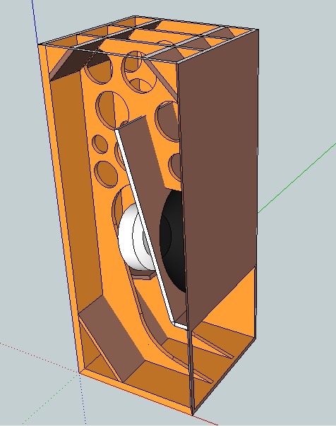

Still refining the idea but now thinking I could make the mouth a lot more rigid if I feed the driver in from the side from an access panel.
Which is NOT AT ALL CLEAR. 😱

If I was going to go BR, I would be going with a designed very closely modeled on this...
That's very well designed sub, certainly a benchmark design. But you could get nearly same results in half the volume and use a properly designed slot port which would be much simpler to build.
I would simply do something like this below, but with a ~15 cubes internal volume and a massive slot port on the bottom that makes a 90 degree turn up the back wall, tuned to about 15 hz. With large roundovers on the port and a 45 in the turn, it should have minimal port noise and compression if the port is sized for about 20 m/s max.
http://www.data-bass.com/data?page=system&id=1

Just looking at that Gjallerhorn... I might need to alter my current design some to get the mouth area smaller.
