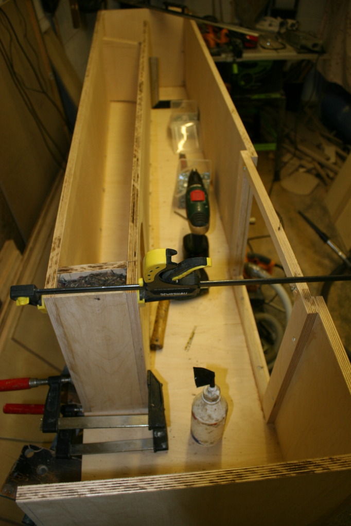

Hi Guys just to fill in a few of the missing blanks here... basically the LMS 5400 is going to be a low frequency sub, which will be used for movies only. The two Pro 5100s I am currently using as woofers will also be made into subs, but probably tuned at a higher frequency as per the Geddes 3 sub approach.
I keep looking at the folded horn idea but don't know how to use Hornresp to make sure I am getting the absolute maximum out of it. I can model a more simpler BR box in Bass Box Pro.
The problem is when I put the Gjallerhorn figures in Hornresp the figures don't look as good as a BR box. I don't know if a folded horn would be better, or if the BBP figures are overly optimistic.
So really in two minds which way to box up the LMS 5400. If you look back at the link I posted earlier, you will see that I can brace a BR box far more effectively than a FH.

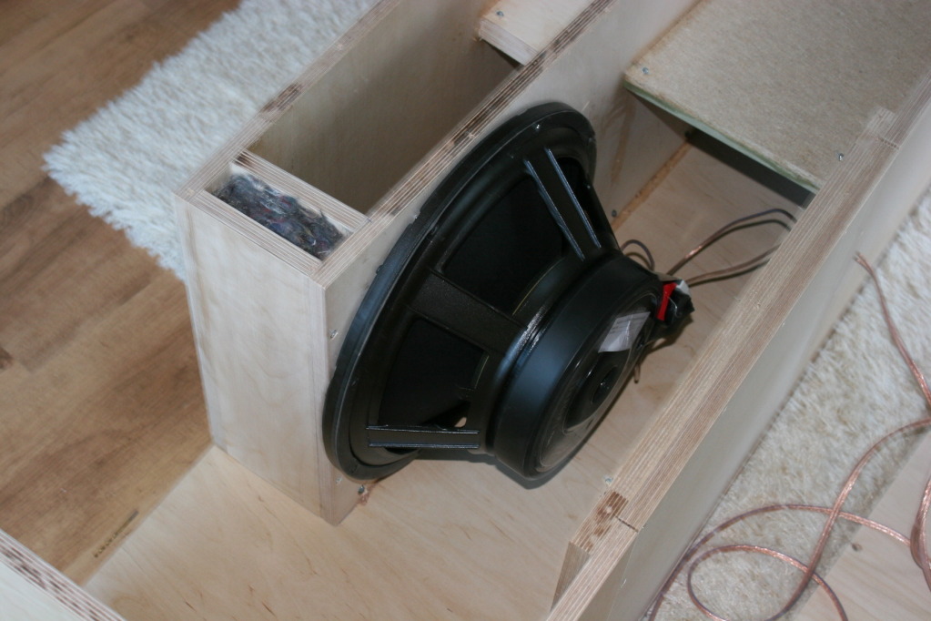

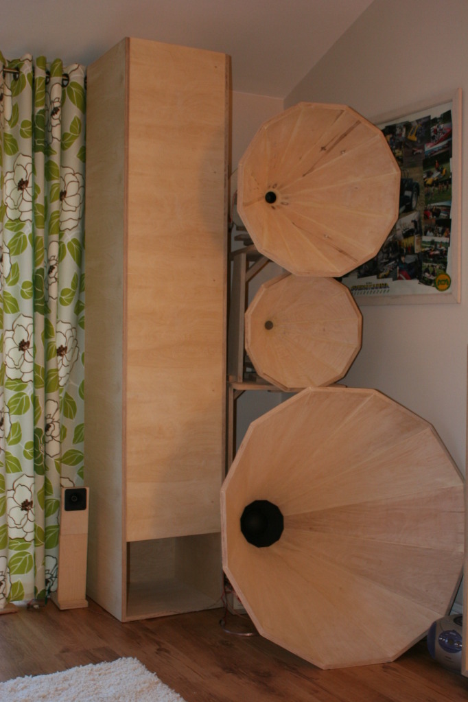

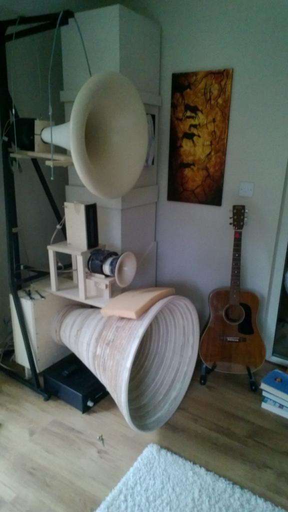

What I have had my eye on for a while now is a thread built around 5 way horns.
http://www.diyaudio.com/forums/mult...-tapped-bass-mids-tweeter-big-boy-system.html
Not really interested in the horn part, but the TH he used for subs in the corners of the room I am.
Ok so it doesn't follow the conventional square box with lots of folds route, but if you don't mind it being tall (which I don't) this would seem a much less complicated box.
Obviously I would look to see if the design could be improved on but the basic up and back would be what I have in mind.
