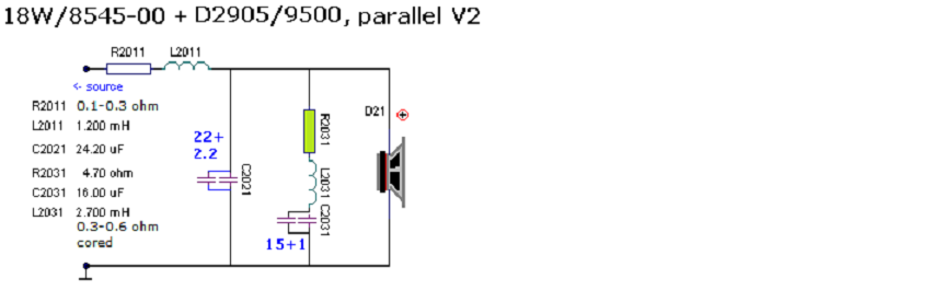

Hi Merlin,
I see you are making good progress with your crossover, great. Based on my simulation I propose some minor modifications you can try easily. Disconnect the zobel on the woofer, split the resistor of the tweeter and wire both drivers in phase. At least the simulation looks decent now and I hope the sound of your speaker doesn't tell the opposite.

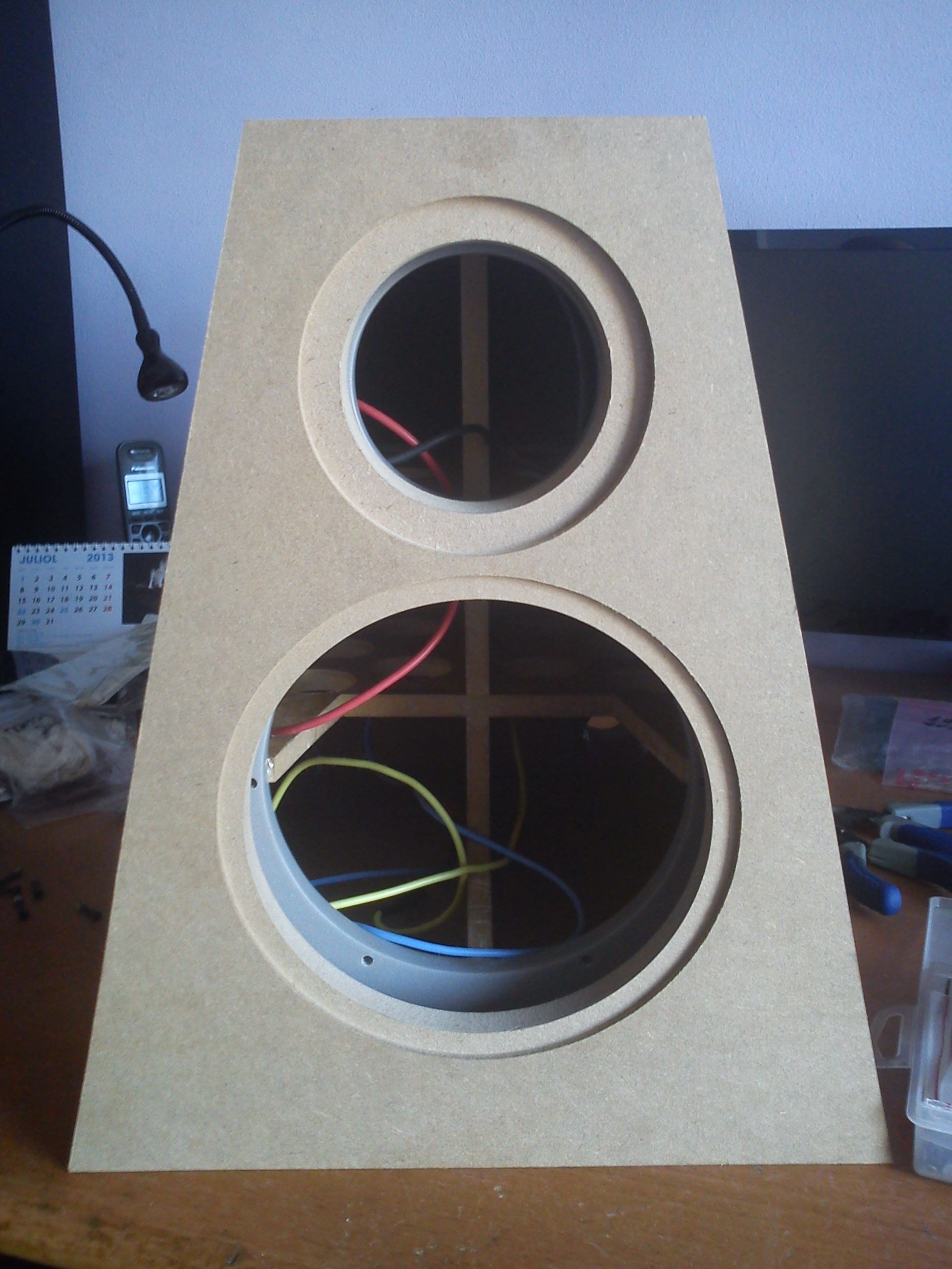

But if the sound is wrong, maybe in the treble, the tweeter is not flush mounted and the edge of the baffle is a step. It can have some serious diffractions problems in the treble. It's a pitty to have a so good tweeter with a non optimal mount.

Hi Merlin,
Disconnected the Zobel on the woofer, again better sound, I have to order the components to change the tweeter's xover, thank you.

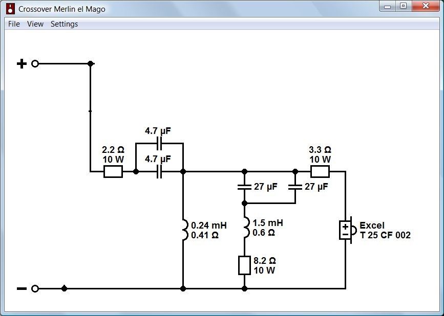

Finally ended the xover like the attached pics

How can attenuate more or less the tweeter, increasing or decreasing value or 2R2?
More resistance, more attenuation. You can work on both 2R2 and 3R3 components.
Also can I use 0.22mH in place of 0.24mH if yes have I to change something more?
Using a 0.22mH inductor instead of a 0.24mH one will slightly change the rolloff - for the better or the worse I don't know. I suspect it is difficult to notice the difference. If you absolutely need the exact value buy a larger inductor and unwind. Some shop will do that for you.

Hi, The simulation has no particular problem. I can say if I think something good 😉

The crossover is done for unaligned driver.
You have to change the crossover if you change the position of the drivers.
Better to mount correctly the tweeter.
See at the end of this page :
Loudspeaker Measurements

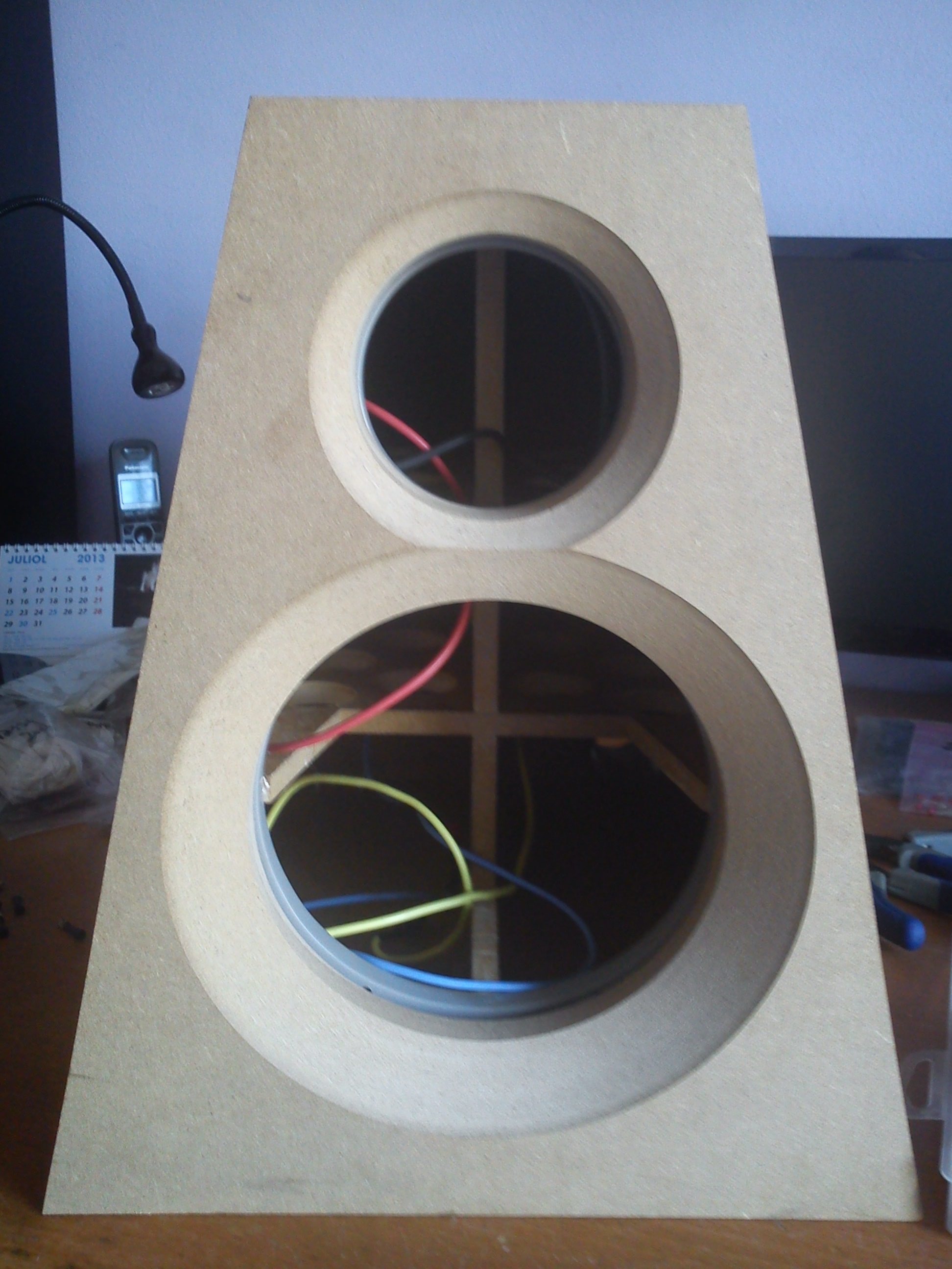

Attached pics (outside & inside) to mount the drivers correctly😉 now time to stick and to allow that it should dry off 24 hours🙂
