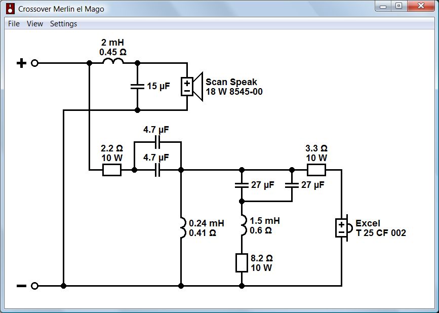

Thanks Dissi, coils available for the tweeter have other resistance:
0,24 mH 0,21 ohm
1,5 mH 0,38 ohm
Have I to change something?

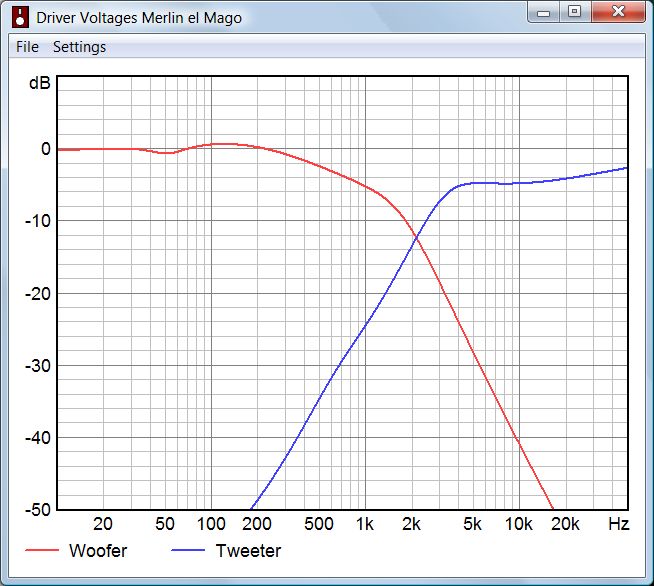

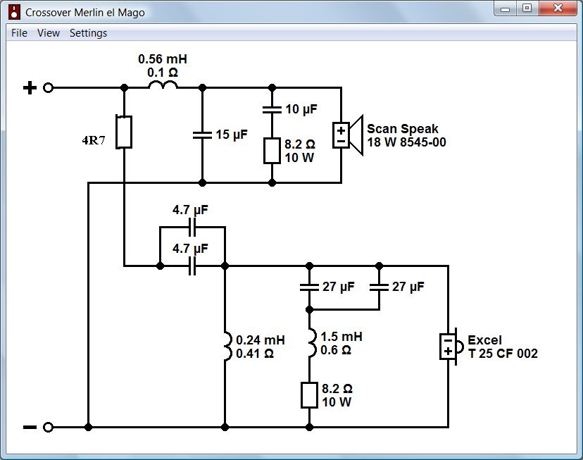

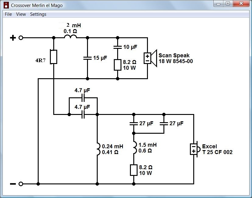

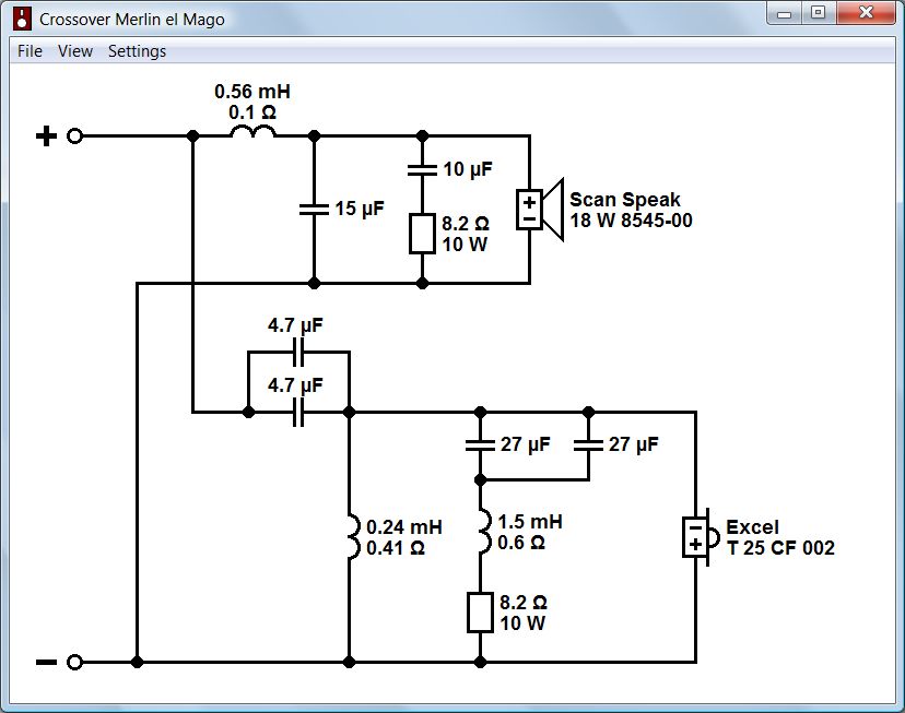

Hi Merlin,
I see you are making good progress with your crossover, great. Based on my simulation I propose some minor modifications you can try easily. Disconnect the zobel on the woofer, split the resistor of the tweeter and wire both drivers in phase. At least the simulation looks decent now and I hope the sound of your speaker doesn't tell the opposite.
Hi, The simulation has no particular problem. I can say if I think something good 😉

Hi Merlin,
Disconnected the Zobel on the woofer, again better sound, I have to order the components to change the tweeter's xover, thank you.
More resistance, more attenuation. You can work on both 2R2 and 3R3 components.How can attenuate more or less the tweeter, increasing or decreasing value or 2R2?
Using a 0.22mH inductor instead of a 0.24mH one will slightly change the rolloff - for the better or the worse I don't know. I suspect it is difficult to notice the difference. If you absolutely need the exact value buy a larger inductor and unwind. Some shop will do that for you.Also can I use 0.22mH in place of 0.24mH if yes have I to change something more?
