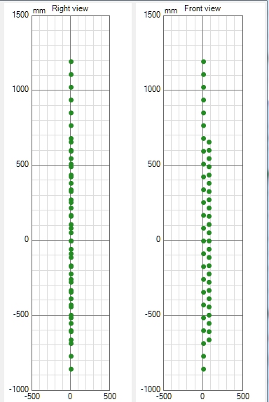

I'm sitting on a large stash of 40 x Peerless TC9FD18-08 and 40 x SB acoustics SB26STCN with the intent of building a large 2 way array inspired by the fullrange version many people have already built. The reasoning for the 2 way implementation of these drivers is trying to get a more dynamic and coherent HF response - I like the way the TC9 drivers sound up to about 8k, but the HF response past that isnt that great. The additional reasoning was having a tighter driver spacing thanks to the smaller diameter soft dome drivers to reduce combing. These little soft domes sound very good being they only cost me $26 each. I've used these in other projects and they sound alot like a higher end SB soft dome, so IMO they are a worthy choice for an array.
I planned on a 20 element array per side for both LF and HF sections using the tightest possible driver spacing. This means I may truncate the HF driver faceplates to get them spaced even tighter for the least amount of combing. The processing, EQ and crossover was initially going to be DSP, then active analog once the main EQ curve and crossover was established.

Thanmks again everyone for your answers and time. Yes, next step is simming for sure. Are there any other programs that can help with this other than vituix? I've seen spread sheets but some of them don't really help with specific things I'm after, plus they're not very user friendly. This is all why I ask questions ahead of time so people with experience can share their thoughts. These are the answers you won't get from sims or the like ie what drivers to use, what baffle shape is best, what supporting hardware, etc.
Well sure, but the effects of combing and the like become more of an issue which is exactly what I'm trying to reduce through less CTC spacing, making the line already shorter than optimal, plus you have to cross lower to compensate. I'm already close to the tweeter resonance, so thats an issue.the tweeters would have a smaller pitch, so won't you need more of them to match the height of the 20 TC9F's?
A very very quick and rough test of 25x tweeter + 25x TC9 doesn't make me all that confident of the tweeter size:
(take it for what it is, a job of a few minutes work to whip up the sim with a tweeter this size, not based on directivity
information of this particular tweeter but a simple model made with the diffraction tool)
That 55 mm C to C doesn't seem to be all that attractive. 25 mids and 25 tweeters, crossed at 1300 Hz, first order. No shading.
The lobes (horn shaped) do rise a bit in frequency, the top end is wider in the vertical directivity plot, but horizontal gets skewed (obviously)
due to the tweeter line being about 70 mm beside the mids. Tweeter can perform more uniform than this, I just used standard settings
with the diffraction tool without optimizing the baffle, but it does show a diffraction-less baffle design becomes important. More care is needed
for a good model, but certain trends will be visible, no doubt.
Driver spacing:
CTC: 55 mm between tweeters, 70 mm between tweeter/mid
Even though this isn't a definitive sim in any way, shape or form, it does tell me that it wouldn't be worth it to me unless you can go for a
near seamless tweeter spacing like you could get with a ribbon etc.
Lots can be done to improve this particular sim, but is it worth it with this big of a CTC spacing?

The number of tweeters does not determine the onset of combing, though less tweeters will have a more narrow vertical sweetspot and suffer a bit less.
Here's what it looks like with 15 tweeters:
Which is why I said to wait with decisions like that until after it is simmed (properly, not this quick whip-up)
Anyone with a bit of time on their hands, please, do a better job than me here 😉.

With a bit of work and driver level checks it can certainly look much better than my previous sim:
Even though lots more work would be needed to get a better understanding/working model.
However, the lobes will still be there due to the CTC distance used.
If one can influence it with a driver directivity change (using the blades) would be a fun test to find out...

Thanks for checking up on that. Looks somewhat promising. That was my suspicion but as you said the lobing is still a problem. The vertical directivity could be controlled but to what extent without ruining HF driver fidelity. Further down the rabbit hole...
I wonder if there is a way to sim 2 different horizontal driver angles with various crossover points to see what it does with reducing destructive phase interference. There must be an optimal angle at a given xover frequency in relation to the driver directivity, allowing one to hone in on it a bit. Does that make sense?
From my quick calculations, it appears 2 - 2.5k is the desired xover in the horizontal plane with given chassis dimensions and resulting driver spacing. This should reduce issues and place the off axis response dip in the Fletcher Munson "hole" so it doesn't sound weird power response wise. That is of course a relative issue, as it deviates from a desired flat FR.
Sure no reason not to, there are many available parameters to juggle to try and get the best compromise.I'm just going to keep an open mind and see if the sims present a possible exception to the theory I'm up against.
Certainly there is potential in those sort of ideas, I simulated a small lip on the TC9 for wesayso (further on in link I posted before) and it showed a generally positive effect@fluid Another thing I'm exploring is whether an acoustic lense setup can tame some of the combing and effects of overlap. By that I'm referring to a system of blades covered with thin foam or felt between the individual HF elements to reduce vertical dispersion and therefore HF overlap (sort of what a planar tweeter already does vertically). I used this sort of thing on a tweeter array many years ago and had good success with it. This was of course before computer sims were readily available. What are your thoughts on this idea?
