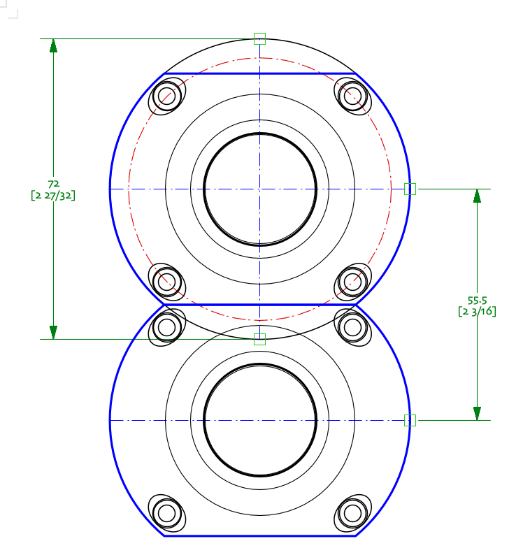

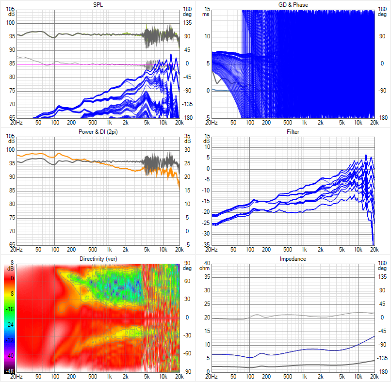

2 way TC9 array with SB26STCN
I remain EXTREMELY confident that regardless of your listening experience with individual tweeters, a twenty something line of the SBs you have can easily and confidently play crossed at 1.6 without even breaking a sweat. Anyways it’s a moot point as selection of network will be relatively easy compared to the actual build.…..you can select filters till your heart’s desire to find the perfect sweet spot
