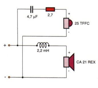

That schematic looks good, I'd omit the zobel on the tweeter (R1,C3), I don't think it's really necessary.
I can't comment on the component values, it's up to you to find a calculator/ formulas you trust.
...but 1kHz isn't too low? I mean the tweeter resonace frequncy is higher? And istn too big range for the tweeter from 1kHz to 22kHz ?
That tweeter cannot likely go that low. I don’t use domes so others will have more useful info on its specific use. Don’t worry about the top end, it is higher than you can hear (there are a few young “bat-ears” that can)/
Do you mean its good to cut it around 4kHz
No, i would be cuttin gthem 250-500 Hz but with a (much) different "tweeter”.
...but this is what I got...
OK, that answers that question from another poster. You have to workwith what you have, Chris & i were talking in a more general sense, which gives you a bit of what kind of compromises you will have to make.

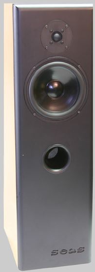

The SEAS Njord was about as simple as it gets:
This sort of 8" CA22RNX woofer and 1" 27TFFC tweeter:
So this will be the schematic, only left is to decide with all of you people what frequncy and value to set right ?
No, i would be cutting them 250-500 Hz but with a (much) different "tweeter”.
dave
Okey so I will know for the next time when choosing drivers, and what are you suggesting for my case? Because if I cut it around 500-1000Hz there left a gap of 1000-1500Hz that will be not played from the tweeter.

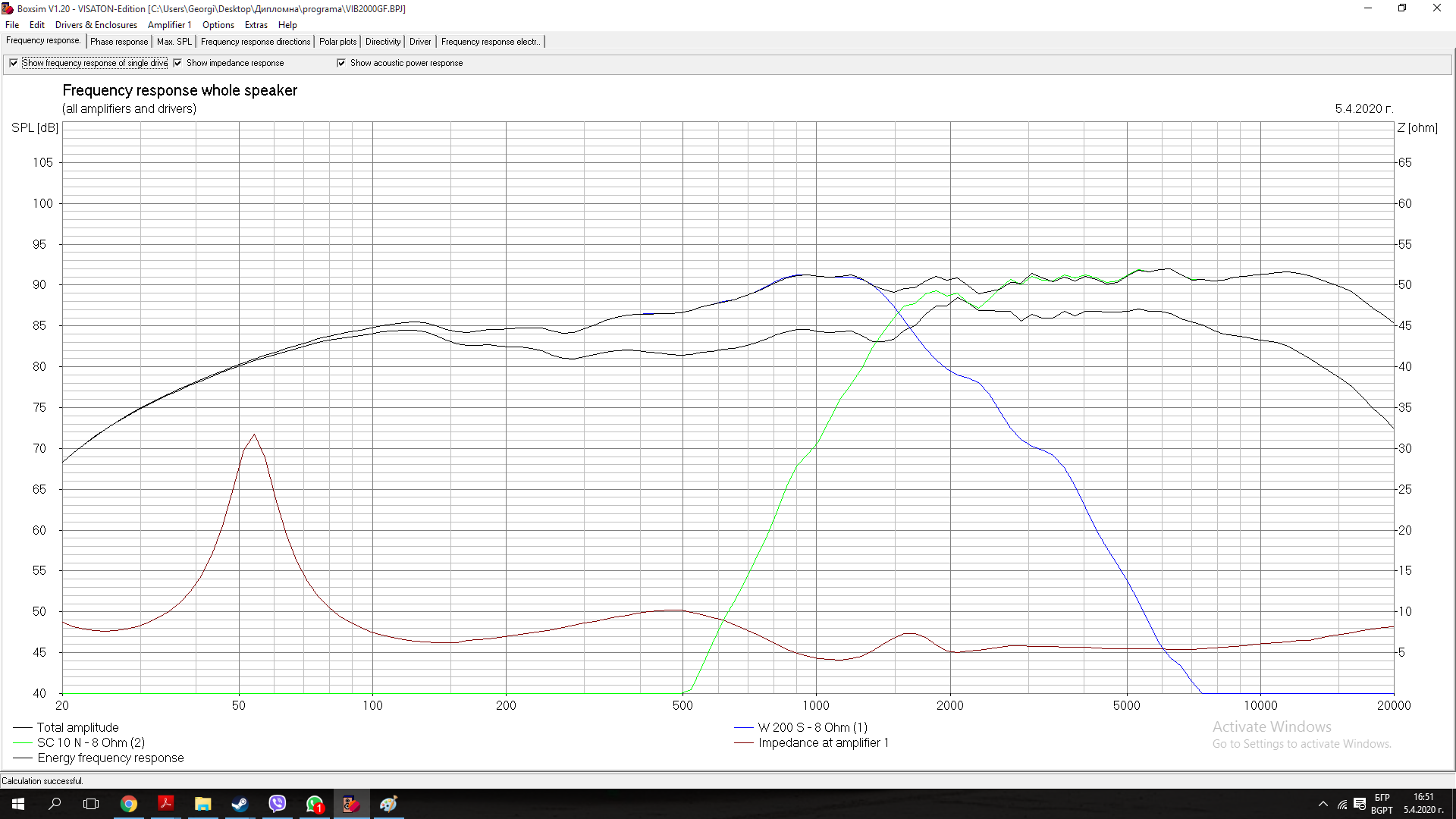

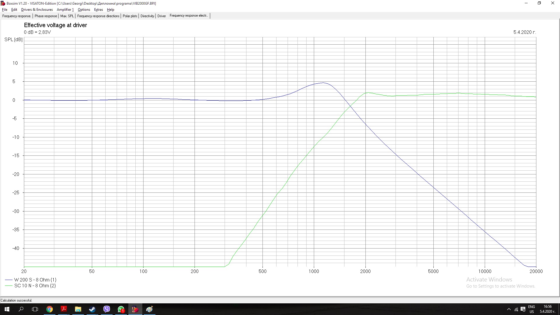

Okey so I use the W 200 S - 8 Ohm and SC 10 N - 8 Ohm in boxsim and I ended with this grpah. And theese values. I was aiming for the almost perfet straight line but... Is it good? Is the drop from the tweeter around 1.8kHz and 2.5kHz bad one? The crossover meant to cut around 2kHz?
So are these good or bad graph ?

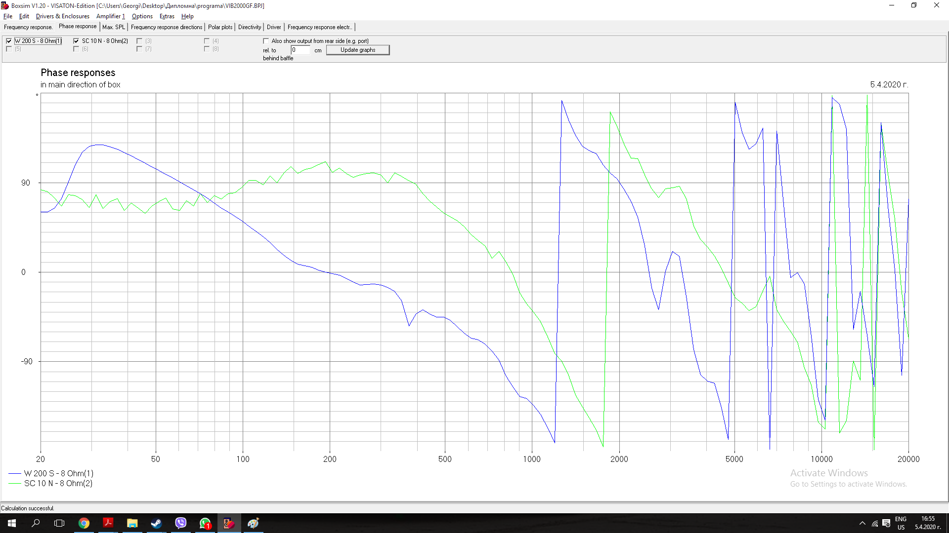

And are the phase response good ?

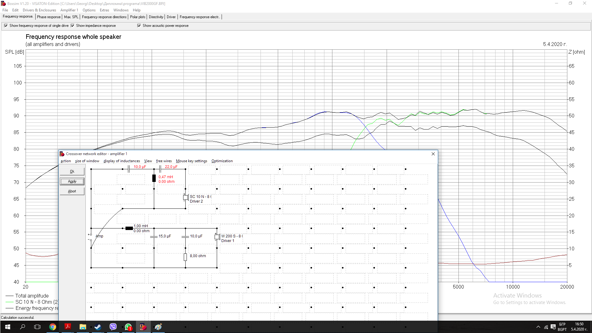

Try it my way to start:
You have just discovered how wrong online calcultors go with baffletep and tweeter level!
Mark some components in red and let the optimizer work it's magic. Like the 2.2R and most of the bass filter.
Phase is always a stinker with 8" bass. It has poor time-alignment.

Okey I will try it, but only 1sr order on the woofer isn't it a little ? Why not 2nd?
What optimizer, I have try it to put diffrent values till I like it , there is a auto calculating? 😀 What can i do to make the phase alignment good ?
And what is the purpose of the 2.2ohms resistor to the tweeter ? I see the tweeter has Zobel and 3rd order, for the 3rd order Okey, but how to calculate the Zobel when I dont have the parameters ?

The 2,2R tweeter resistor adjusts level. In reality, tweeters can be turned down a bit. Flat actually sounds a bit loud.
Trust me on this, Boxsim can calculate Zobels too. But I am about right here. And the3.3uF/0.2mH/10uf is just classic Celestion and KEF design. Why reinvent the wheel?

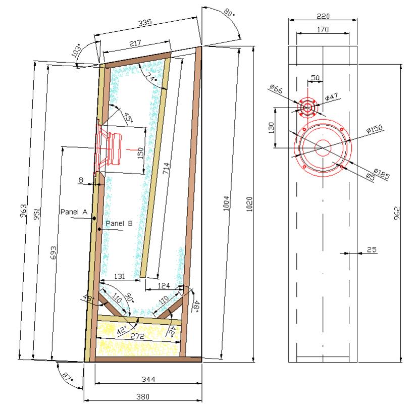

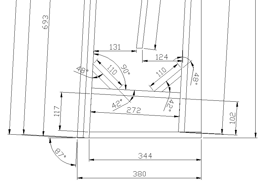

System7 that looks great, but the box is also important.
Lately I thinking of using transmission line. I draw a 38L transmission line box.The yellow in the botom is spake for sand maybe to control the low's. What do you think?

Did you model the line? If not we can say nothing much about the TL part.
The deflectors at the bottom will act as braces, but actually make the TL worse. Loose them.
