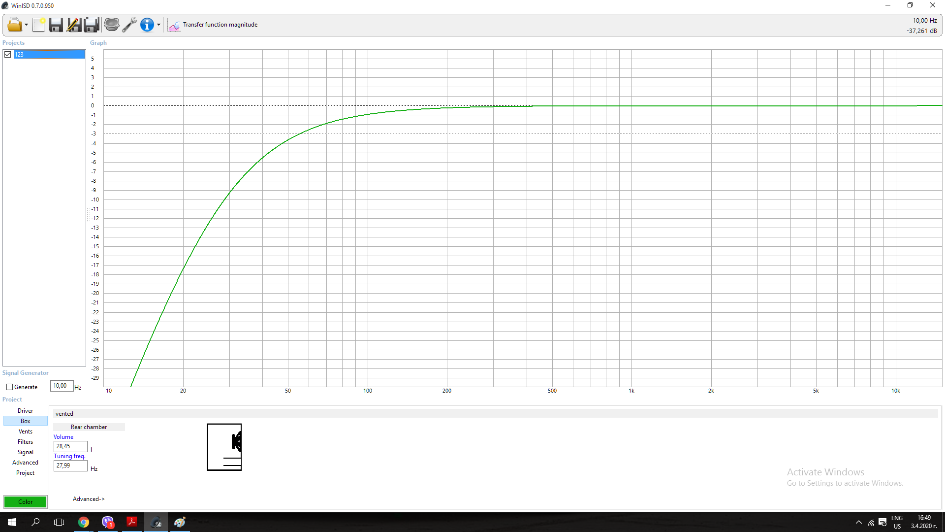

Hi, I am going to make a set of 2-way speakers. This is my second project, but this time i started from zero. So I choose these drivers:
1.Woofer: MONACOR: SPH-210
2. Tweeter: MONACOR: DT-107
So the box will be with volume around 30l, poted probabbly triangal ported in 25Hz.What is your opinion ?
And I am having hard times figuring out what crossover frequency to use, the tweeter says 3000Hz but I dont realy like it, what are your sugestions?

The LF driver has a peak around 3.5kHz, which I would want to avoid by using a lower crossover frequency. Remember: the graphs are course (10dB vertical scale) and likely have some smoothing. The peak may be worse in reality!
The dip around 1.7kHz is where I'm aim the crossover - there's already the beginnings of an acoustic slope there.
That said, if you have the drivers, go for it.

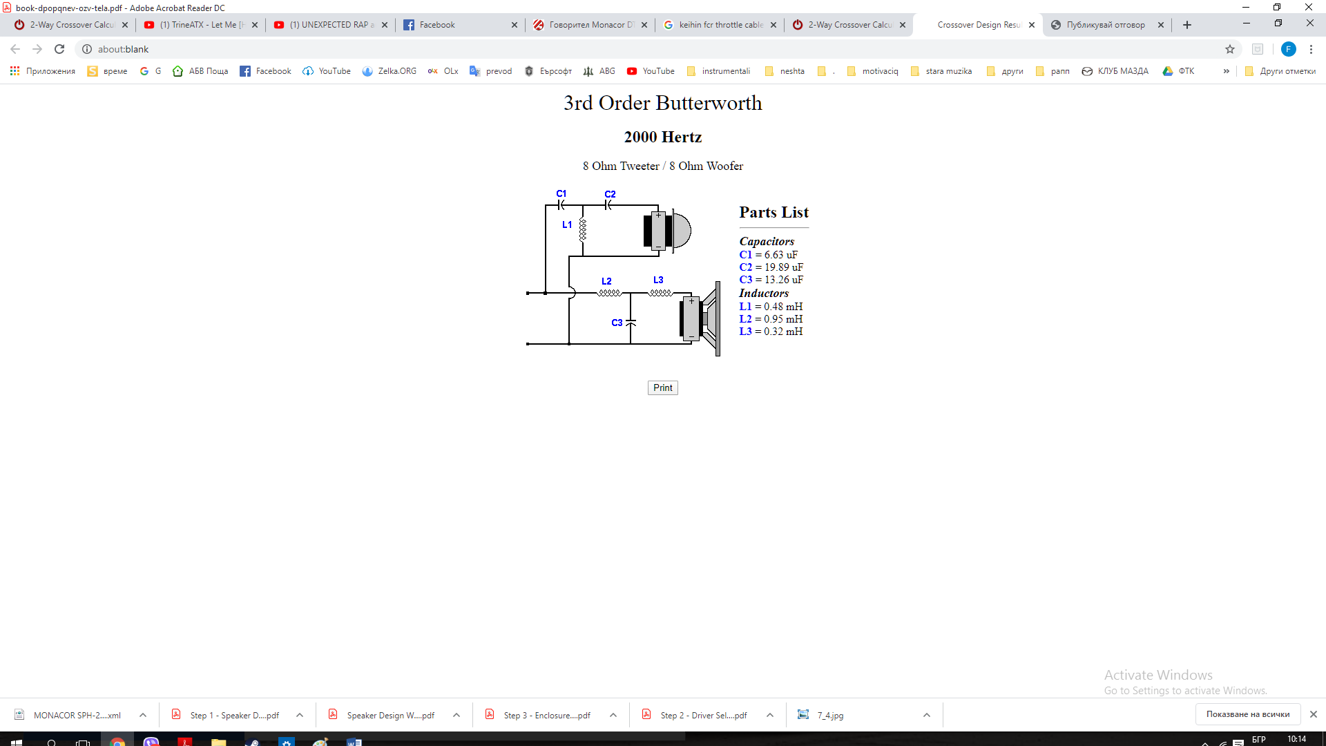

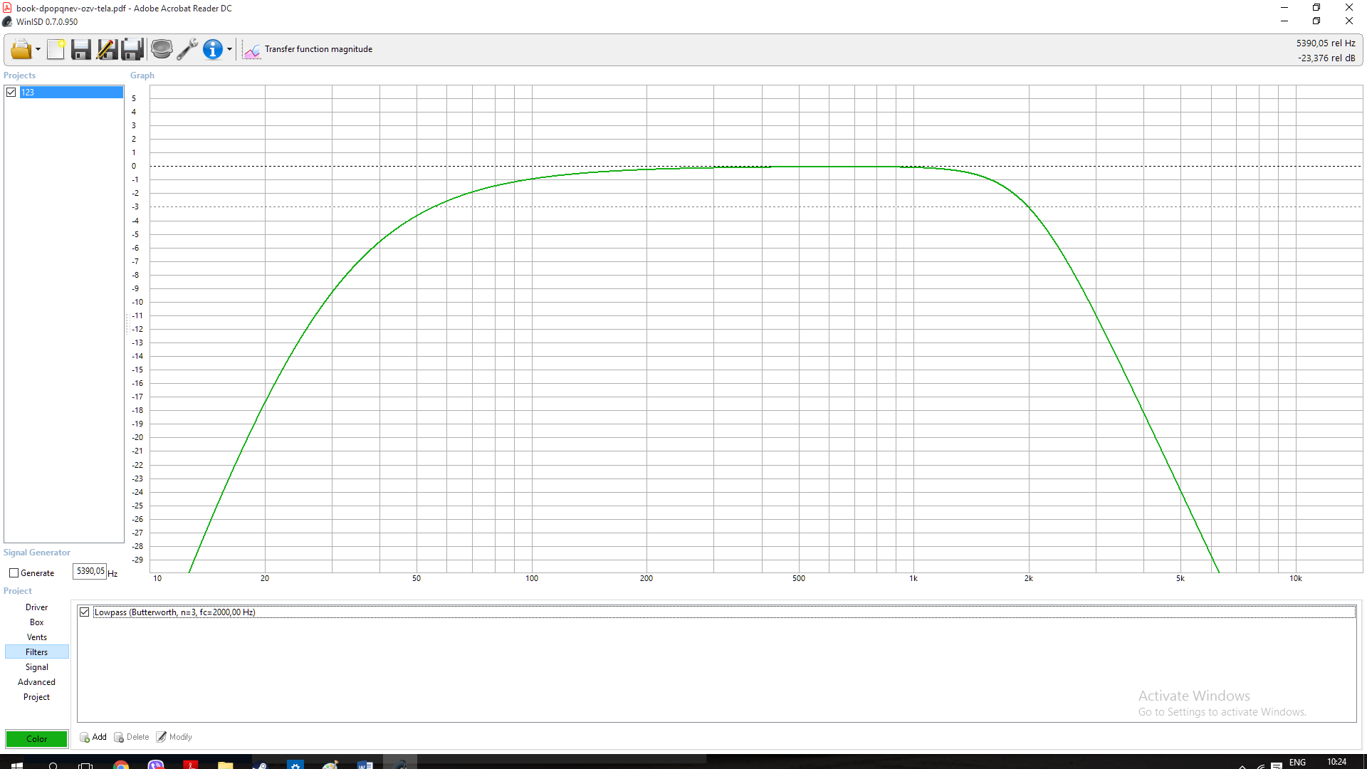

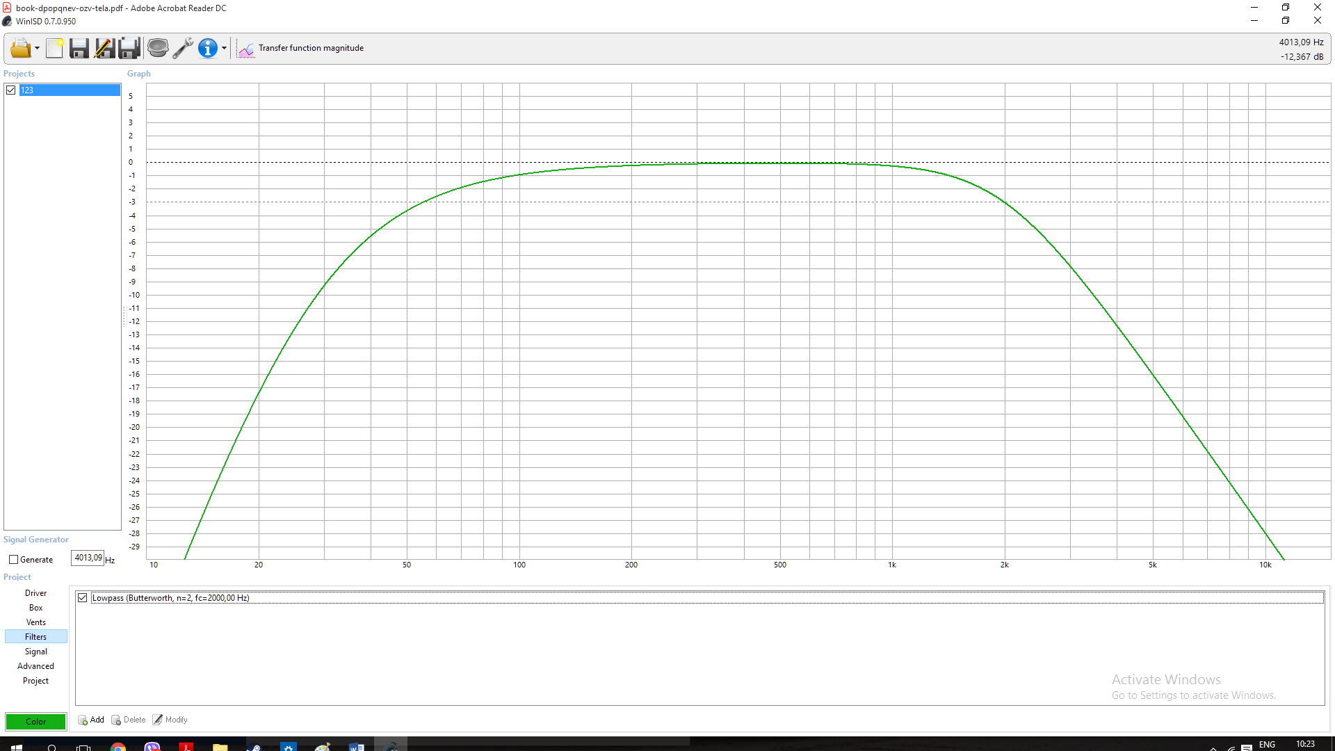

So when I make filter with the speaker in WinISD this is what happen: you see the graph is it good at 2nd order ?

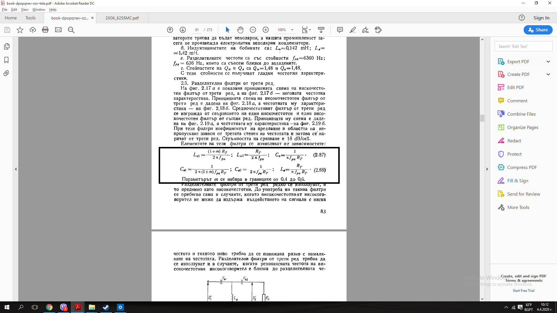

Also I have another question, when calculating the parameters to the crossover with this: 2-Way Crossover Calculator / Designer
I get the parameters shownt in the picture, but when I calculated with the book I have for building audio systems they came diffrent, I have check this calculator, with 2nd and 1st order its okey, but here I dont know.
Low cross:
L2 = 0.95 mH
L3 = 0.63 mH
C3 = 19.9 uF
High cross:
L1 = 0.159 mH
C1 = 6.63 uF
C2 = 9.95 uF
Which numbers are better, and why are there difference?
And one more quiestion, why 2nd on the woofer and 3rd on the tweeter, and not bouth 3rd ?
Greetings and big thanks to all you <3
'why 2nd on the woofer and 3rd on the tweeter" - this is an easy way to solve the acoustic alignment problem, if the tweeter is connected out of phase
'why are there difference' - because there is more than one way to calculate crossovers, and different calculators use different assumptions (or they get it wrong) - which is why you need to understand what's going on rather than simply plugging in numbers and accepting the result....
your numbers - you have assumed that both drivers are 8 ohms, that is not the case, driver impedance varies with frequency, look at the impedance plot on the manufacturers data sheet, if there is one. The Monacor plots aren't really detailed enough, perhaps you'll have to learn how to run impedance plots yourself.

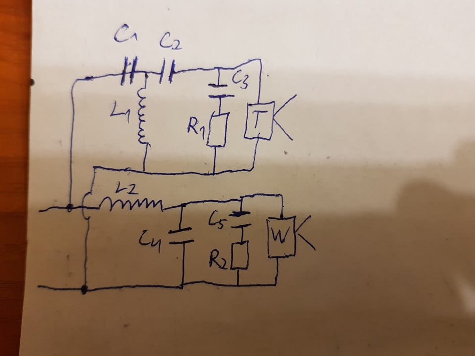

If you look at the SP210 graph in the link in your first post, the impedance at 2 KHz appears to be about 20 ohms, quite high. One way to deal with that is to use a Zobel network, & then you can calculate for 8 ohms (& you'll have a smaller, less expensive inductor). System7's second pic has a Zobel, the 8.2 ohm & 4.7uF cap in series on the woofer, and a similar one on the tweeter.
The Calculator page you linked above has a section on Zobels: Impedance Equalization (L-Pad) Circuit Designer / Calculator
The crossover calculators assume a flat impedance. By that I mean the same impedance across the frequency range. That is not the case. Impedance varies with frequency. The nominal impedance provided by a manufacturer (8 ohms, 4 ohms) is irrelevant when choosing crossover component values.
As pete said, at 2,000 Hz, you can see the impedance of the SP210 is 20 ohms... not the "nominal 8 ohms" listed in the spec sheet. A newbie would say "ok - I'll use 20 ohms in the calculator", but that doesn't take into account the tweeter impedance and doesn't take into account the changing impedance either side of the crossover point on the woofer.
On-line calculators are crude. At best, your speaker may work ok / make noise. At worst, they could cause a very low impedance and blow up your amplifier.

Оkey but when I dont know the Re and Le to the tweeter how to calculate what I need? So I need to make schematic like this in the picture I draw right ?
And If we go with the parameters that the calculator says we have:
C1 = 6.63 uF
C2 = 19.89 uF
C3 = ?
C4 = 7.03 uF
C5 = 15.15 uF
L1 = 0.48 mH
L2 = 0.9 mH
R1 = ?
R2 = 8.13 Ohms
Right ?
