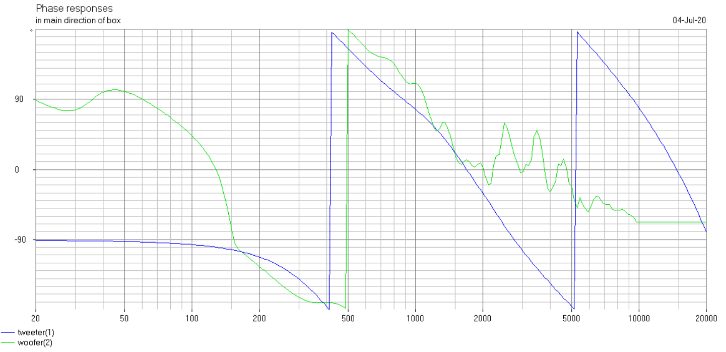

I'm building a budget 2 way speaker and I would have your opinion on where I am and if my crossover design is correct. I've simulated and built the cabinet, vented box, braced, measured with the UMIK-1 at 1 mt

FR simulated with BoxSim

3. the drivers are acoustically misaligned by 7mm: do I need to correct it?
4. Is the frequency response good, and how much I can trust BoxSim to buy expensive crossover parts?

I am not sure what kind of misalignment you are talking about. If it is horizontal alignment, the answer is No. If it is distance from the listener, the answer is more complicated.
Your boxsim simulation needs to take into account the difference in distance between the woofer and tweeter, and I can't tell from the FR plot if you have done so... I use Xsim, so I know nothing about boxsim. 7mm is not much considering your crossover frequency is 1500 Hz, so this may be nothing to worry about. Can you elaborate on the misalignment?

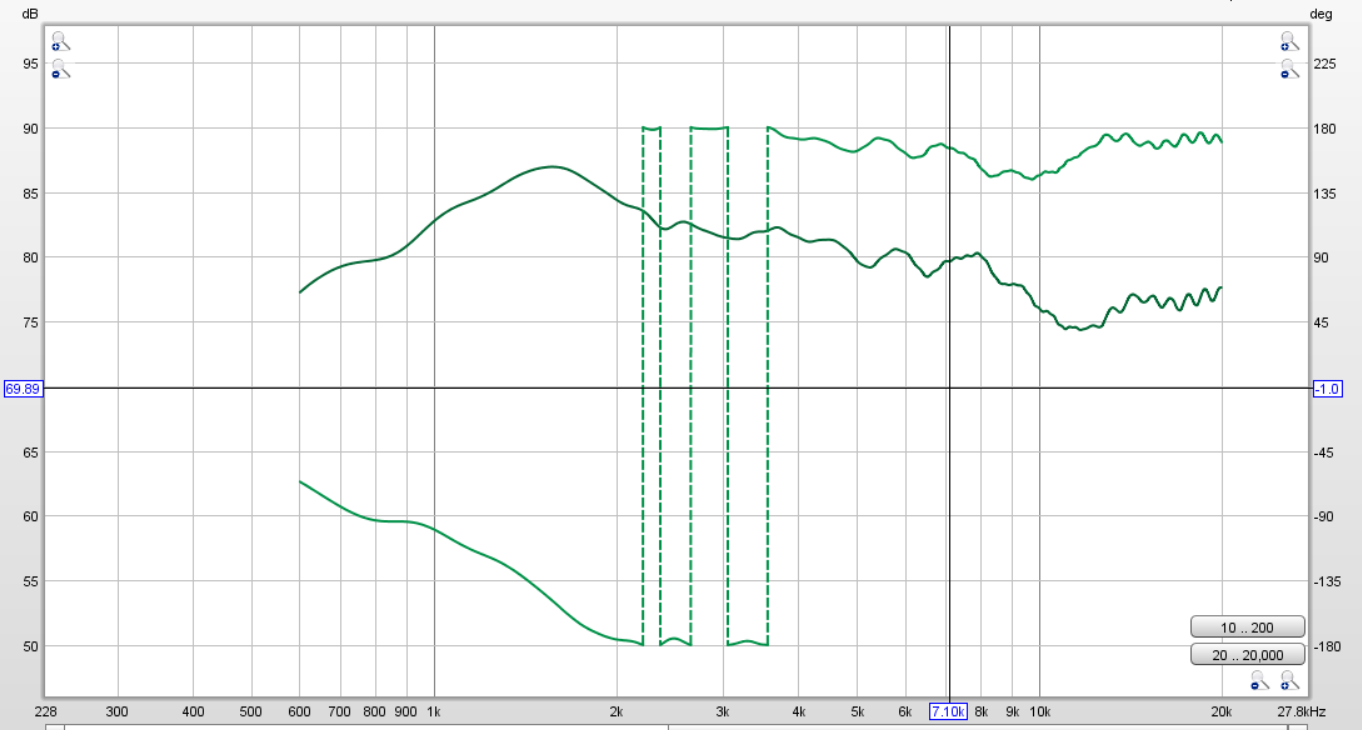

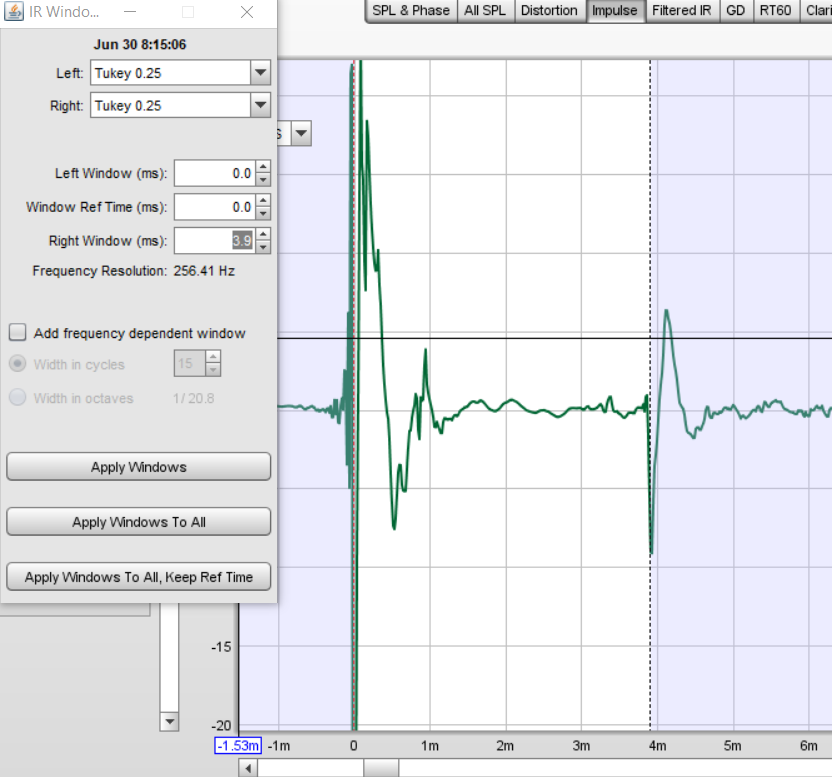

You need to do something equivalent to the attached PDF. If you have then all is good.

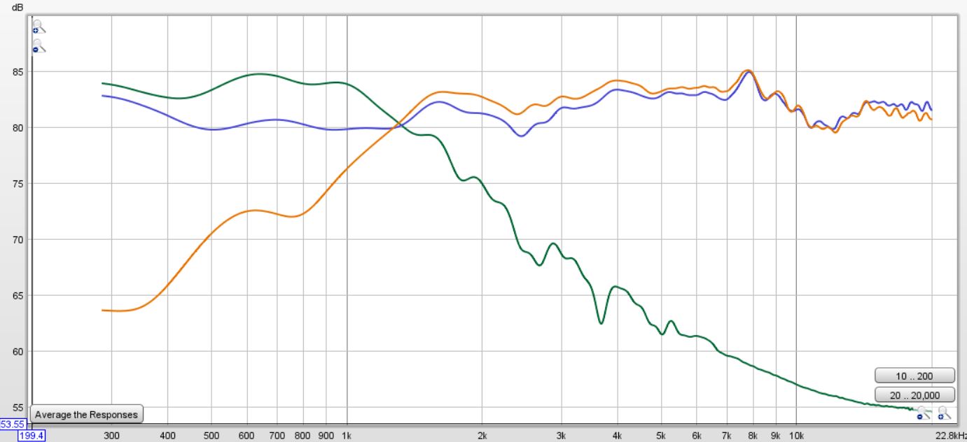

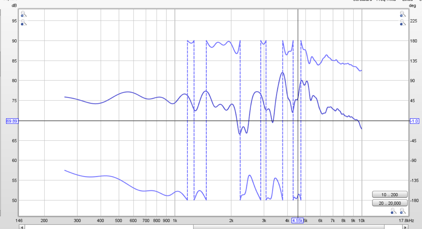

Yes, UMIK-1 for FR, measured with REW at 1mt outdoor with kind of far object reflection, Dayton V2 for the zma file, measured in box
gate value
Tweeter gated
Woofer gated
together gated
I measured the time delay with reference loop with REW, on axis, at tweeter centre, and the difference was 7mm: I think that the right definition is "acoustic centre", but I'm not sure; I use it for see if the drivers are time aligned. It's accurate because I move the mic by 1cm and it was reflected in the measurement
Assuming you have made good valid measurements, crossover simulations are pretty accurate.
I've attached the measurement and the technique that I used , I can share the REW files if you like to take a look

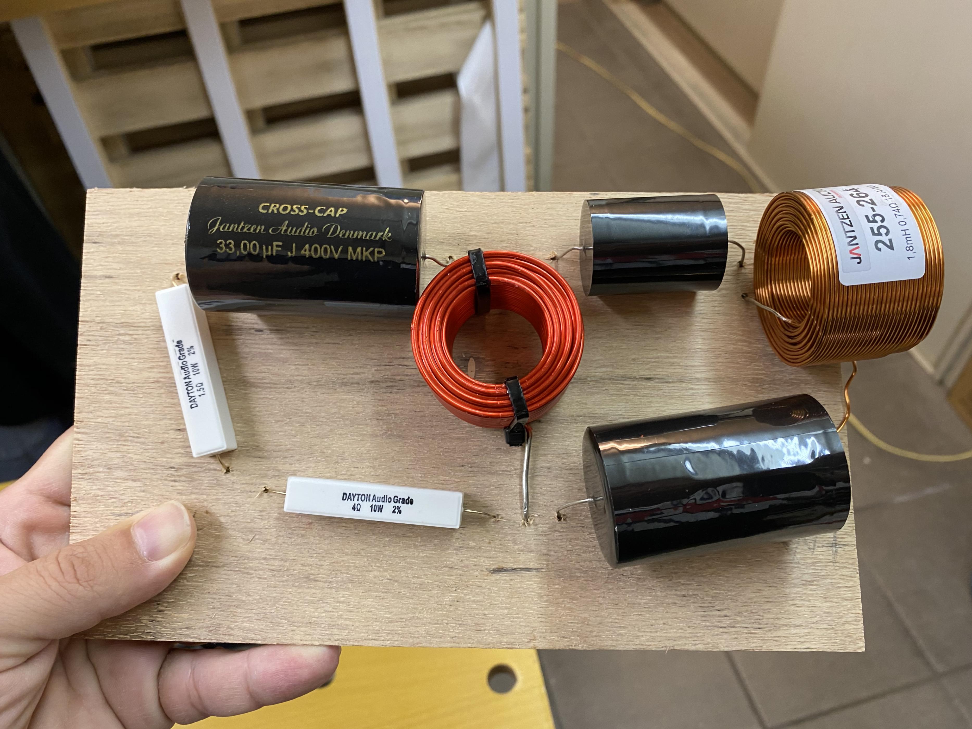

Dear Experts,
I need your kind review of the next steps in my project
Crossover layout
Could you please let me know if the components positions are correct and if I'm reducing the possibility of fire hazard (I read that the electrolytic may cause some time...)

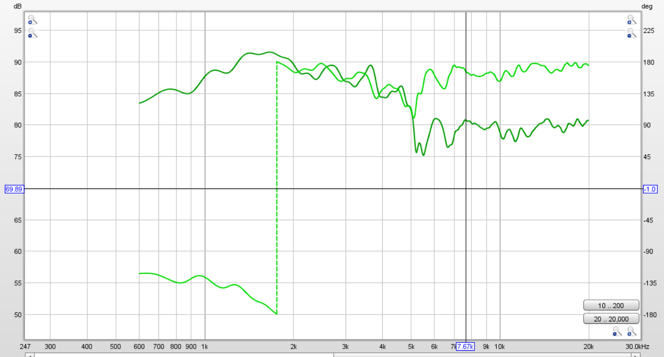

Final FR
Final frequency response, with driver response. No smoothing, gated at 3.5ms

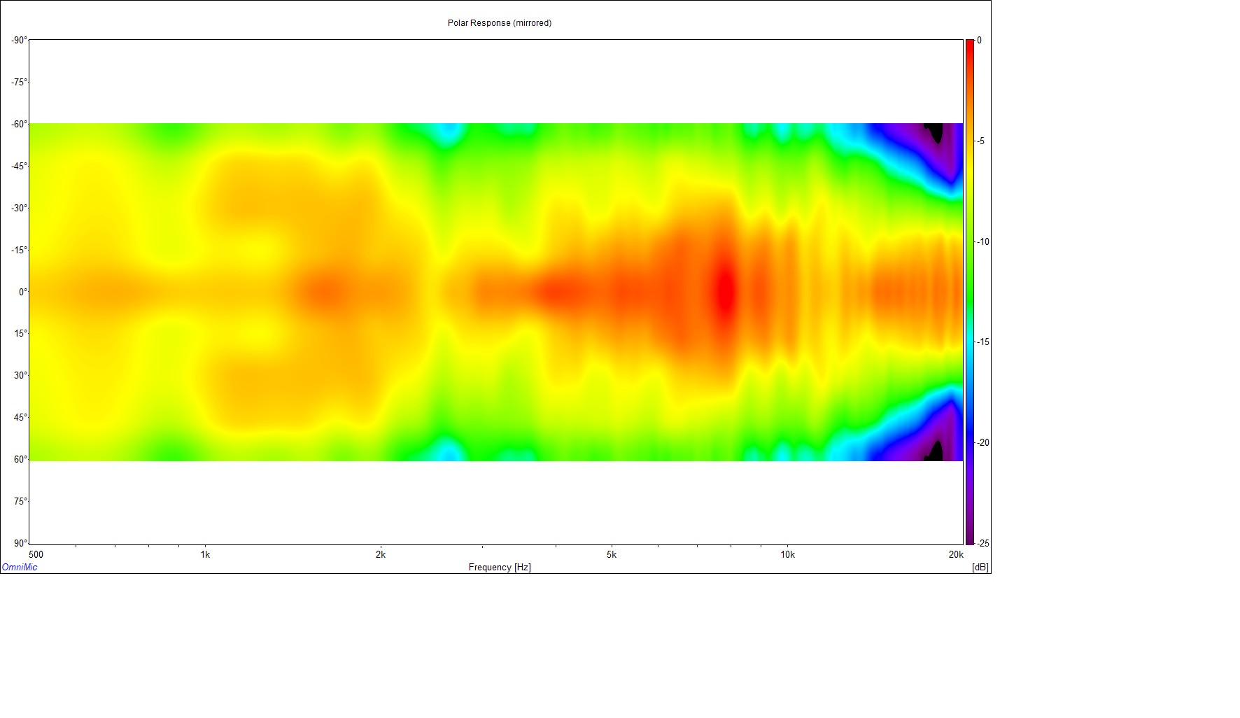

Polar response
Polar response, only vertical, I can't do horizontal
Do you think that I'm good to go? Any recommendation?
