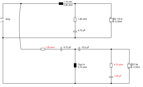

what I miss is more of the mids, but I already solved part I lowered the crossover point of the tweeter to 2kz. the crossover is 1st order a 2.2mh coil for the woofer and now 10uf for the tweeter
Sometimes if I have a 1st order LP on the woofer without out quite enough mids; I 1) put a resistor in parallel with the inductor to make the LP roll off less than 6 dB; and 2) try 2nd order but raise the frequency. Some larger woofers can go higher than 2 KHz but not many do it well. With option 2), you actually boost the mids but cut the treble sooner than a 1st order LP.
I just plugged in a random value in the crossover calculator; assume 8.0 Ohms, 2.2 mH the -3 dB would be about 580 Hz. If Z were 10 Ohms, F3 would be at 720 Hz; 12 Ohms, 870 Hz and so on. Do you have a good plot of the impedance curve?
For the same inductor, a BW2 would need a cap of just over 17 uF and give -3 dB at about 820 Hz. For BE2, the cap would be about 11.4 uF and give -3 dB at about 790 Hz and for LR2, the cap would be about 8.6 uF and give -3 dB at about 745 Hz. When I am unsure; I choose an inductor value that might work well at 1st order but also calculate for BE2. That way; I can try various values of capacitors above and below that closely approximate LR2, BE2 or BW2. I use cheaper budget type caps and coils until I get the desired results then upgrade to better quality caps and coils. Obviously, this is text book calculations and the real world is much more complicated, especially since most impedance curves rise with frequency and are rarely a nominal/constant value. Some drivers with very low inductance voice coils do have fairly flat impedance curves but that is not generally the norm. You can also do the same kinds of "tricks" on the tweeter high pass...1st vs 2nd order and LR2, BE2, BW2...

Little bit of crossover stuff that might help. SEAS Njord kit which must be about 3kHz crossover:
The SEAS tweeter is probably a dB louder than your Morel MDT 12. So adjust the resistor.
Another way to do things:
There is an issue with the hefty 1000Hz Fs of the tweeter which could be addressed with a, say, 33uF/0.7mH/2.2R Fs notch:

This is a better sort of circuit. 1st order bass with a bit of impedance correction:
The crossover is actually 3.5kHz:
KEF did this sort of thing in the similar Celeste III:

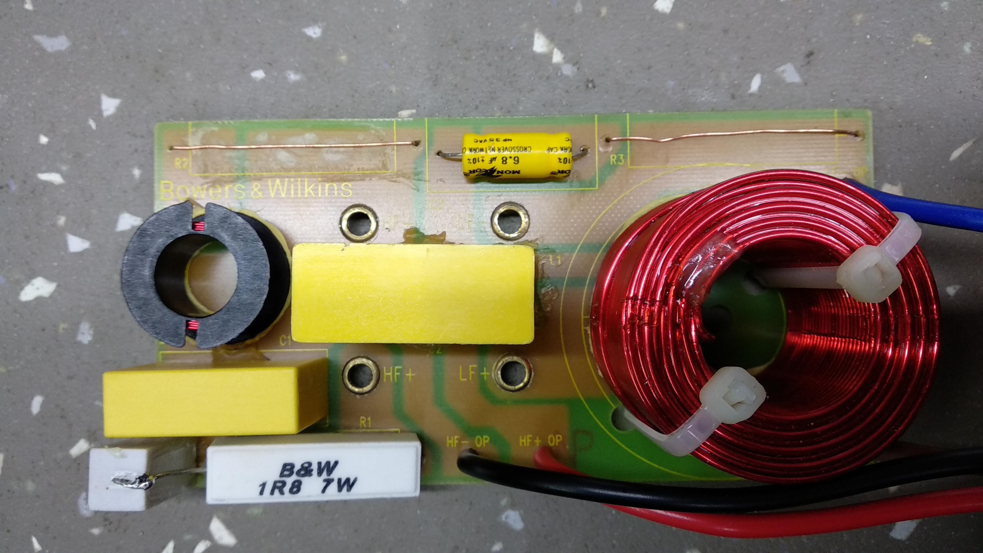

I have the B&W DM601 S3 crossover for parts and more components:
2 caps 10uf mundorf silver oil
2 caps 10uf Chinese
4 caps 2.2uf okt
2 caps 6.8uf monacor bipolar
2 caps 1.2uf 400v
2 caps 0.8uf 400v
2 coils 0.33mh
2 coils 0.19mh
2 coils 2.2mh.

Most of those are usable, and the circuit board, service manual here:
B&W Group North America Service & Support - Home
You will need a bigger, say 0.19mH coil on the tweeter because the B&W is a 4 ohm tweeter and maybe a bigger coil on the bass.
Notice it is negative polarity.
