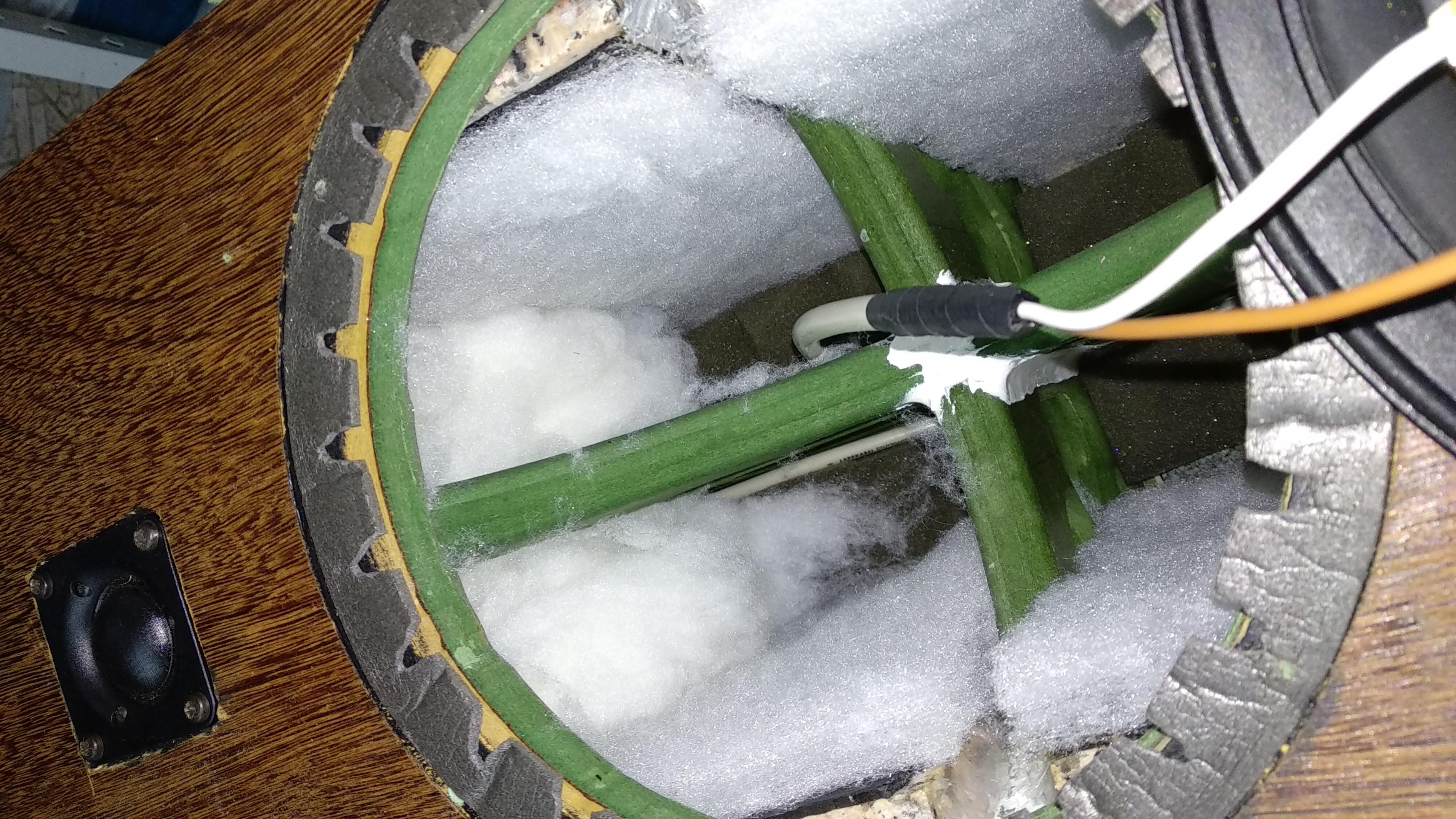

It is said that too much stuffing or fill can sound just as bad as not enough. Is it lower bass only, upper bass and mids only? Also, did you try a BSC circuit? Various values of resistors in parallel with the woofer inductor to adjust the "tilt" of the low pass roll off? If padding down the tweeter works and the tonal balance is good, maybe that was what was needed only? Lots of things to try; I am just now having my first coffee and haven't read through all the previous posts so I am unsure what has already been attempted and in what order. I'm sure others can offer suggestions here as well. Of course; you can always try to make accurate measurements but do so with the enclosures in their intended and final listening location. The room size and shape plus placement have a GREAT deal to do with the over all tonal balance, bass room gain, etc.

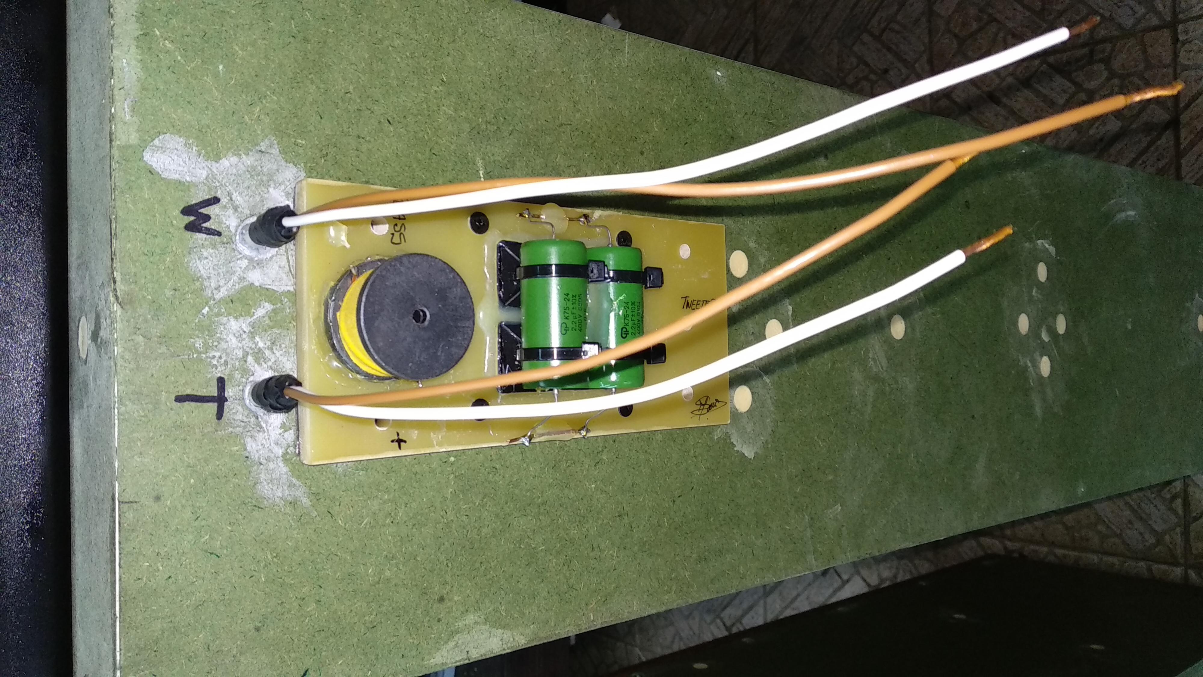

After several attempts and crossover orders I think I have reached a balance, at least in my ears. I don't know exactly what frequencies the crossover point is at, but it's nice, thanks for the help
