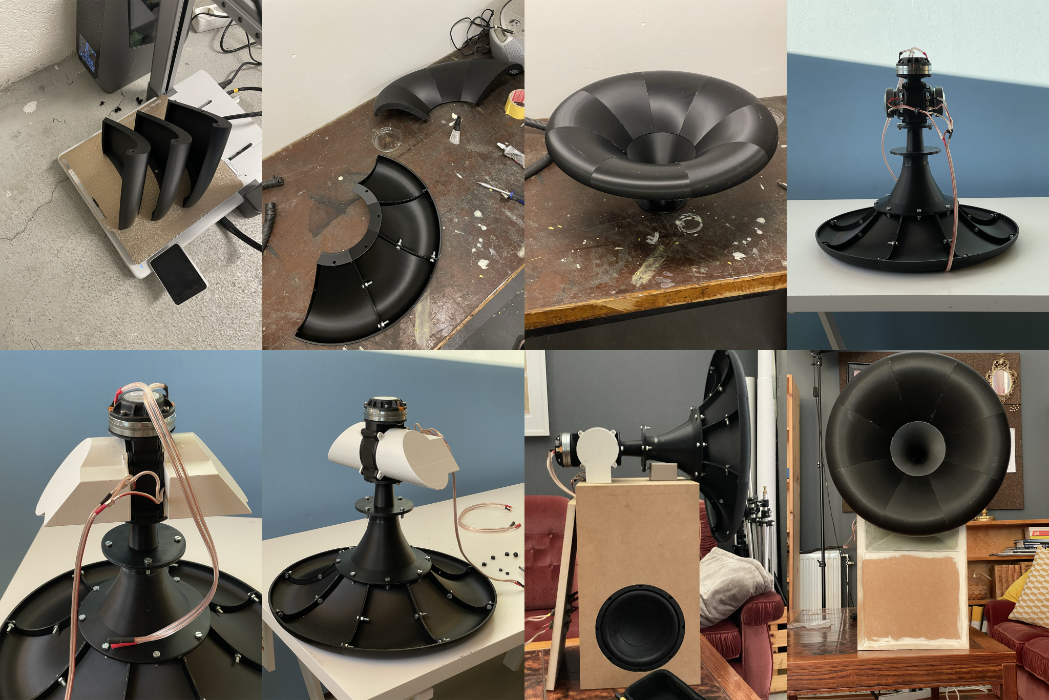

Updates on the throat adaptor experiments.
I made an R-OSSE waveguide in ATH and printed it in PLA using a 0.6 mm nozzle and 0.18 mm layer height. It resulted in a super smooth finish, the Bambulab A1 is such a good printer for the price. I was going to use a two-part epoxy to glue it together, but one part of the epoxy had hardened (probably too old), so I went with both superglue and contact glue. It’s probably not very strong, but it should work for this experiment.
The waveguide has a 1.4 mm entry with a 9.5 degree entry angle. I also designed an adaptor going from 1 inch to 1.4 inch with a 9.5 degree angle, it’s about 61 mm long. The throat adaptor with the mid entry point is 120 mm long, so the horn throat is 181 mm from the CD entry and 116 mm from the mid entry ports. It looks quite ridiculous, and I didn’t expect it to work very well. I used the mid rear chambers from the V1 MEH.
Here are the raw measurements:
A bit disappointing seeing the low extension of the mids but what can you expect with these small slits. However, the compression driver is performing well in this configuration, and it’s surprisingly flat. I did some rough EQ and brought the higher range of the mids down so I could cross them over at 150 Hz. Not ideal but it seems to work okayish. It would probably work better to use the mids between 600-1300hz, but my goal was to use them all the way down to 150hz.
Here is the response after EQ and crossover. There is a notch at around 310hz

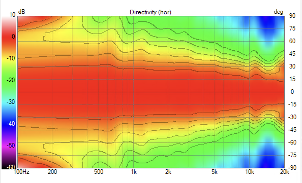

Directivity response (normalized). The CD is doing great, but the mids are rougher.
For the next version, I’d like to skip the 1-to-1.4 inch converter and make a new MEH throat adapter that goes from 1 inch to 1.4 inch. The adapter's exit angle would match the throats entry of 9.5 degrees.
I’m also trying to figure out what changes would improve the mid tap ports. They definitely need to be bigger, and moving them closer to the horn throat should help to increase the low end.
The slit is currently 44 mm to 84 mm away from the compression driver. That corresponds to half a wavelength of 3897 Hz to 2041 Hz. This somewhat aligns with the notches in the response. Interestingly, the response around 3 kHz, right between those two notches looks good. Could I make the slit more gradual, shaped like an eye or a teardrop, to reduce harsh reflections? The edges of the slit aren’t rounded either, smoothing them out might improve the response.
If I move the mid ports further from the compression driver’s entry, I could likely shift the notch lower. Ideally, they should align with the crossover point. I assume they’d need to be half a wavelength from the CD entry to create a cancellation notch. So, for a crossover at 1300 Hz, the distance would need to be about 13.19 cm. But that would break Danley’s ¼-wavelength rule between the mid and the CD.
In the first throat adapter test, the CD’s response was my main concern and the mids looked pretty decent, considering they were open-back. Now the mids are worse. Is the distance from the horn throat the culprit? Given all this, I think placing the mid entry ports as close to the throat as possible is probably best. Maybe even on the horn walls? But then I’m back to square one. No… I’ll keep exploring this idea of putting the mid ports on the throat adapter.
I’ve been listening to it while writing this. The high frequencies are beautiful, smoother than on my previous MEHs, less metallic, which is great. The mids, though, are a bit muffled, not so great.
Anyway, I’m off on holiday now, so the exploration will continue in about two weeks.

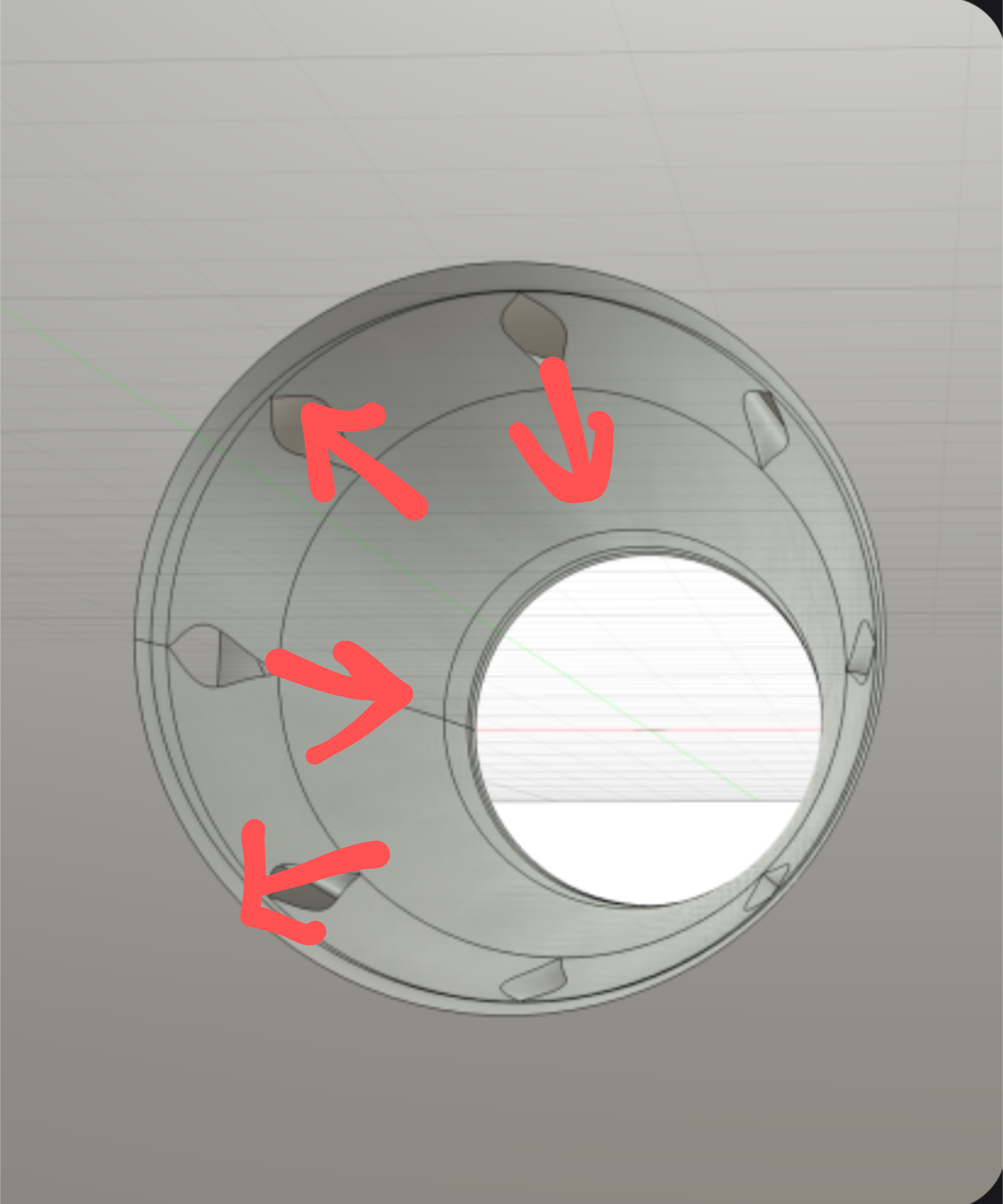

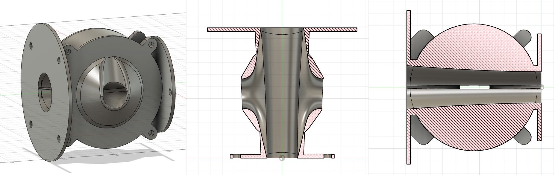

Here’s what I’m working on for the MEH throat adaptor V2.
For this design I’m aiming for:
Increased front chamber volume
Larger ports
Eight ports instead of two larger ones. I would assume it has less impact on the compression driver’s response.
Lower crossover, so the ports can be further away from the CD. I’m planning to cross over around 900 Hz, so the middle of the ports is about ¼ wavelength from the CD entry at that frequency.
I’m thinking about combining the front chambers. I'm aware there’s a chance the mids could cancel each other out at higher frequencies, but I don't think they would affect each other at the intended crossover frequency.
Here’s a rough sketch. Still need to add details like mounting holes etc:
Larger ports

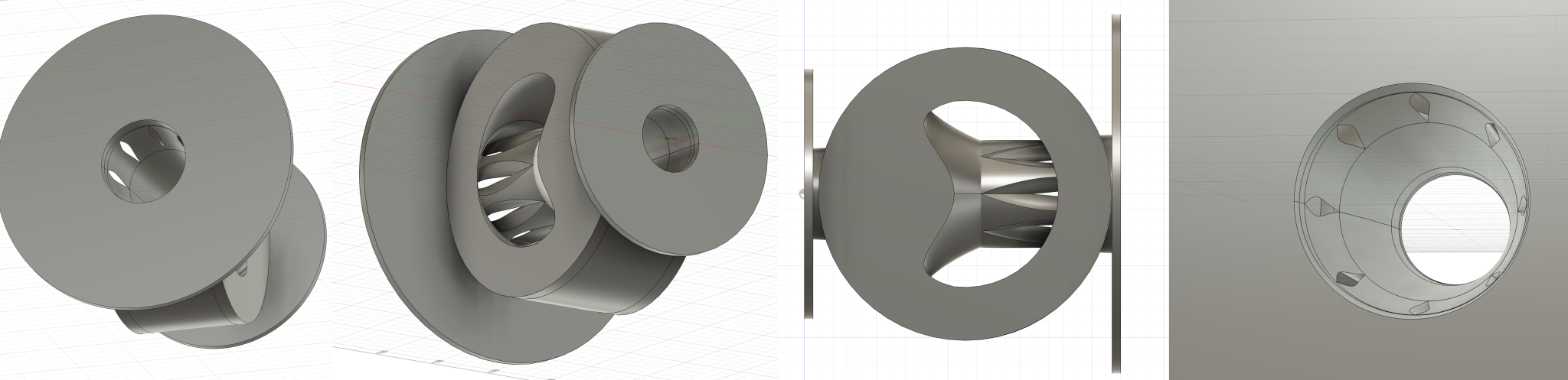

MEH throat adaptor V2 has been tested… aaand it was a disappointment. Some serious dips in the HF response.
My theory is that the mids’ front chamber / compression chamber affects the CD’s response a lot. With the previous throat adapter, there was a big difference in the response depending on whether the mids were shorted or not. I didn’t manage to save a graph of the CD’s response with the mids open, but here is the opposite: a response from the mids with the CD shorted and not shorted.
With a larger compression chamber, the driver doesn’t have the same control of the air as with a smaller one. So there’s barely any difference in the CD’s response whether the mids are shorted or not. Here’s a graph with the mids shorted and not shorted, as well as the CD alone on the horn without any mid ports, to see what I’m aiming for.
For the next version, I’d like to make the chamber as smaller. I’ll also close it, so it no longer has the opening between the mid drivers. Here’s a Hornresp sim of the mids. Making the mid chamber smaller doesn’t seem to affect the low response much at all. The grey line shows what I expected with this design. The red line shows how it will look if I make the mid chamber smaller.
Anyways here are some pictures of the design:

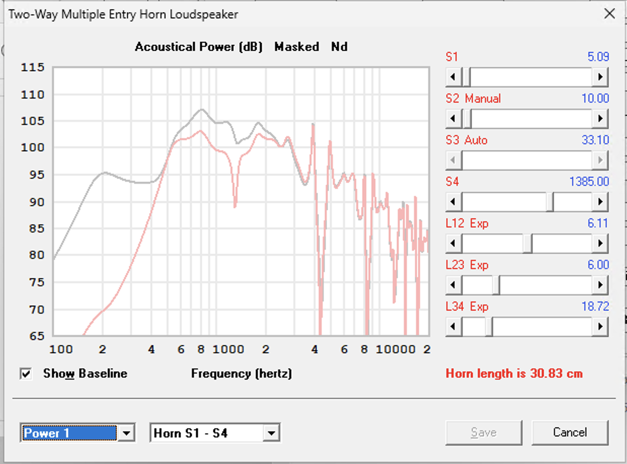

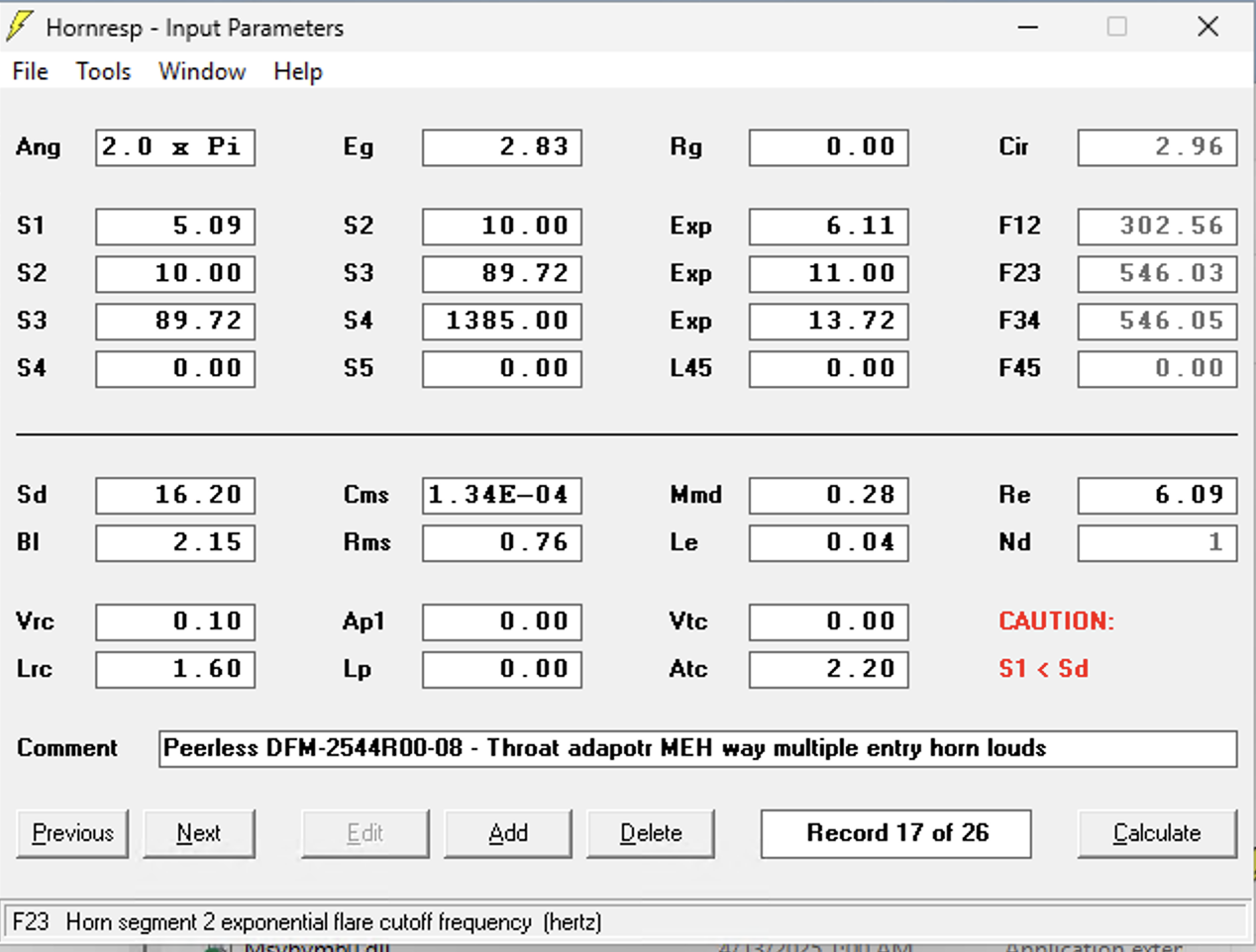

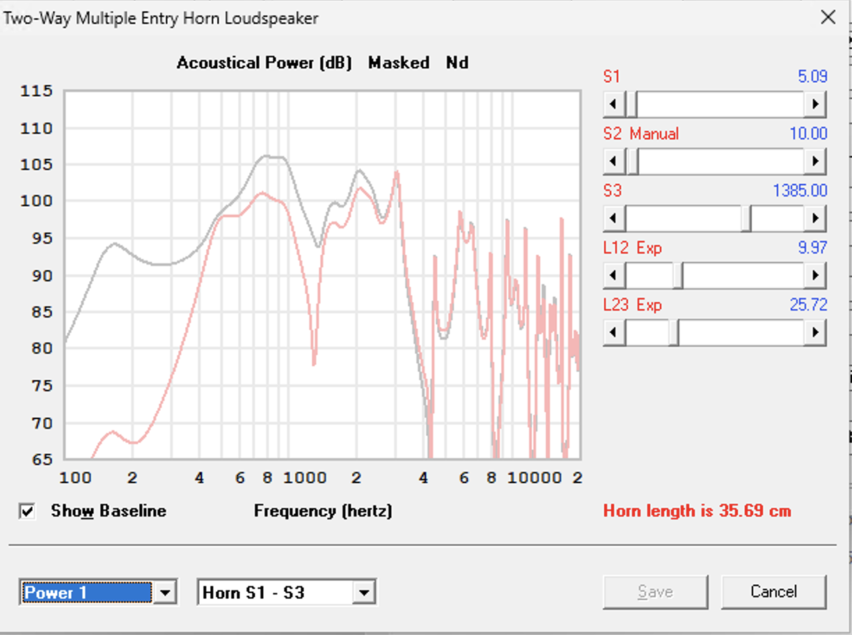

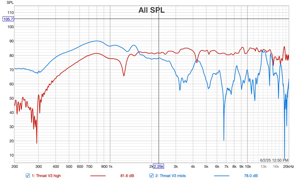

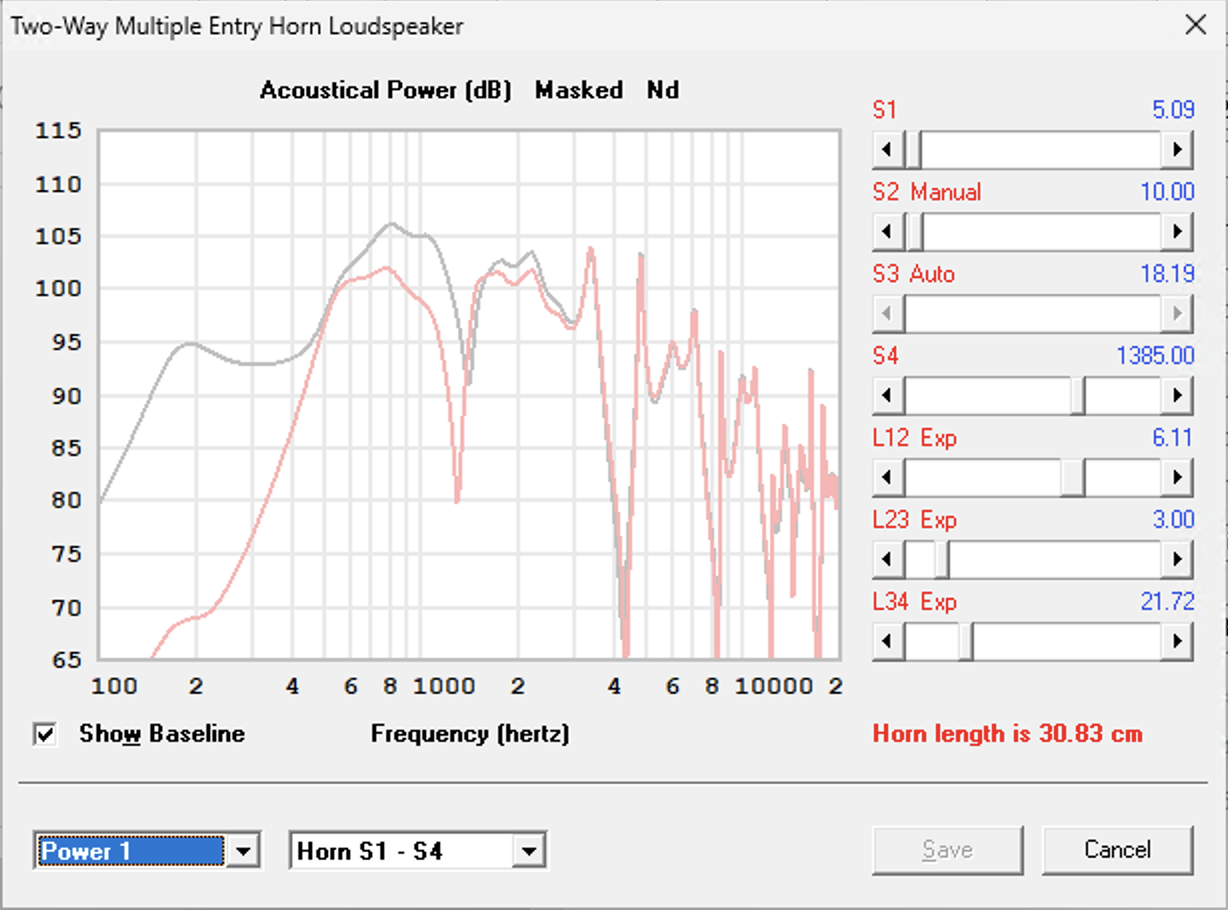

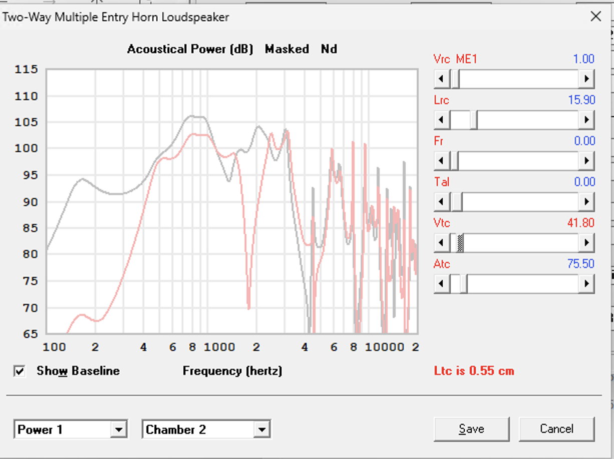

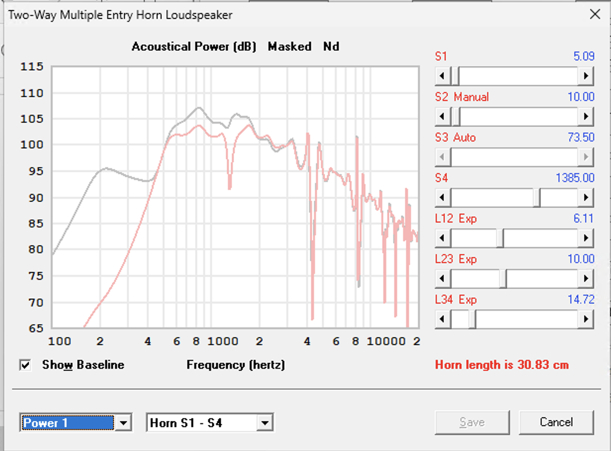

Thanks for the excellent input everyone! I’ve given it some thought and done some research, which leads me to think I’ll abandon the idea of the MEH throat adapter and instead place the ports further out on the horn. If I were to continue placing the ports in the throat, I could probably get a better result by staggering them, but my guess is they’d still affect the CD’s response more than I’d like.
I figured out that even though Hornresp isn’t the best tool to estimate the CD’s response, it can still show the effects the mid ports have on the CD.
Here’s the CD response on the horn without any mid ports, nice and smooth.

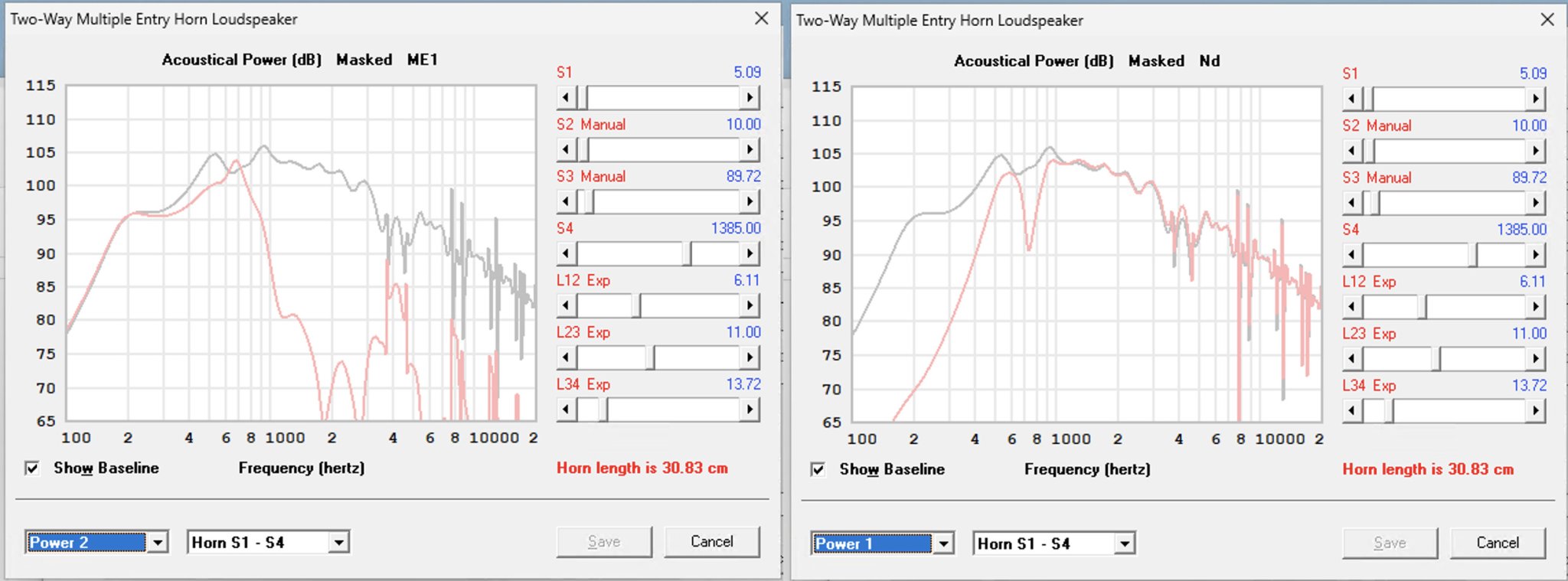

Here is the CDs response with a design similar to the last mid port throat adapter I printed. I haven't calculated the exact front chamber volume and port lengths and sizes, but it's close enough to see similarities to the real life measurements.
My theory was that I could minimize the dips by making the front chamber smaller, but when I do that, it only shifts the dips higher in frequency.

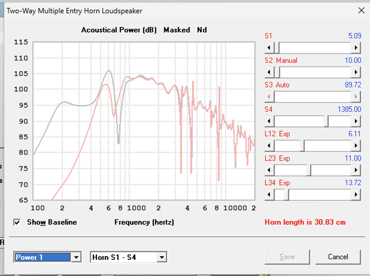

So I’ll have to think of another solution. I played around with Hornresp to see what effect placing the ports further out would have on the response. The dips become narrower and less severe when the entry ports are moved further out.
Usually, the real life response is smoother and the dips shallower than the Hornresp simulation, so I’d assume a CD response like the one above would work pretty well. But in that case, the mid ports are more than 16 cm away from the CD, far from the 1/4 wavelength rule between mids and CD. I’m thinking it might be okay to be flexible with the distance between the CD and mids, but keep the distance between the mid ports at 1/4 wavelength. A 1/4 wavelength at 800 Hz is 10.71 cm, which gives a circular area of 90.088 cm². That would translate into a horn with these parameters. The mids are just under 1/4 wavelength of 800 Hz apart from each other, and the distance between the mids and the CD entry is 17.11 cm.
It results in a much better response for the CD, with some narrow dips which I think will smoothen out in real life.
I was also curious to see if the mids’ polarity, amplification, or delay would change the CD’s response, but changing these parameters in Hornresp didn’t have any effect on the CD at all. However, changing the mid front chamber does have a big effect, making it smaller moves the CD’s dips up in frequency, so reducing its size actually worsens the CD’s response bringing . With this horn and XO frequency, I found that a mid chamber around 300 cc gave the best result with the highest dip around the XO frequency. After reversing the polarity of the mids, they are in phase with the high frequencies, so the combined response looks good. Here are the mid and CD responses, with the total response in grey:
To sum it up, what have I learned from these experiments?
When I started with the mid throat adapter idea, my hope was that by tapping the mids into the throat, I could combine the response of the CD and mids at the throat and have it exit the horn as a unified sound with excellent polars. Tapping in on the sides of the horn seems to negatively affect the polars, resulting in, for example, dips in the off-axis response.
I still think it’s somewhat possible, but it has its limitations. V1 of the mid port throat adapter looked promising and could probably work with the mids crossed between, say, 400–1600 Hz, and the CD from 1600 Hz and up. That could result in a horn that I think could play pretty loud at those frequencies, so it would be the budget DIY alternative to the coaxial drivers like the B&C DCX464.
I wanted to go lower with the mids, and now I’m not sure if it’s realistic to expect a 1.4-inch throat to perform well down to 150 Hz. From the Hornresp tests in this post, I think it’s a much better idea to tap the mids into the walls of the horn—but then I’m basically back at square one, with a horn that has worse off-axis response than one without any holes in it. I guess there are always compromises and no best of both worlds solution available.

Well, I haven’t given up yet and made a throat adapter similar to V1, but with a larger opening slot that stretches from the CD’s entry to the throat adapter’s mouth. Thinking back, I realize it’s probably unnecessary to extend the slit that close to the CD, as it might affect the high-frequency response.
I wanted to try it out one more time, just to see if a design like this could be a budget alternative to coaxial drivers like the DCX464. Because of the high XO it could be used with a cheaper compression driver than the HF108 I'm using. Something like Peerless DFM-2535R00-08 (which can also be used much lower on a horn like this with a throat adaptor) paired up with cheap 3 or 4 inch mids.
Here are the measurements, much better CD response than V2. There’s a notch around 3300 Hz, but overall I think it looks pretty good. A long slot might be the way to go. The mids are crossed over at 400 Hz and 1300 Hz, so that notch at 1300 Hz worked out great.
And the polars, ignore everything below 400hz.
Nice results!
For comparison sake, the DCX464 is 150mm dia and about 78mm tall. If you take 4 or more, 2 inch drivers (58mm faceplate width, 35mm deep) arround the adapter it could be more DCX464 like in size. Also, with a more compact layout, you could have shorter port lengths which provide the possibility of higher xo frequency.I wanted to try it out one more time, just to see if a design like this could be a budget alternative to coaxial drivers like the DCX464
Nice work with the slots! That's very innovative. Just a thought, have you tried filling the port holes with small amount of polyfil? Just a pinch, like cotton ball size. I use this trick to lower the resonances in the mid ports. It might lower that notch you have a 4.2k and allow you to use a lower crossover slope on your midranges.
