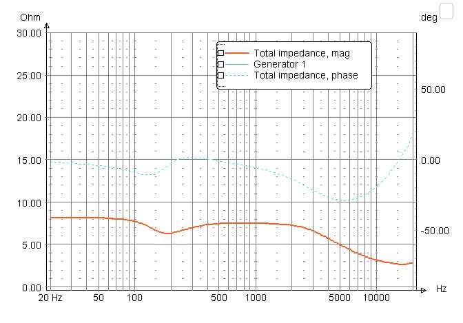

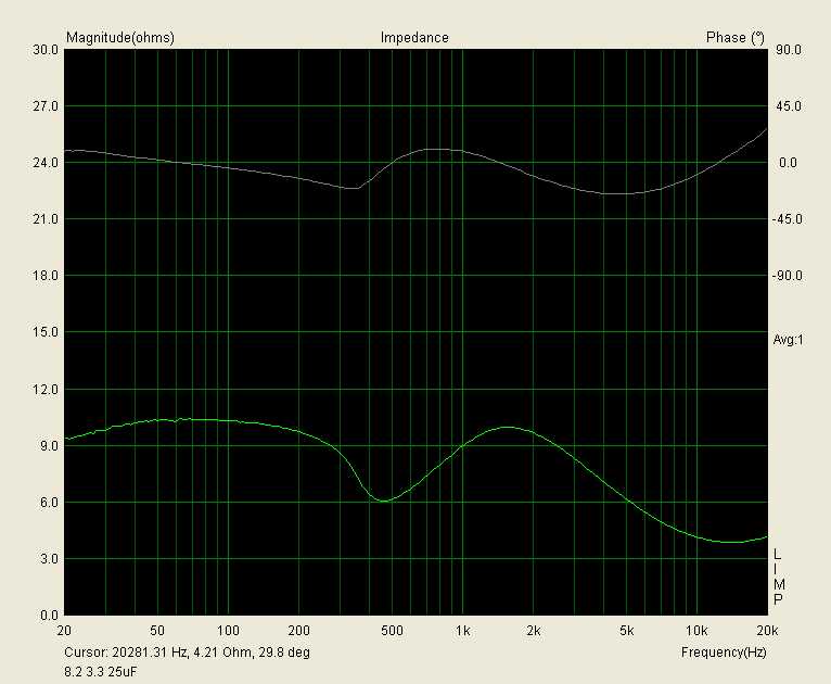

Yep, but it seems to work now. The CAD is plotting about same sort of impedance curves that I'm able to measure. OR IS IT working? What makes the difference in the frequency where it drops 400Hz(meas.) vs. 200Hz(calc.)?

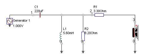

The measurement and the simulation below were made with an 8.2 Ohm parallel and a 3.3 Ohm series resistor + a 25uF series capacitor. On left is the measurement and on right the cad simulation.
If I would like to use a bigger series capacitor to make the notch doable would that be a right guess?

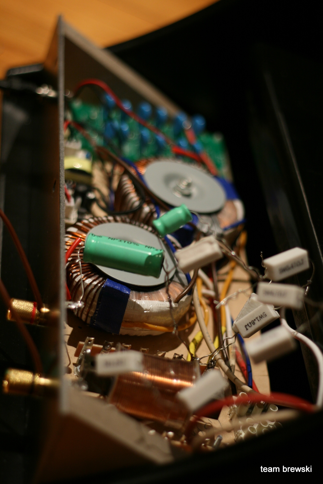

Here's the situation after a couple of days of the tweaking. I got the highs working OK when I lowered transformer ratio and used a bigger series resistor. I don't need to use any equalising on the PC for the highs any more and the over bright sound is gone. Attached a picture of the Xover at it's current stage, it's not ideal, made from the bits and pieces I found lying around.
I still need to use Winamps EQ between 1kHz to 125Hz. Got that sorted too with the xover, but only when I used higher xover freqs.
Unfortunately I have only a single subwoofer at the moment and I'm forced to use low xover frequency (with high xover >60Hz I can't listen the speakers at all
). Now I have a weak bass between ~150-70, but I can live with that (for a moment or a couple of years).
"ping Calvin"-thread has been a great help, much appreciated...

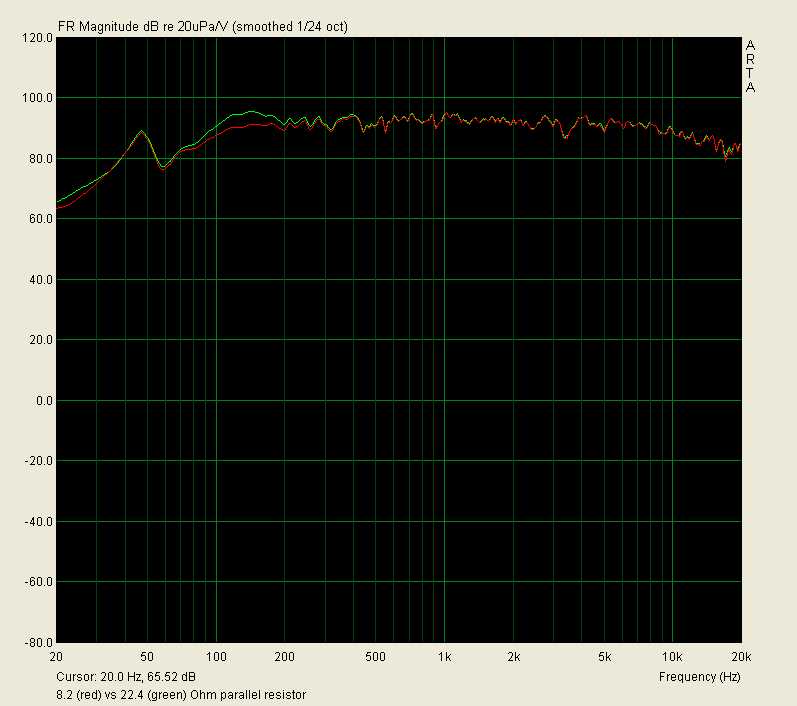

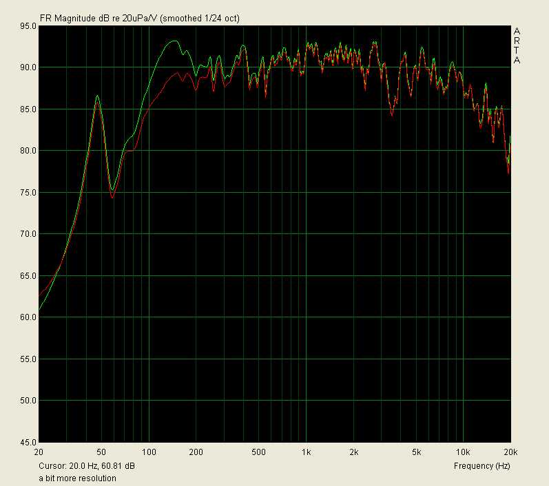

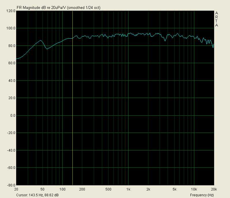

Hahaa, now I'm listening with out an external EQ, just the speakers xovers. I made a one little change, LSP-CAD is just great for "testing", increased the value of parallel resistor from 8.2 Ohms to 22.4 Ohms. Much, much better result. Still room for improvements of course, just have to wait till an another sleepless night comes with new ideas 😉
with 200dB of diagram range everything looks flat and linear. Increase resolution (say to ~60dB) so that you can really see what happens! 🙄

Yep, but you all should know by now that it's all about the looks with this project (and that's failing too...), even the sound is judged here by the looks of the graphs 😉
Wife likes the new sound, she says that they sound more like "nothing" now. Looks, well she's not that exact with that (I'm a living proof).

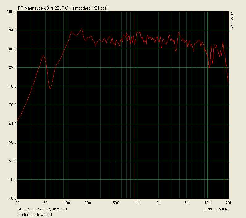

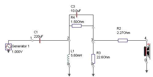

More bad parts added to the signal path. Random. Is the xover OK like that or did I break some rules of how things can be done? And it's really beautiful as well!
I'm not able to test the speakers now with a high sound levels, but at least with a moderate volume level all seems to be OK.
OK, they are dead again. I did thrown them down from a window. Distortion levels kept going up with highs, like cymbals. Vocals were still crystal clear. Isolated the problem to the toroidal transformers. They are leaking like mad, sparks with a bit of power from 50VA amplifier. I think this it for me. I'll buy a commercial version or something.
Now listening a good pair of box speakers and they sound like $hit even compared to the not properly working ESL's. But the good music still sounds good. Now I don't have to considerate on the sound (since everything sounds ****) I can just enjoy the music.
