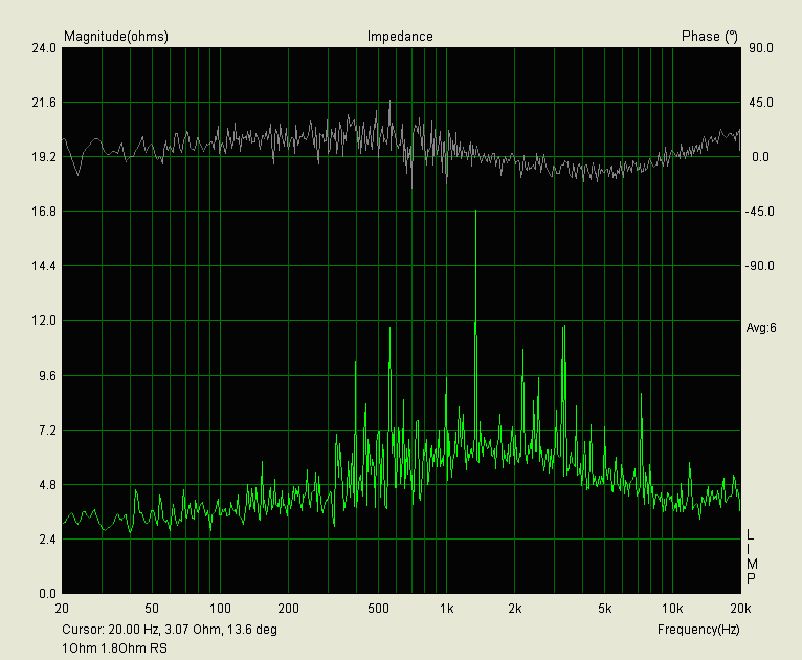

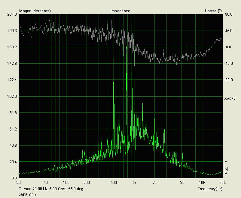

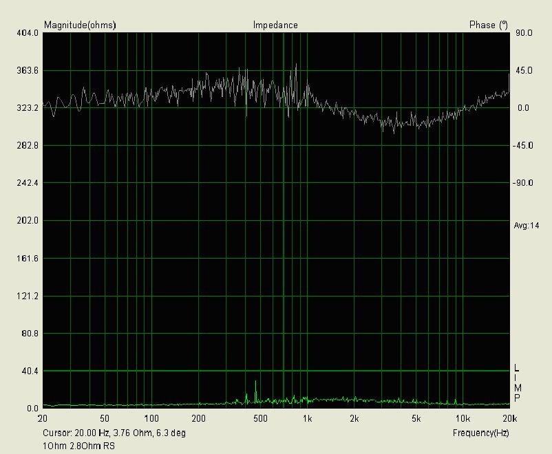

There's quite a lot noise in my impedance measurements, but I guess the message is coming trough anyhow. 1st one is plain panel, 2nd with 1 ohm series and 2.8 Ohm parallel "RS".
Now I have 1.8 Ohm parallel resistor and there's still bit of a bump in the impedance curve (I'm pretty sure that if I go to 0 Ohms it will level out
) as you can see from the 3rd picture and it's in a nicer scale too...
Now I have to try out that software and see if I can manage to create a circuit that is behaving like the measured one. Or are the measurements way of what they should be?!?

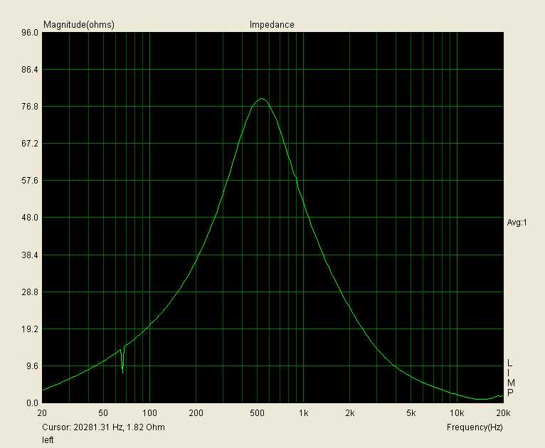

LSP-CAD is working fine 🙂 Made an another impedance measurement to get the "complex impedance" txt-file exported for the LSP-CAD.

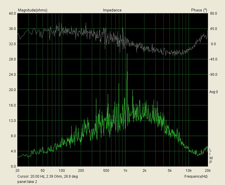

Something funny is going on with my measurements, much lower impedance bump this time. Have to make a prober circuit to measure the thing (now there's just a awful pile of leads everywhere and I'm using headphone amp of my stereos on top of that).

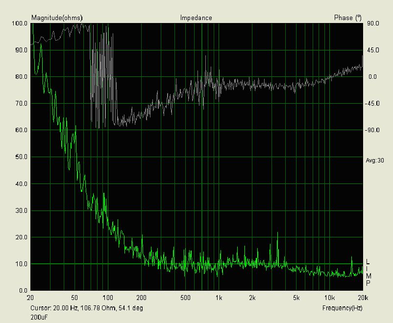

A couple of new charts below anyway, 1st panel only 2nd with RS+200uF series capacitor.

Very Weird impedance graphs , is there any filtering being used ? I would try another software ..
X-over Panel @ 200 will eliminate that issue , Did you figure out what the issue was with the impedance curves ?

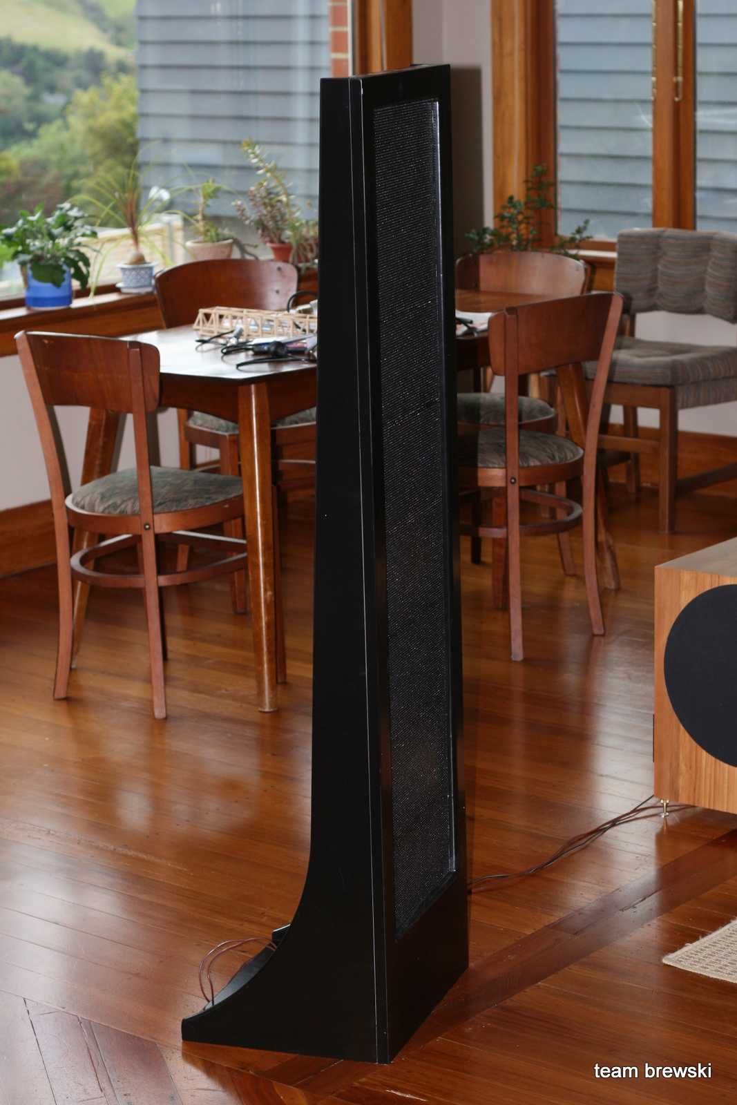

OK, about a 40 trout and a 100 litres of the homebrew later I got my self to build the speakers to the "ready stage". Might still but a wooden strip on the side of the frame to cover the gap between the mdf-sheets.
There was some issues with the 1st setup, the mylar and spacers separated after one of the speaker fell down (too much homebrew...). Also there was a lot of HV-leaking going on because of the poor insulating of the stators. The glue that I used wasn't that good either, so a redo was called. A few more layers of the varnish and this time the HV-testing BEFORE the build 😱
I used a double sided tape this time to attach the mylar to the spacers. A one good thing about the the tape is that I was able to insulate the edges of the perforated sheets with the tape ("rolled over the other side"). There was leaks at the sharp edges that I wasn't able to fix properly with the varnish.
Alignment of the holes was pain though, but after I got idea of using matches to separate the sides while I got the holes in line everything went OK. How are you other tape users doing the alignment? Pretty painful to do at least with out helping hands...
Will do some measurements next time I got the motivation...but they sound pretty good and even the sound level of the pair is identical (judging by the stereo image). That wasn't the case with the previous build...

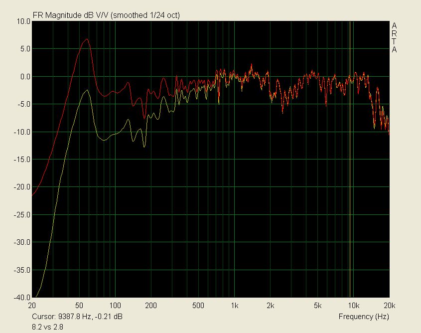

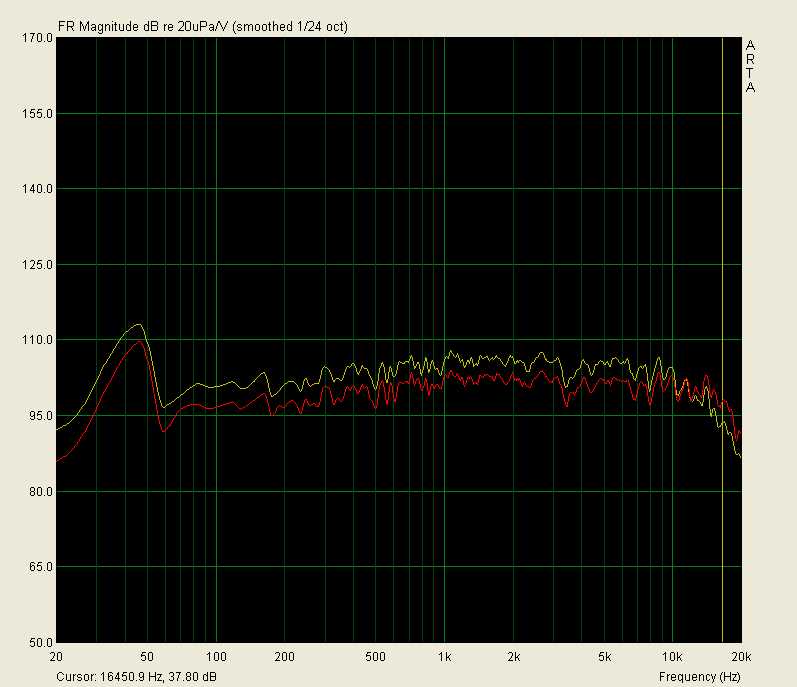

Had to add more wire to the transformer primaries. Starting point was 5.7VAC when the transformers were in 230VAC (2*toroidals/ESL). Added a 15 rounds to each transformer to reduce the step up ratio. Still enough of the squall to my ears even with a low power amp. The red curve in the attached picture is the after situation (both measurements with a 1 Ohm series resistor).
My Mylar is not as thigh as I was planning it to be and the resonance is very low. I guess that the tape that I was using to fix the mylar to spacers gave away. Next time I know better.
Still busy with the fishing (as you can see 🙂) so I just "have to" live with this set up for a while. The speakers sound really nice... except the lows, need something to between 50-200Hz, now the transition from ESL's to the sub is awful.
