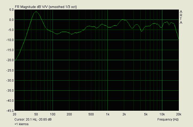

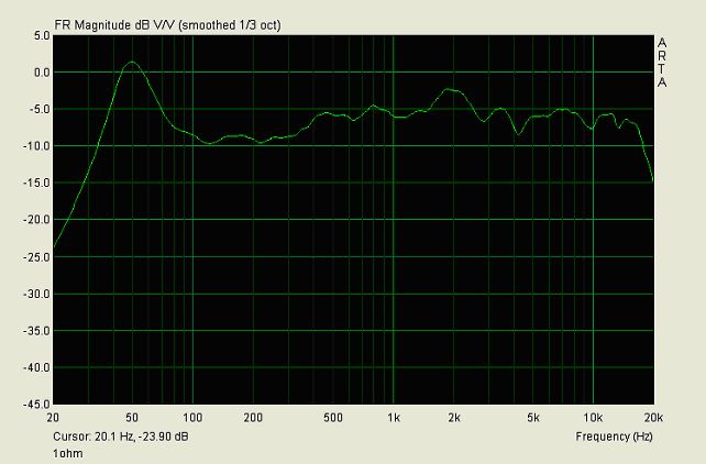

Yep, tried with out series resistor as well, but I get quite nasty resonance peak if there's no series resistor. Now I have 0,5 Ohm and that seem to be the best value in my system.
Only difference in pictures below was that I did put one more round to the primary. It seems that in my set up the step up ratio makes the biggest difference how the highs behave.
But the speakers sound really nice, that's the main thing, I think. Need to start a woofer project next, dipoles... Well, I will first wait for couple of weeks and see are these ones still alive...

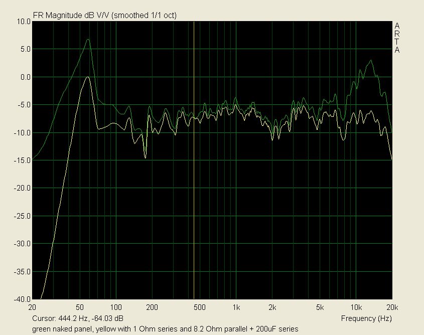

Thanks a lot for pointing out this good thread!
After installing the impedance correction resistor (8.2 Ohm) no change to output, but huge difference how the HP-capacitor acts. Now I need to use bigger series capacitor (200uF). It don't cut off the resonance anymore, but it acts like a prober HP-filter now.
Next I need to do the notch and the RL. That's going to be a bigger job, with the impedance measurements and learning how to use a new software. Hmm, as I'm lazy, is there any way to get away with a trial and error method with the notch and RL?
The 2kHz peak vanished when I moved the measurement point a bit higher... Not a spooky thing after all 😉 My measurements are from about 10cm away from the speaker.
Just had a quick look at the impedance measurement with ARTA and seems to be pretty straight forward, I'll try to get that done next. Just need to do the "voltage probe"...
Below a plot showing where I'm now with this never ending tweaking process. Will try with a bit larger capacitor later, but now I will listen some music 🙂
