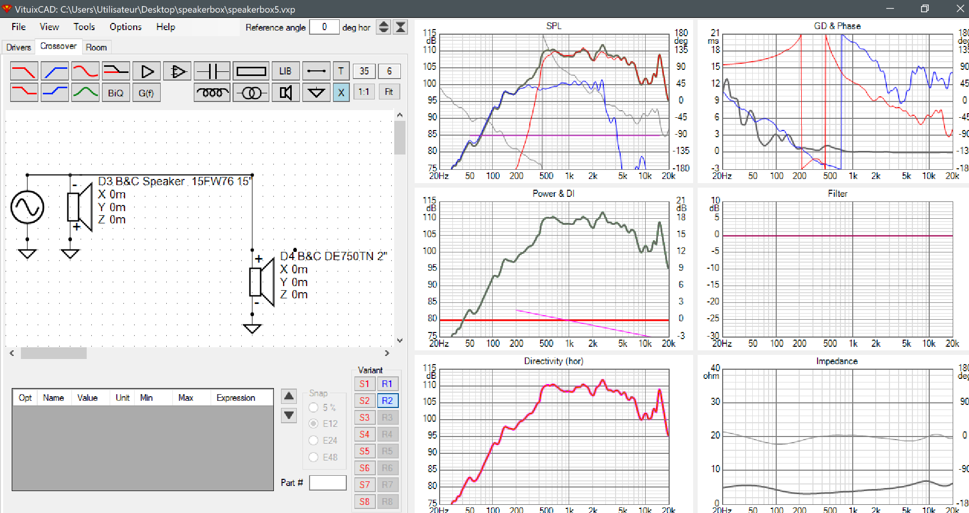

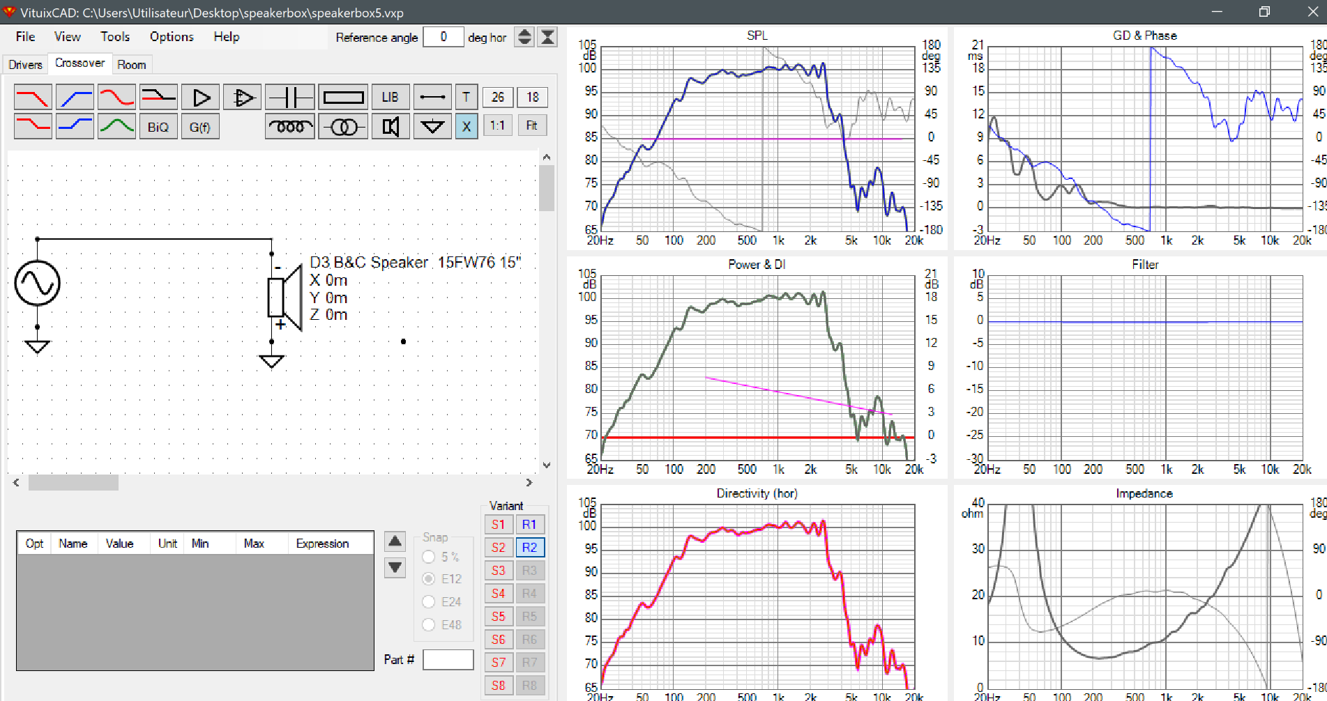

Here's the woofer alone and with a tweet, nothing else in the circuit.
Too much going on in the higher frequencies with the woof, so I filtered them out. I thought
having less going on in the midrange would clean up the signal a bit. But I was
having trouble finding a woofer with high sensitivity that could give me at least some decent bass and cover the 1-3khz range. This one does overdo it though me think perhaps..

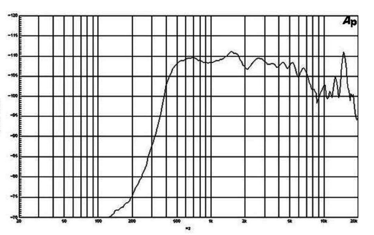

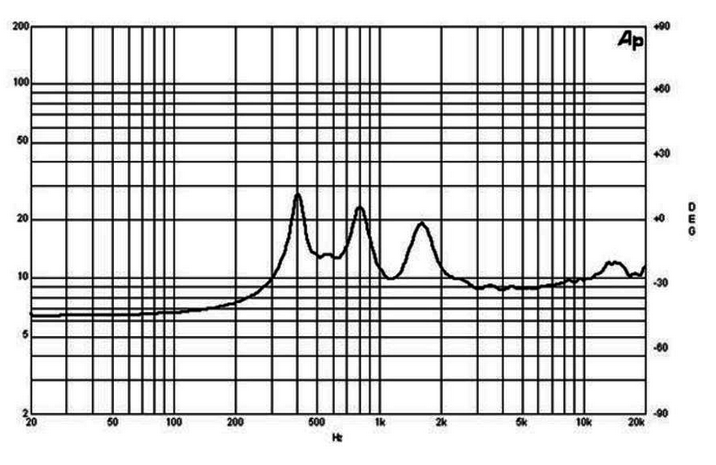

This "tweeter" has the oddest impedance curve (1st attachment) I have seen. Admittedly I've never used a compression driver so maybe this is normal...
I'm not really sure it is suited to a two way, looks like really it should be used as a mid in a three way, unless you are planning on shaping it severely (making use of it's extremely high sensitivity and turning it into a medium sensitivity driver....

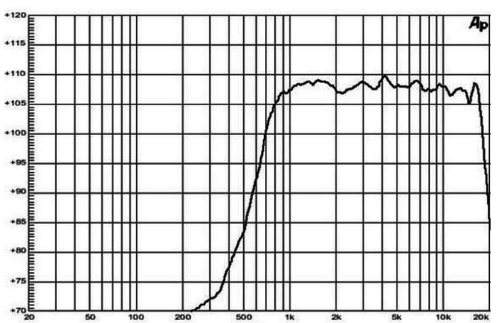

A standard horn no, such a thing doesn't exist. Here's a DE250, a known basic driver for comparison. I would guess that the higher frequency issues are related to the larger driver, matters such as the phase plug. It would behave differently on a horn but at those higher frequencies, there is no guarantee that it will work, especially on a good waveguide.

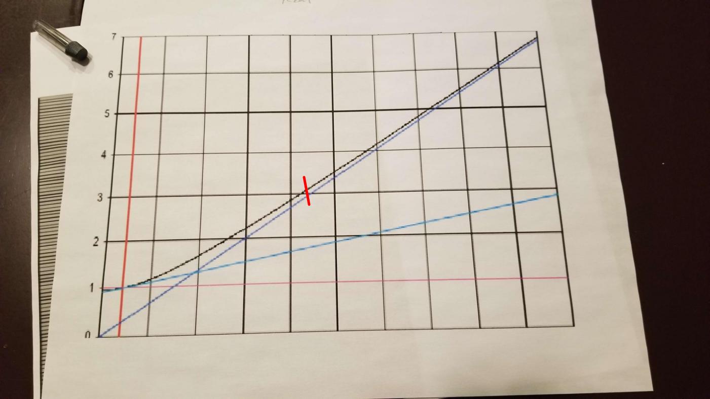

I have marked the place where 700Hz performance is established. Feel free to begin the roundover +/- this place, and start slowly.
