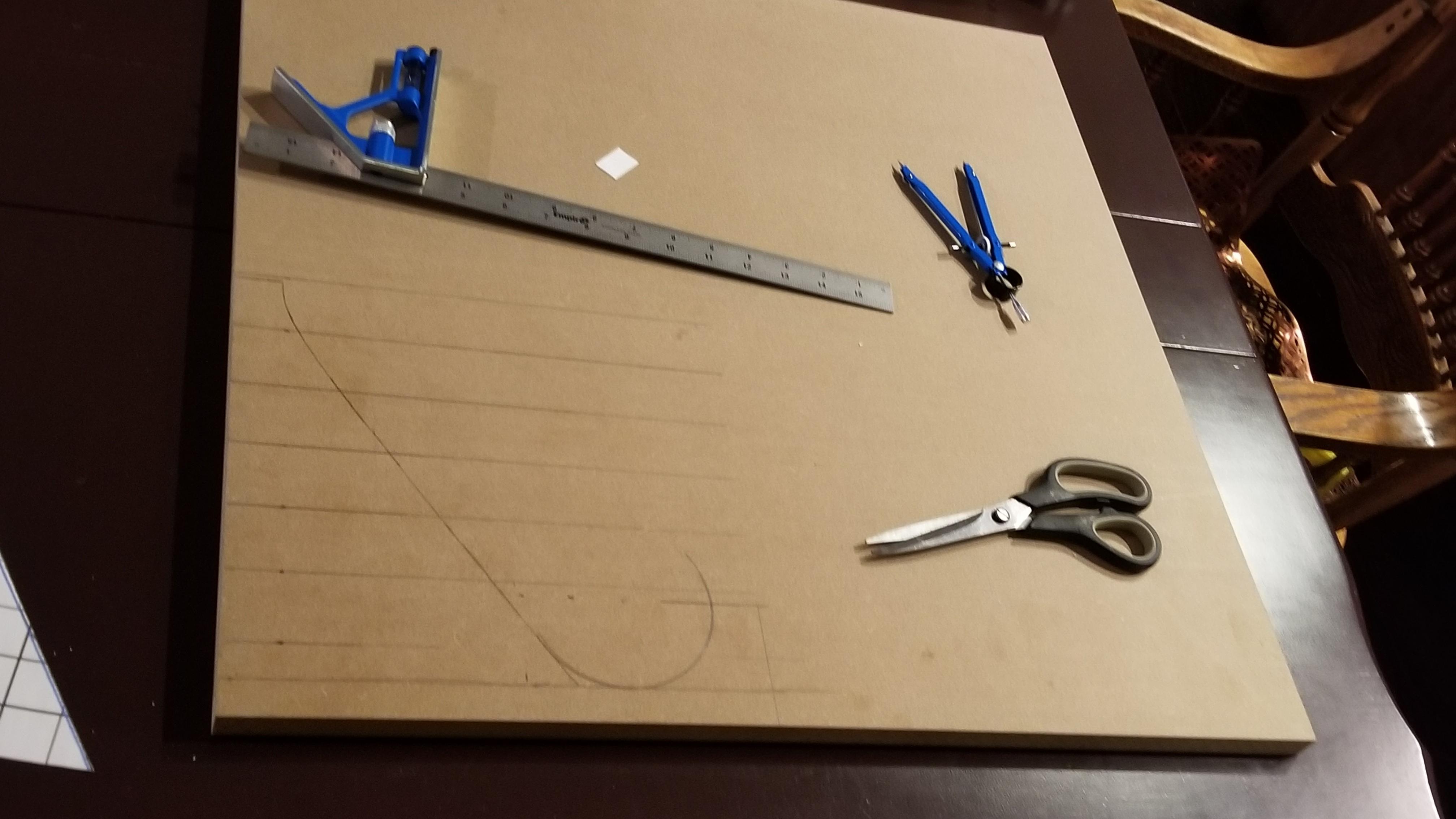

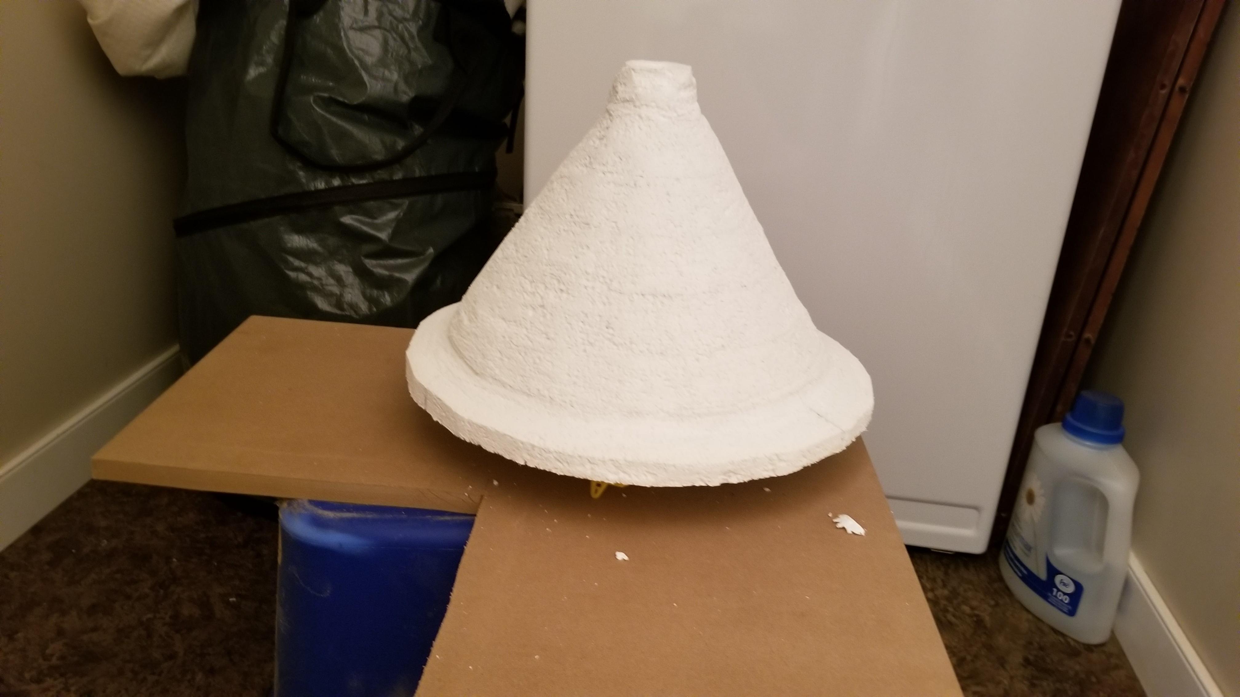

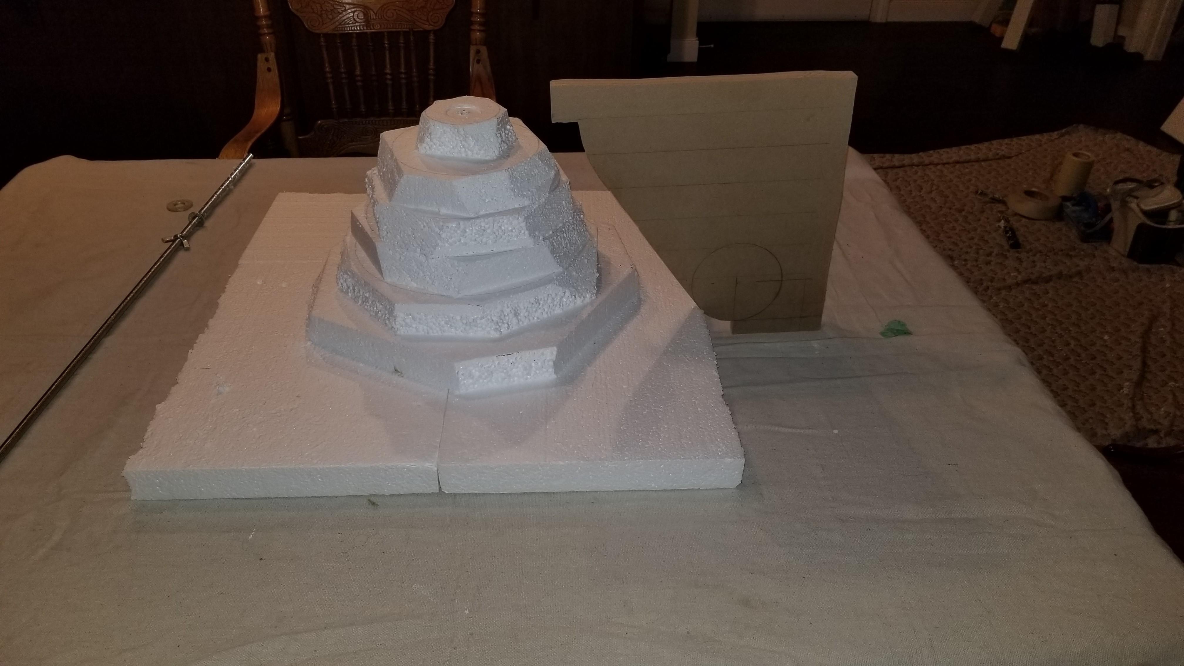

Not a problem. The roundover can be larger than the straighter section of the waveguide. The roundover is trying to cause a change which in this case is better done gradually. I would expect the waveguide in total to be larger than the woofer.
