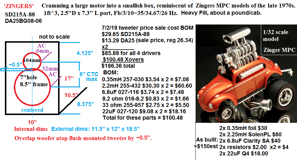

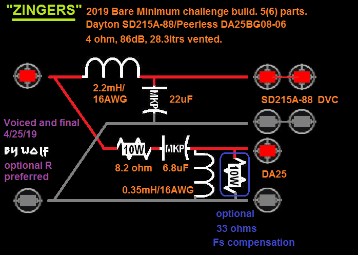

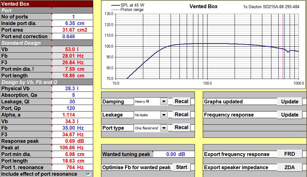

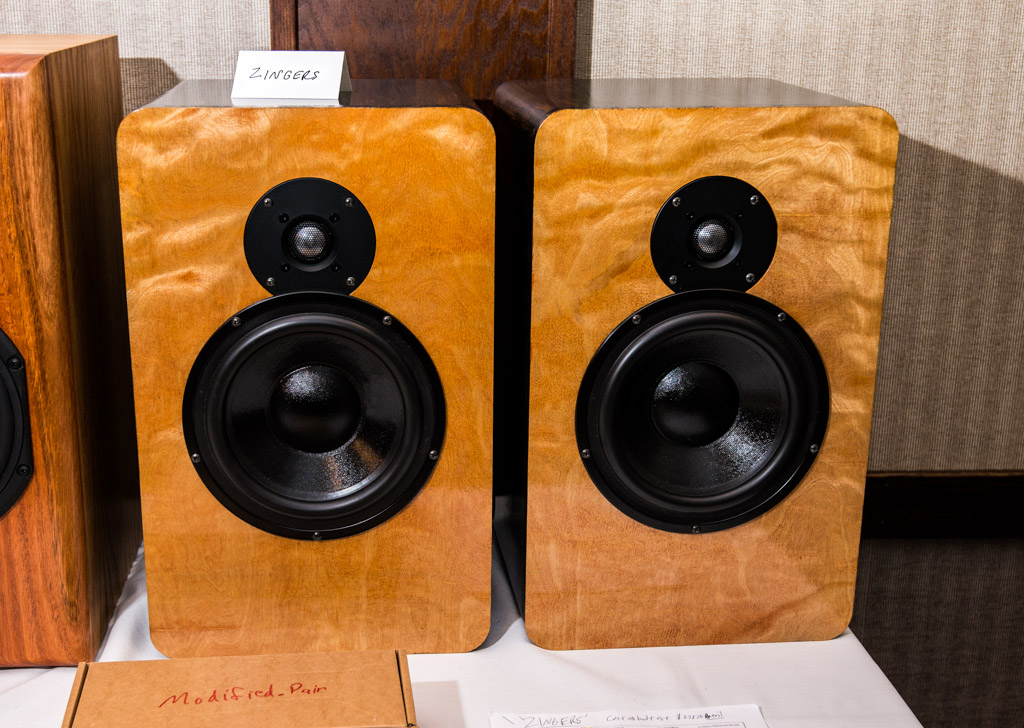

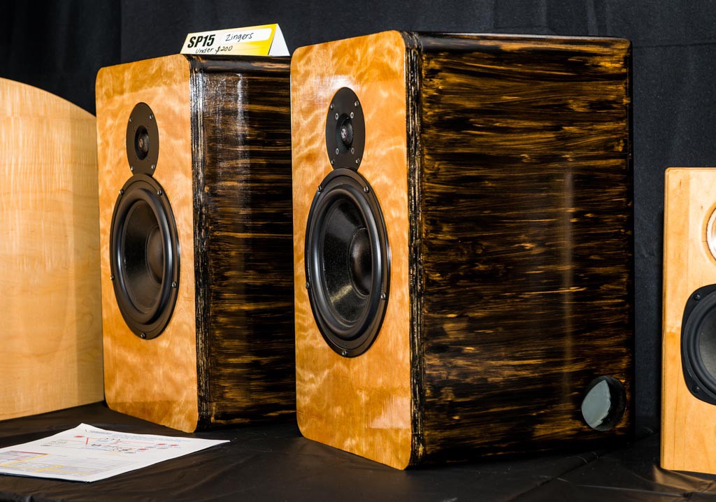

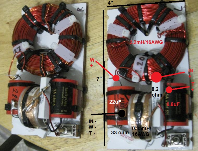

The only 'cheap' 8" simple 2-way I'm actually aware of that does a lot right in balancing the tradeoffs is my Zingers build. The drivers themselves are just over the mark at $112, and the xover consists of 6 parts per cabinet.
I don't think you're going to get closer to your budget for an 8" build.
Later,
Wolf
Later,
Wolf
