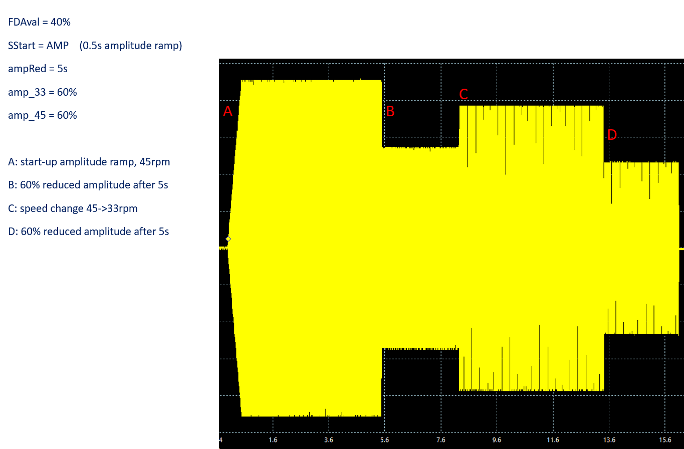

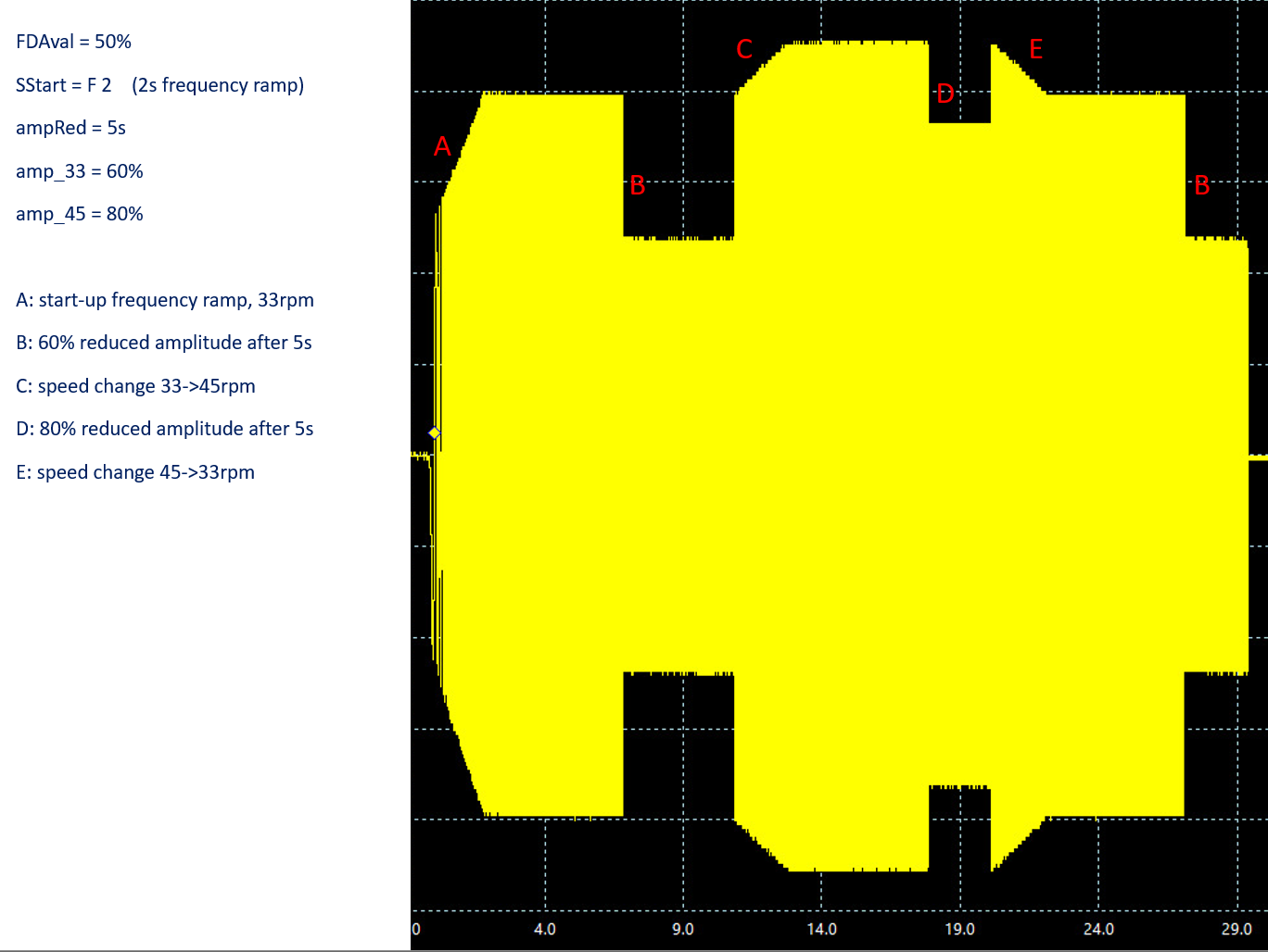

Further to the recent addition of frequency ramping (from start and between 33/45rpm frequencies), and following on from some very useful input from Bill (of SG4 fame) and other users, a new Frequency-Dependant-Amplitude (FDA) feature has been added to the firmware.

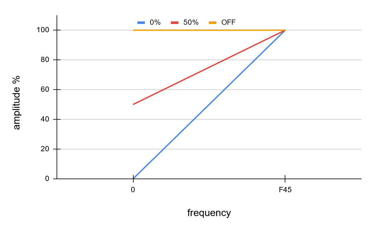

This is a global setting that scales the output amplitude with the frequency during all modes of operation, primarily intended to allow the current and hence torque to be equalised between the 33 and 45 rpm settings, and during start-up when a frequency ramp is used (for example for permanent-magnet synchronous or BLDC motors).
A new setting 'FDAval' in the 'amplitude' menu page has been added to set the zero-frequency amplitude as a percentage of the maximum amplitude (at 45rpm). The build guide in the first post has been updated with the new menu feature and description. Please request the updated firmware via PM.
FDAval setting (only 3 cases shown for clarity):
Some examples:
