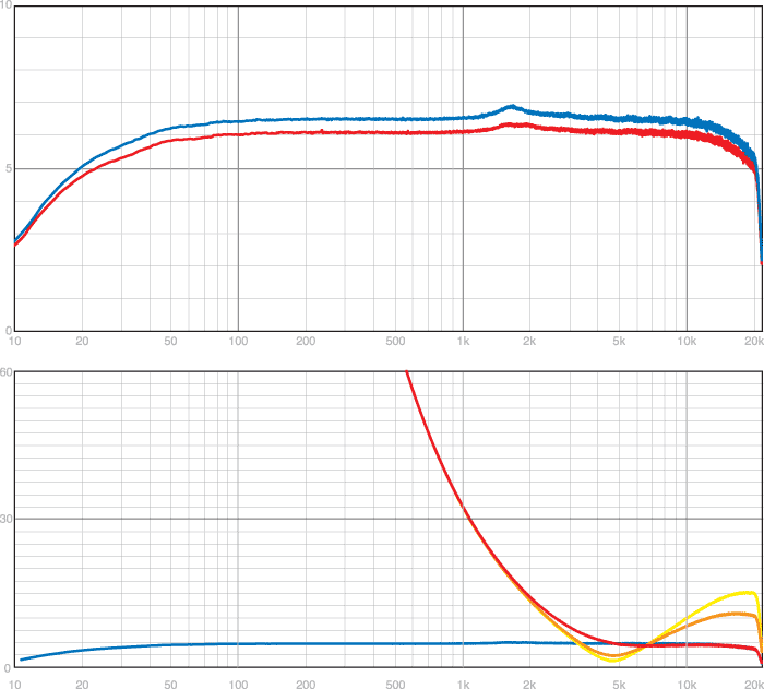

Allen (and others) will have graph that show the impedance of both sides, here is an example of measured impedance of a Sony ribbon tweeter (w very flat impedance) with and without XO.
