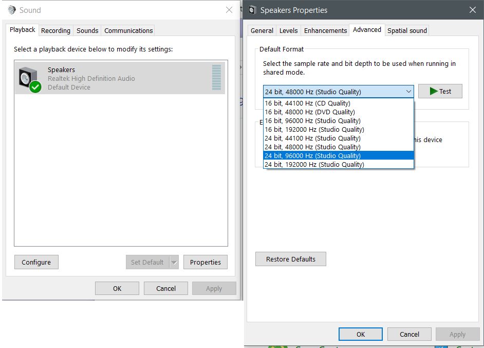

It should probably work with the default UAC1 USB sound drivers, but maybe not. That might mean you would be limited to 48kHz maximum sample rate, and Windows will resample all sound to the 'Control Panel/Sound Device' default sample rate and bit-depth you specify as in the pic below. For that dac you might want to try setting it to 16/44 (CD Quality).
