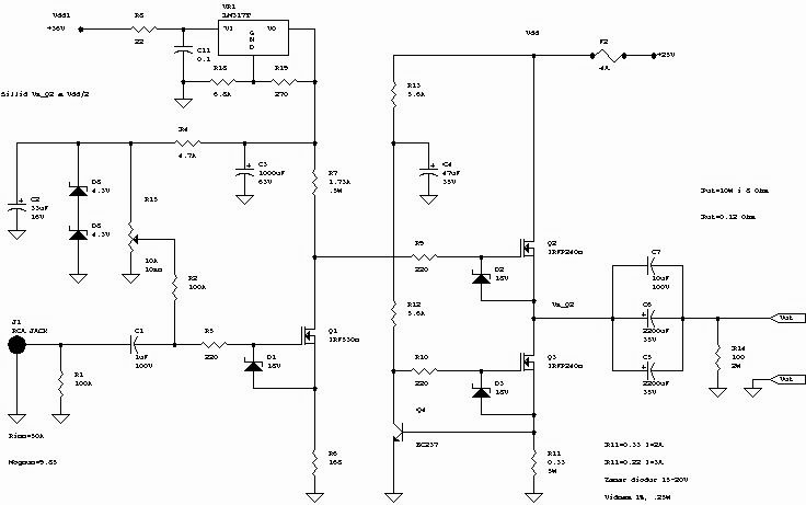

hello
look at this design. here is the link: http://www.raunvis.hi.is/~matti/hifi.htm
if you need more power just increase voltage.
dont build the hybrid amp. I´ve tried to build it and had a lot of problems. the amp keept blowing up the output mosfets. i've tried to change the output transistors (irfp240) and i had no luck. so i cannot recomend it. i've tried almost every thing to make it work. 😡
regards
ricardo

my hybrids doesnt work , too
I had build generosos hybrid+, with pcb`s, bought from Mr. cozza.
Because i would save time in building my own pcb.
But - the hybrid+`s never worked. the mosfets blowed and after several attmpts and stupid mails with Cozza i gave up.
Meanwhile i build a Bosoz/Soz project which works really fine.
best amp i ever had!
Ralf
