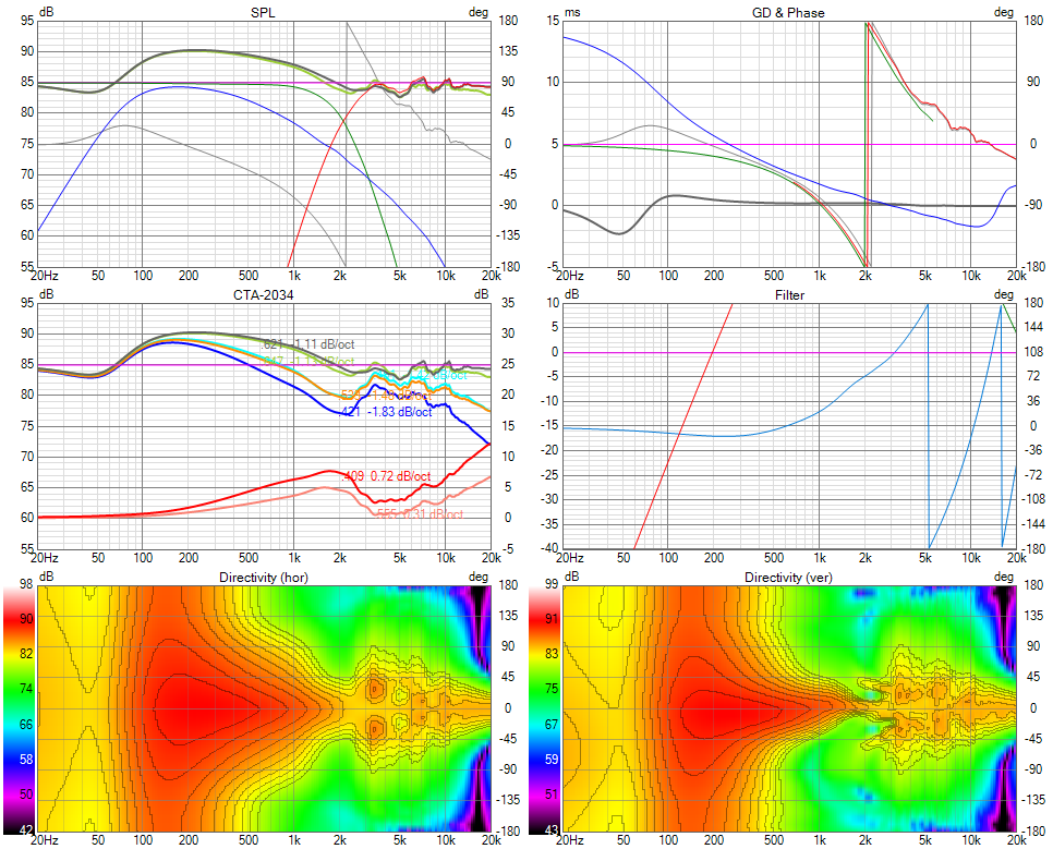

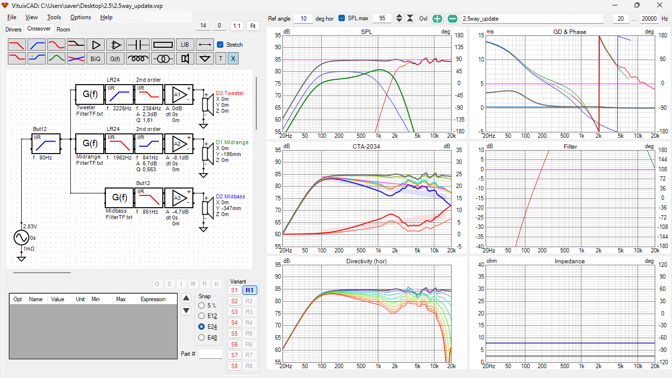

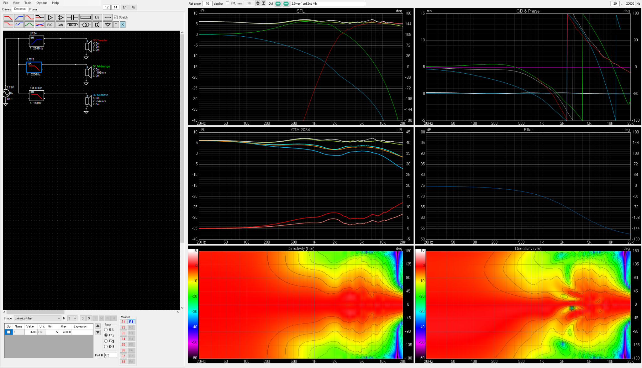

2.5 Way Crossover Simulation Help
Lost on how to design a 2.5 way crossover. This is a Vcad simulation using the diffraction tool. Midrange/midbass are 15cm (120mm diaphragm), 1 inch tweeter. What's the trick to setting up 2.5 ways?
Vcad project zip attached

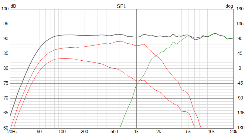

The ".5" in a 2.5/3.5 way is usually used to counteract baffle step loss. You can simulate baffle influence in vituixcad.
It seems you use ideal drivers in 2pi configuration (thus no baffle step) in your simulations.
Edit: full 6dB baffle step compensation by adding a second driver may be too much for many cases, by the way.
Reactions: CinnamonRolls

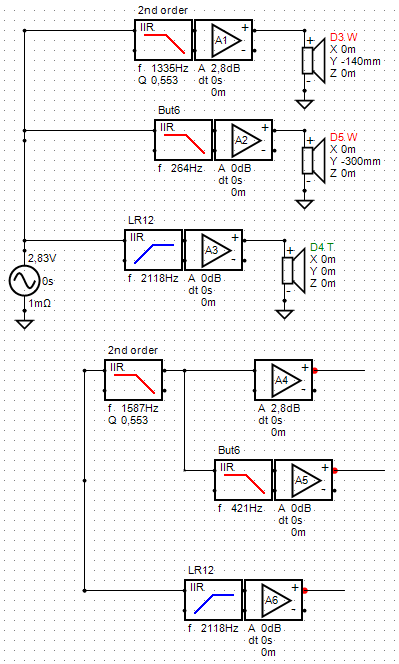

Try this. (I'm a rookie at 2.5x-overs.) Playing around in PCD, this seems to work.
Adjust the .5 woofer to be 3dB lower than the main woofer, and cross it 2nd order at 350hz. No additional filtering on this woofer, other than EQ or notches, if needed.
Now roll off the main woofer as needed to blend with the tweeter. .
I think, but someone will correct me if I am wrong...
You have a 3-way modelled. A 2.5 way would have no high-pass on the midrange. If it were passive, the woofer would just have an extra inductor, so try But06 rather than But12 on the woofer.
That's correct. Also, because they have different outputs the woofer and "mid" can't share the acoustic space, so common to see the "mid" in a sealed compartment and "woofer" in bass-reflex.

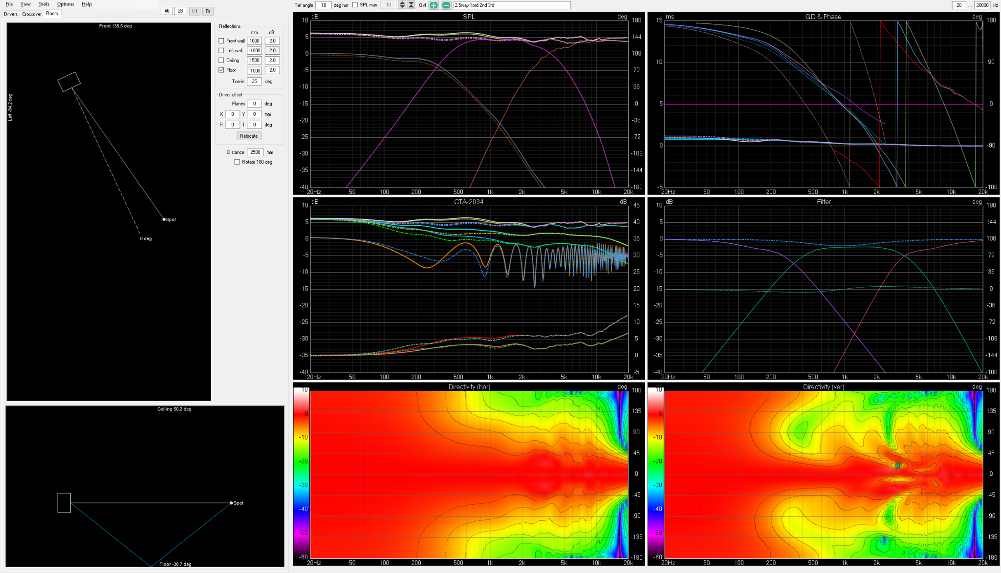

Theoretical simulations with ideal drivers are a great way to check the viability of your basic design or to test some unusual topology, I'm doing them a lot. Great study tool too.
You don't need to flatten drivers' responses with a transfer fuction tool, that's a task for crossover to do.
6in + 1in is inherently a bad topology, the directivity mismatch is simply unavoidable. Any loudspeaker is a compromise, but here the compromise is greater than usual. Do you want to improve your existing speaker, or to build one from scratch? Basically, how fixed are you in the driver choice and baffle layout?
I have tried to achieve smoother horizontal directivity at mid/tweet x-over by using asymmetrical slopes and moved x-over higher in frequency for better verticals (and to avoid edge diffraction). Maybe even higher x-over point would be better.
6+6+1 in 2.5 way sim higher XO
Lowest driver compensates baffle step.
@VoxCelestial "Do you want to improve your existing speaker, or to build one from scratch? Basically, how fixed are you in the driver choice and baffle layout?"
I chose the size because a Scan-Speak 15W8424 was one of the suggestions on the 3-way budget monkey box build thread and SS supplies CAD files I can use to measure diaphragm diameters. In this case, 120mm. So it was the 3D file that drove the decision.
I have no idea what size drivers work well with 2.5ways + 1 inch domes. Revel has a F35 and F36 with 5.25in and 6.5in diameter drivers but I don't know what that means in terms of diaphragm diameter.
I'm not at all fixed on baffle layout. I'm just trying to get an idea of how these are designed and what advantages they create. With the 1 inch dome I would most likely use a waveguide and enclosure simulation (shaped to assist directivity) in a real build.

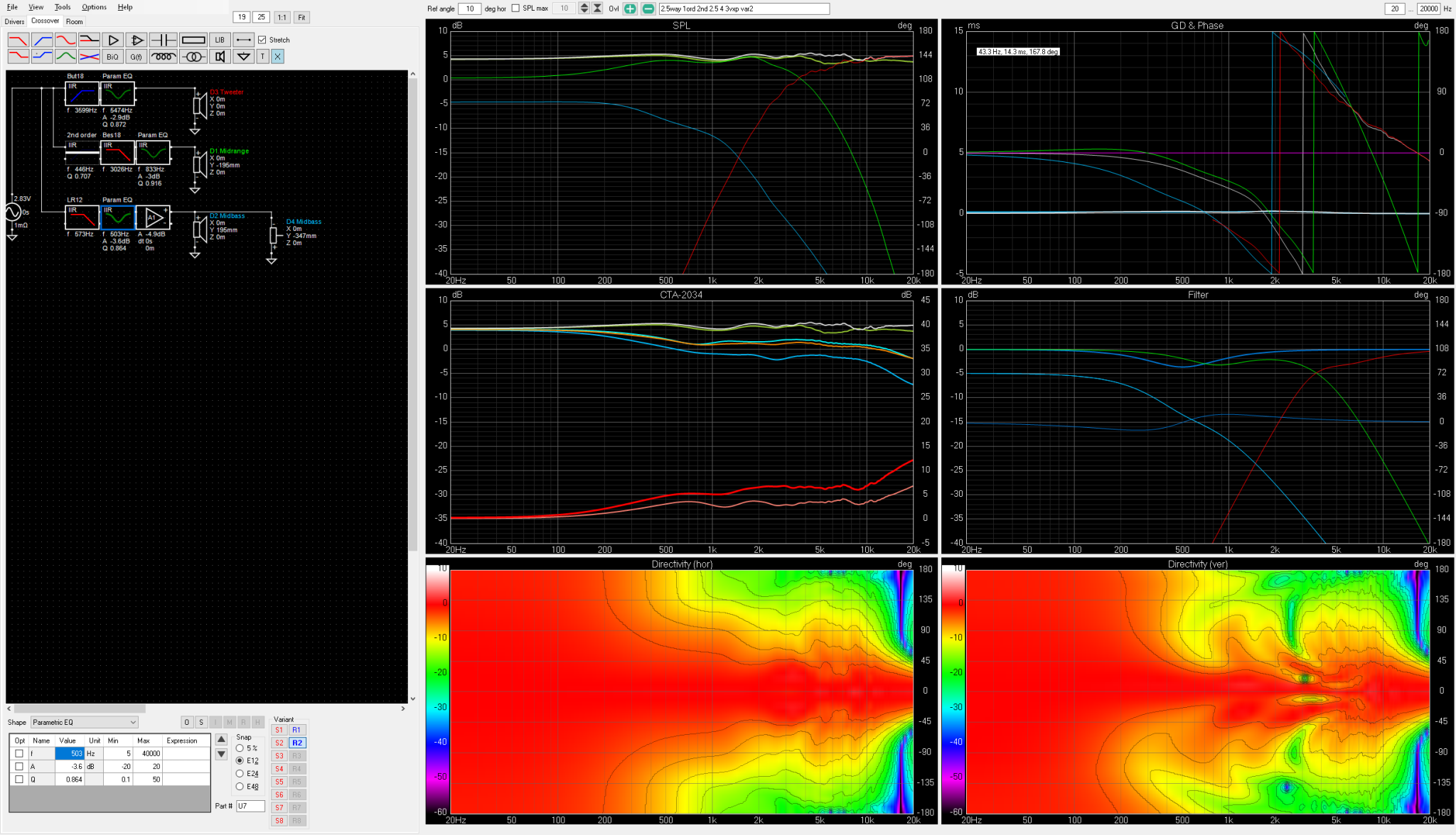

Basically anything up to about 10 inches - as long as tweeter is paired with equal waveguide, like in Revels. Without a waveguide there won't be an adequate directivity matching. So, to get smooth dispersion w/o WG, it's better to switch to something like 10+3..4+1 in, which will get you smooth power response and early reflections. Moreover, instead of traditional vertical arrangement it's beneficial to do something a-la KH310, but with a low W to M crossover - this provides some directivity control down to Schroeder, at least in horizontal plane. Constant wide directivity from 400 Hz to 8 kHz:

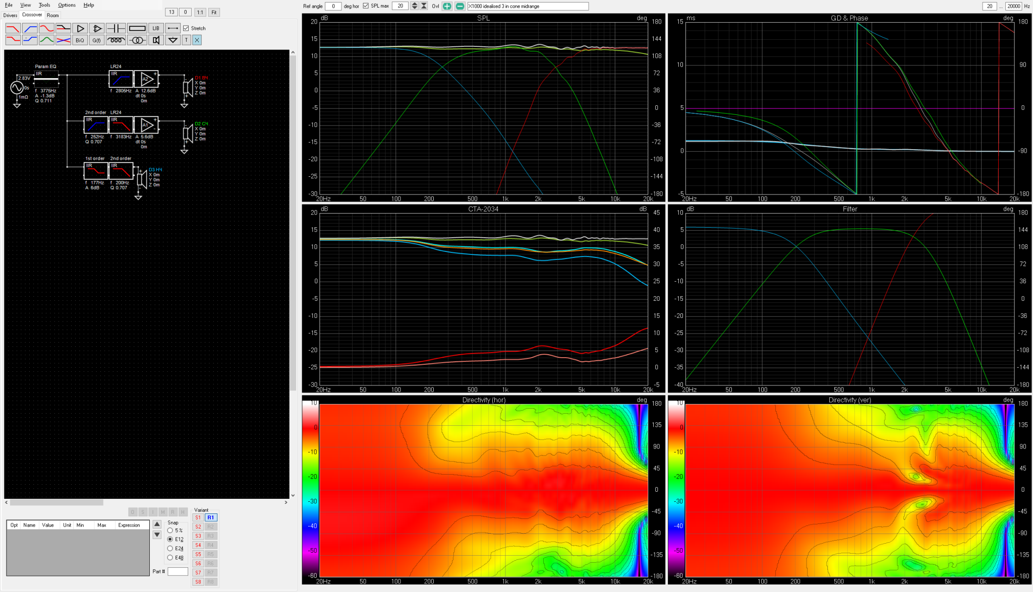

10+4+1 wide directivity horizontal monitor

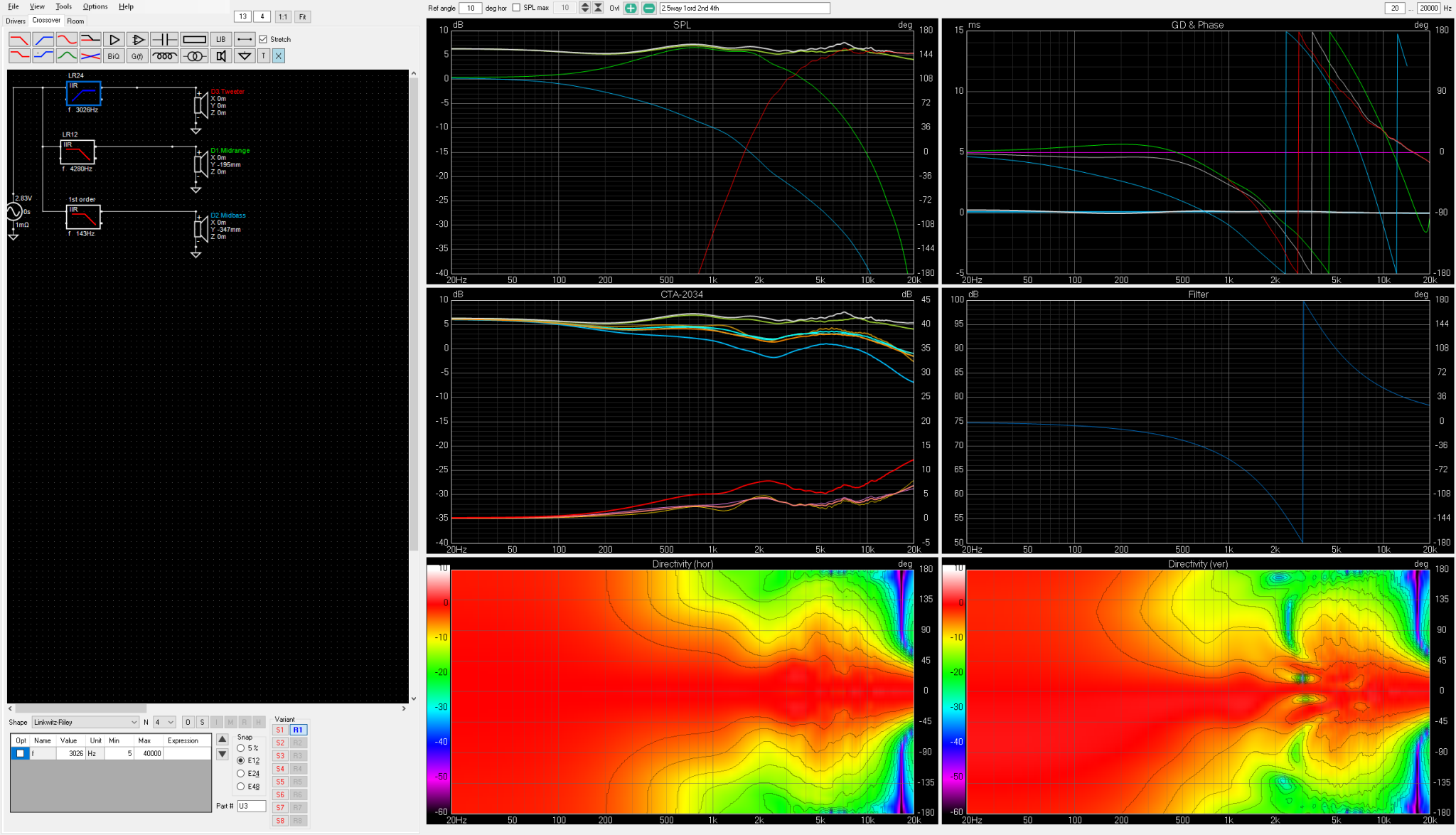

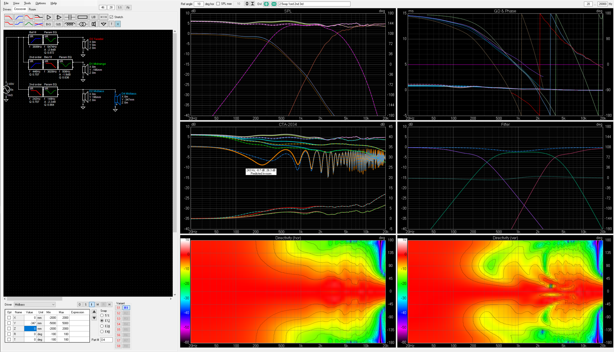

Anyway, I explored the 6+1 layout further. First, I've moved M-T crossover even higher and changed slopes to asymmetrical 3rd order Butterwort/Bessel. This finally gave me truly smooth power response and early reflections, although the vertical directivity isn't great. It's an inevitable compromise when stepping from large mid to 1" tweeter; besides, Infinity Primus series used similar trick and was highly regarded, so verticals appear to be an acceptable sacrifice, if nothing else could be done. Second, instead of MMT layout I switched to MTM layout, as it gives larger acoustic source size and, therefore, directivity control to lower frequency.
6+1+6 2.5 way MTM

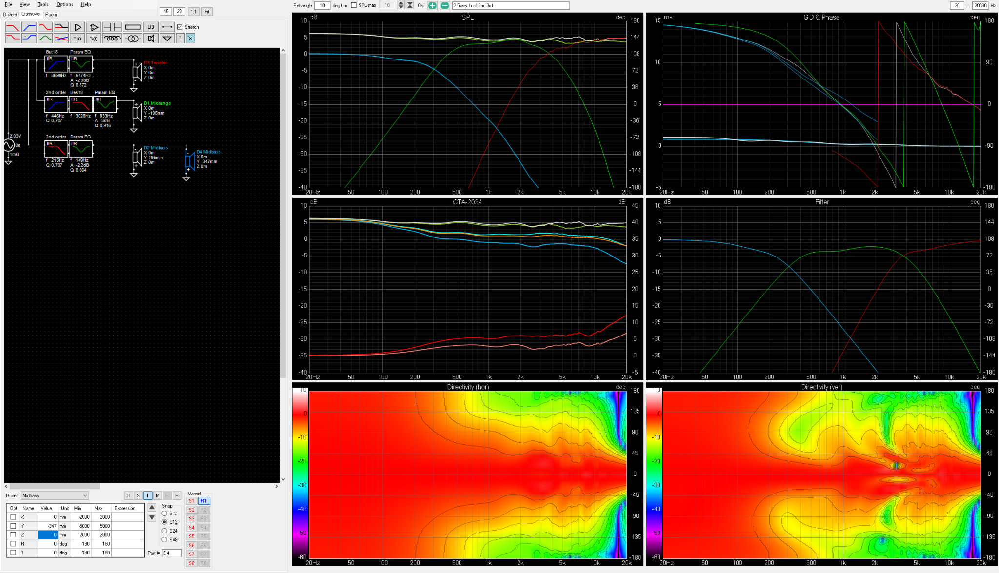

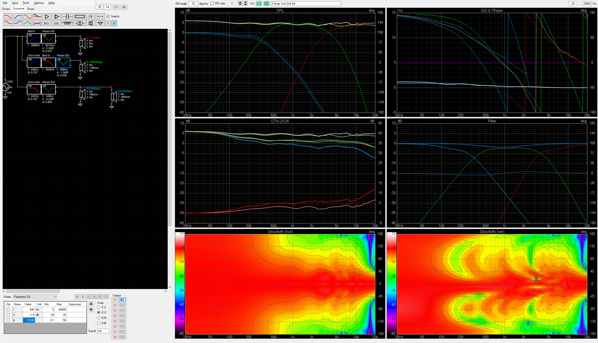

This concept can be refined further by adding another 6 in driver and switching to 3 way topology (I don't like .5 way that much). This gives us very constant 5-6 dB directivity index from 400 Hz to 10 kHz (take note at how 1000-400 Hz HOR widening is compensated by VER narrowing in the same range) and reduces IM distortion, as midrange cone now barely moves at all.
6+1+6+6 3 way
Finally, we move that third driver to the very bottom. Though vertical directivity at low mid now looks a bit wonky, this increases source size at low frequencies even more, increasing DI and, more importantly, reducing floor bounce and associated peaks/dips in the lower midrange (compare tangerine/dashed blue floor reflection curves), so in real rooms this layout will sound better.
6+1+6+6 3 way, LF driver at floor
3 way floor reflection
