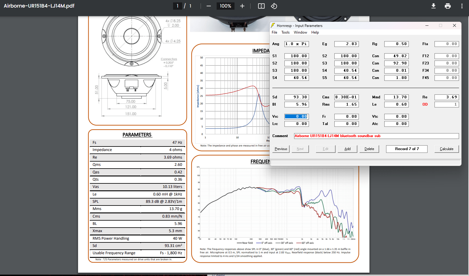

I'm entering specs into Hornresp - but I have questions:
Is Mmd same as Mms? Is the CM correct? .83 mm/N on specsheet, but 8.30E-01 in Hornresp.

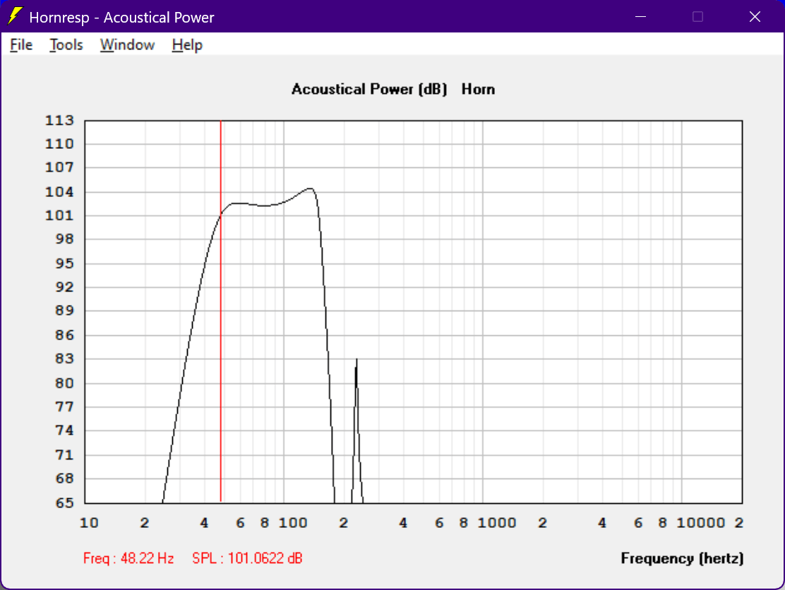

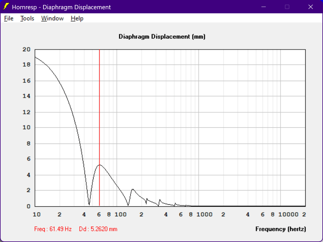

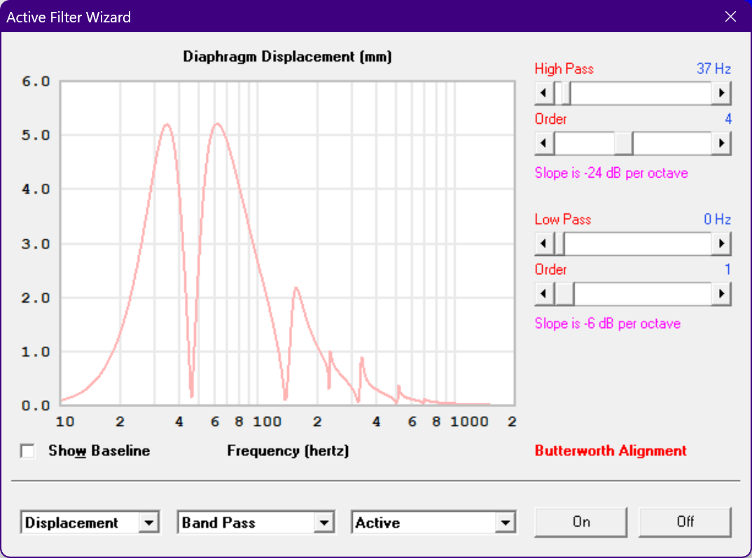

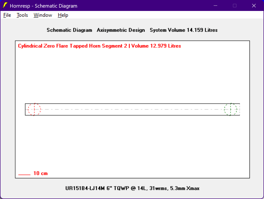

Just realized I have no idea how to configure HR for a TH. I'm imagining a soundbar with a wrap around chamber... like a C shape - one end has driver, other end has port... ends up facing near the driver?
Something doesn't look right in HR for driver specs... says Fs is 1.94 hz !!! I don't see a spot to input Fs of the driver! Can someone take a look above at my screenshot and tell me what I did wrong?
HR export is attached too.
Thanks!
Thanks!
No; re specs in general, best to just load T/S and let HR auto calc the restSince sub will be in close proximity, will likely cross over at 150 hz.
https://solen.ca/en/products/airborne-ur151b4-lj14m-15cm-aluminum-cone-shallow-subwoofer
Is Mmd same as Mms?
T/S Explained: https://audiojudgement.com/thiele-small-parameters-explained/
T/S Equations and how each one affects the others: https://audiojudgement.com/thiele-s...ydc8i*_ga*MTU0NDc0NTAyLjE2ODY3OTc2NTI.*_up*MQ
Re driver's box loading HF BW; it peters out at its upper mass corner (Fhm) = 2*Fs/Qts'
(Qts'): (Qts) + any added series resistance (Rs): http://www.mh-audio.nl/Calculators/newqts.html
Mmd = Mms (total moving mass) - air load
0.83 mm/N = 8.30E-01 mm/N = 8.30E-04 m/N

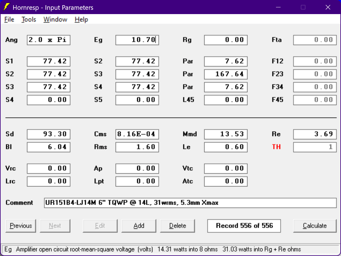

You are not building a pyramidal enclosure, so do not use CON segments.Just realized I have no idea how to configure HR for a TH. I'm imagining a soundbar with a wrap around chamber... like a C shape - one end has driver, other end has port... ends up facing near the driver?
Thanks!

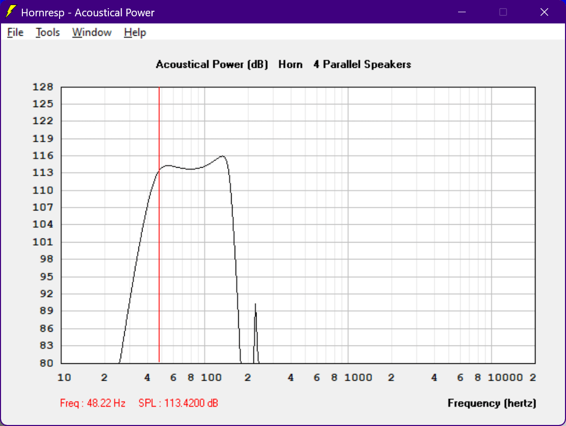

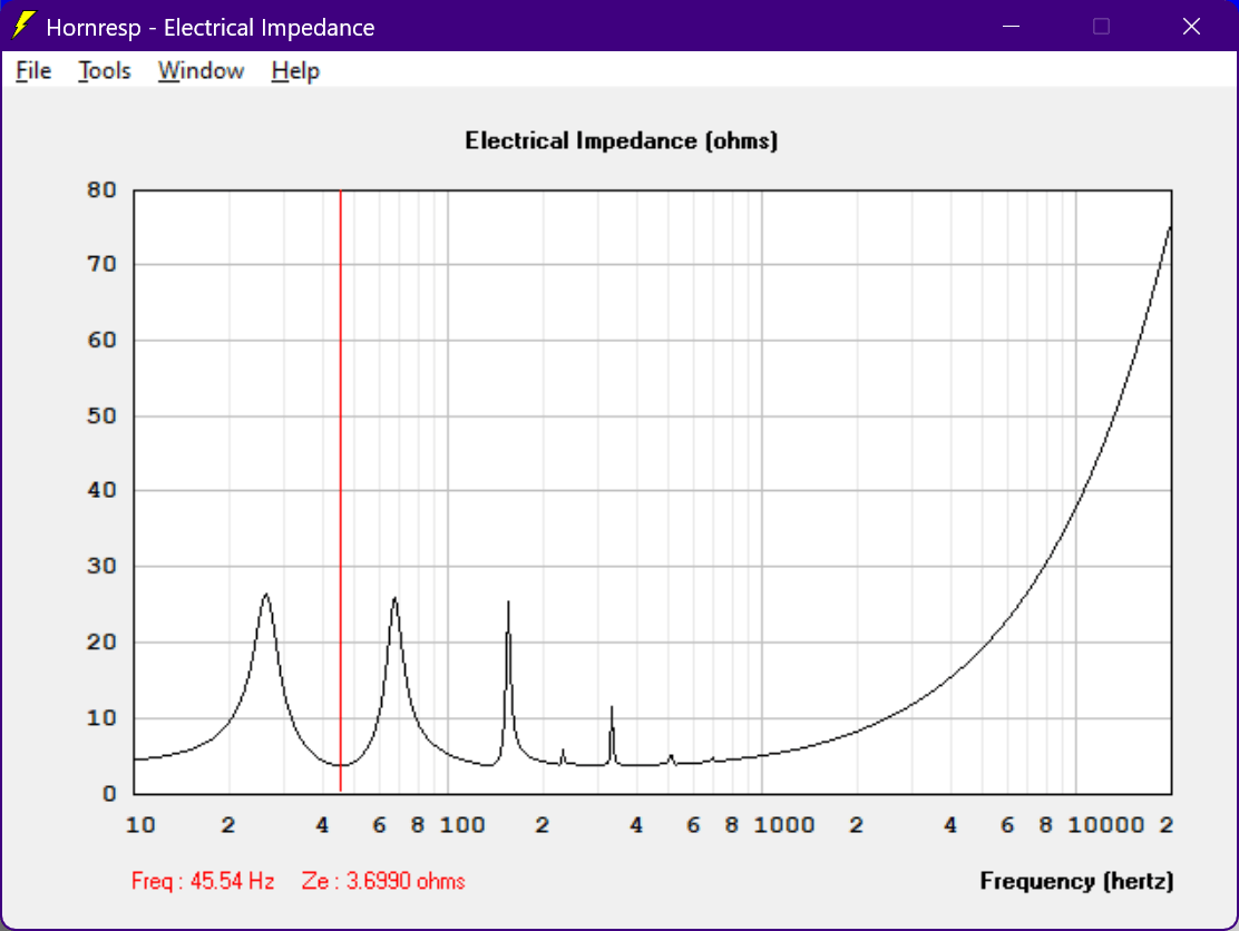

GM's text file shows the correct PAR segments.

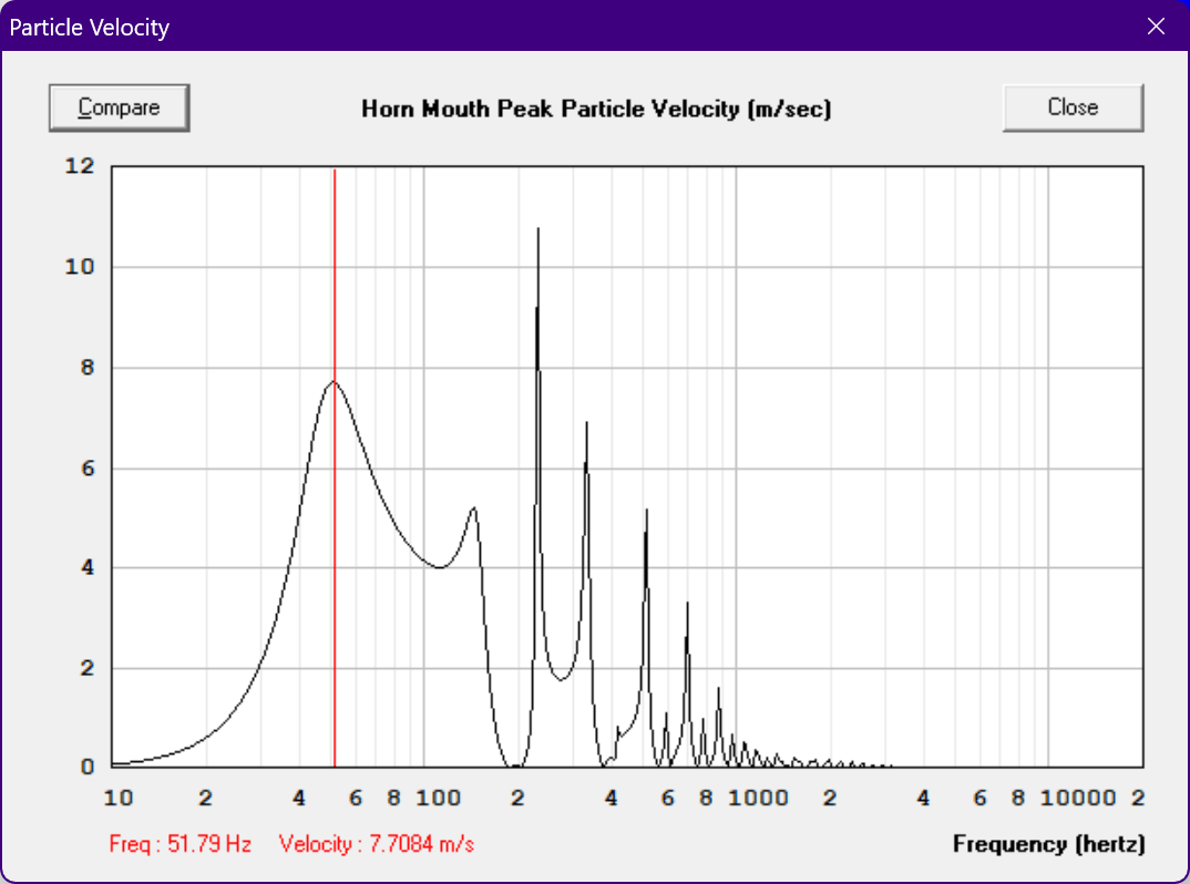

Here is a 6 foot straight (zero) flare TH or TQWP.
Single fold (0.75" thick wood) = 7.5" high x 37.5" wide x 6.25" deep.
Double fold (0.75" thick wood) = 7.5" high x 20.25" wide x 11.75" deep.
