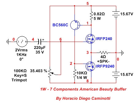

1W - 7 Components American Beauty Buffer

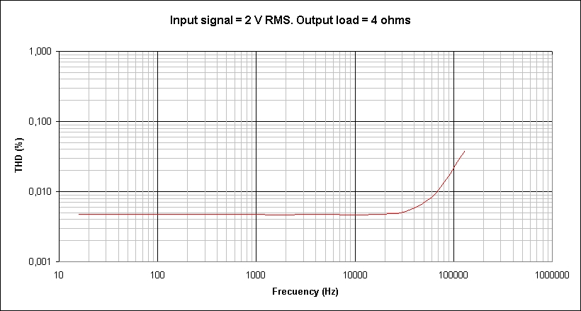

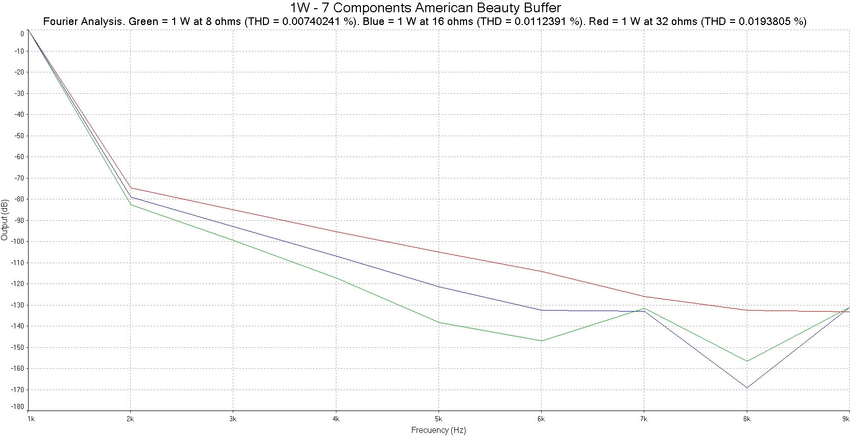

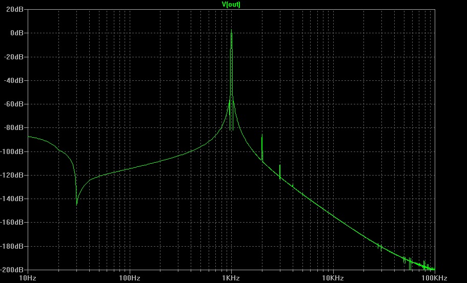

Very simple to build and with outstanding quality parameters. It only requires an adjustment. The output current is properly compensated so as not to expose the output stage to risk.
It should be used with high-performance speakers or it can be used for headphones.
Its outstanding points are: very low distortion and very stable throughout the audible bandwidth, high PSRR

Bias is 600mV/0.82R or about 800mA. Gain is slightly less than unity.
but what intriques me is how you can get the AC current balance equal between the lower and upper MOSFET....?
The way it is drawn now, it is a Single Ended Follower.
Hi Horacio,
Yes, perhaps nothing intrigues me more than simple but great sounding circuits. What is the gain and what is the bias current? I might do this with a TO220 MOSFETs for a headphone amp.
X
722510d1544985384-1w-7-components-american-beauty-buffer-1wabb-schematic-jpg
Being a buffer, its voltage gain is close to 1 (without reaching it by very little).
The bias will depend on the load you wish to connect to the output and under what maximum input voltage you will operate it.
To achieve 1W under 8 ohms, you must circulate a minimum bias of 0.5 A. The 0.82 ohm resistor is responsible for fixing that bias. If you do the calculations, you will see that with it there will be more current than necessary. With a resistor of 1 ohm, in the place of that of 0.82 ohm, it would be enough.
The value of 0.82 ohm would be necessary for a load of 4 ohms at a maximum level of 1 W.
Summarizing:
For 4 ohms => 0.82 ohm 5 W (0.707 A). Max. input voltage = 2 V RMS
For 8 ohms => 1 ohm 3 W (0.5 A). Max. input voltage = 2.828 V RMS
For 16 ohms => 1.5 ohms 2 W (0.354 A). Max. input voltage = 4 V RMS
For 32 ohms => 2.2 ohms 2 W (0.25 A). Max. input voltage = 5.657 V RMS
It is a single ended follower. The supply voltage could be altered to reduce dissipation, if necessary.
When the current through the 0.82 ohm resistor increases above its static value, under the injection of the positive half-cycle of the input signal, the drain-source conduction of the IRFP9240 is reduced in exactly the opposite way. At the same time, the conduction between drain and source of the IRFP240 is coincident in direction and magnitude with the current of the 0.82 ohm resistor (if the weak current of the base pin of the BC560C is disregarded).

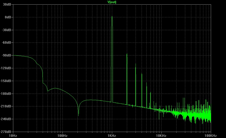

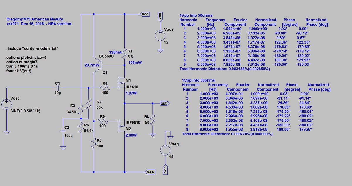

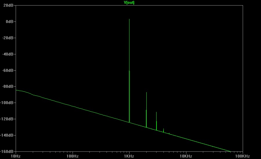

I made the LTspice model for a smaller HPA running 136mA bias and 2W dissipation per MOSFET. Added gate stoppers and a smoothing cap for the bias voltage setpoint. The only thing I found kind of tricky is that the DC offset changes with power supply rail value, and also it changes with bias current setting. My value for 0vdc offset was not the same as Diegomj's value. As a headphone amplifier buffer, it works very well according to the simulation with 0.003%THD driving 4Vpp into 50ohm headphones, and with a very nice harmonic profile. And at a much more reasonable volume of 1Vpp it is 0.00077%THD and still a nice harmonic profile with H2 dominant and very little H3.
Schematic:
attachment.php
FFT for 4Vpp into 50ohms:
attachment.php
I still have my doubts about the -PSRR of this thing. Looks like with a constant current going through IRFP240 and BC560C (btw: suggest higher Early voltage part for this one), any -15V ripple would make it across the 10k resistor with little attenuation and get dumped straight into the load. Might be better as a single-supply circuit... +PSRR should be fine.
722607d1545004011-1w-7-components-american-beauty-buffer-diegomj-american-beauty-4vpp-50r-fft-jpg

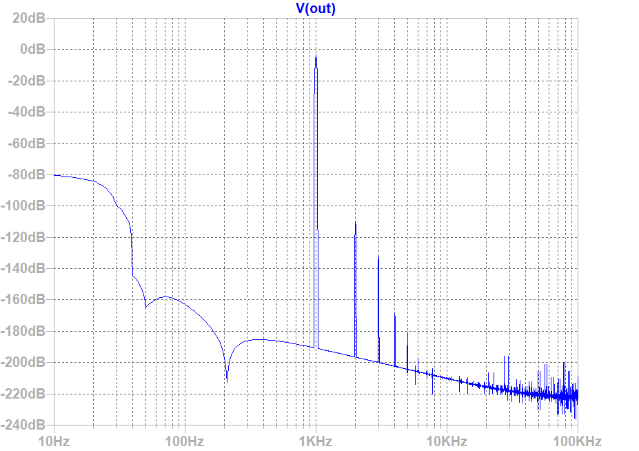

Hint: One would actually be able to see something if you turned on the grid. Also, strongly consider using a decent windowing function, like Kaiser-Bessel.
4Vpp into 50ohms, Blackman-Harris window:
attachment.php
Kaiser-Bessel window:
attachment.php
The noise floor on my measurement equipment is -130dB so not sure if any of this matters much vs the standard non-windowed FFT.

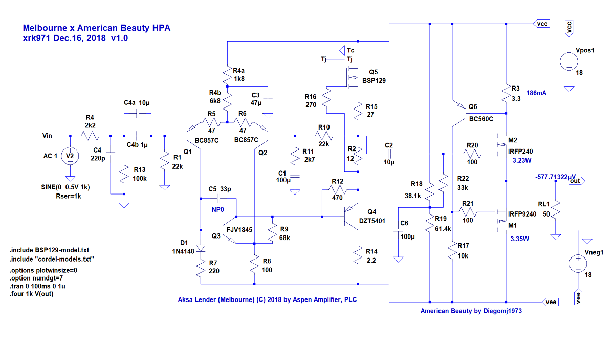

Melbourne X American Beauty HPA
Using the Melbourne as a preamp driving the American Beauty with 186mA bias current and switching to larger IRFP240/9240's for more heat dissipation, I am getting pretty clean results driving 8Vpp into 50ohms.
Schematic:
attachment.php
Distortion Components for 8Vpp into 50ohms:

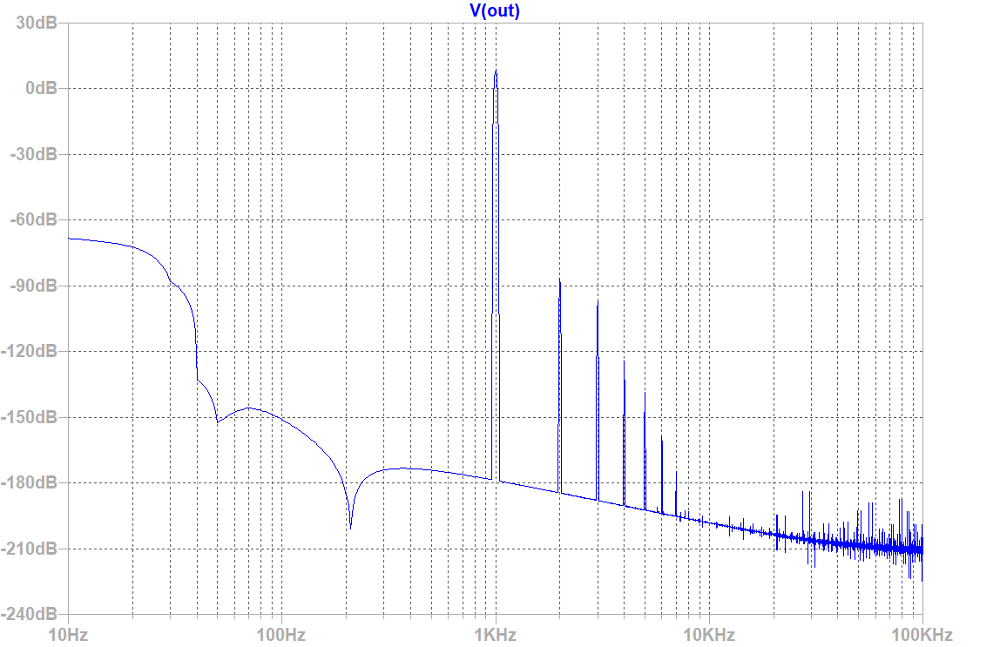

FFT with Blackman-Harris window:
attachment.php

FFT:
attachment.php
Diego,
I really like this, it's simple and just like a White Follower with mosfets.
One question:
As the current increases through the upper output, it pulls more current through the 3.3R resistor which in turn drives harder at the gate of the lower output, increasing its current too.
Whilst voltage is set by the upper source follower, the current through the lower device might better work if it reduces as the upper current increases, and vice versa with decreasing current through the upper source follower, the current through the lower resistor should then increase. This would follow the concept of the active CCS in Pass' Aleph J, and it leads to very high efficiency for Class A.
Hugh
