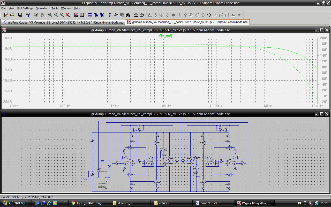

Let me present some design ideas for 1ppm power amps using parallel opamps.
Each opamp is fitted with a Vlemincq output stage made of three inexpensive BJTs. There are two parallel branches for implementing a complementary symmetry. Have a look to the two Vlemincq output stages.
The Kuroda topology got chosen for getting rid of the power supply stabilization one might expect using integrated opamps or integrated buffers.
This way, any unregulated PSU voltage can be used, anywhere from 22V to 42V per supply rail depending on the voltage rating of the transistors used in the Vleming output stage. The simulation got made using ideal +36V and -36V rails.
The regulated +18V and -18V local supply feeding the opamps can be shared by all cells.
For avoiding the Kuroda return current flowing in the ground wire, a virtual ground gets locally generated. Each virtual ground opamp must be capable of handling 15mA.
Single opamps need to be used in the voltage amplification stages, as their instantaneous power supply current get used as signal in the Kuroda topology.
Dual or quad opamps may be used in the virtual ground opamps. Their supply can be the shared +18V and -18V supplies.

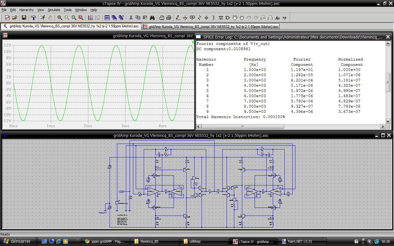

On simulation, each cell delivers 1.50 ppm THD (0.000150 %) when outputting a 24V peak-peak-sinus at 1kHz into a 64 ohm load. You need to parallel at least 8 cells for driving a 8 load with the same quality.
There are no expensive parts in this design. All parts are widely available, multisource and multivendor. There are big savings made in the power supply department as the power supply doesn't need to be regulated.

gridAmp Kuroda_VG Vlemincq_BS_compl 36V NE5532_hy 1x2 (x-2 1.50ppm 64ohm) (schema).jpg121.7 KB · Views: 800
gridAmp Kuroda_VG Vlemincq_BS_compl 36V NE5532_hy 1x2 (x-2 1.50ppm 64ohm) (1ppmTHD).jpg332.7 KB · Views: 749
gridAmp Kuroda_VG Vlemincq_BS_compl 36V NE5532_hy 1x2 (x-2 1.50ppm 64ohm) (3 MHz BW).jpg335.4 KB · Views: 711

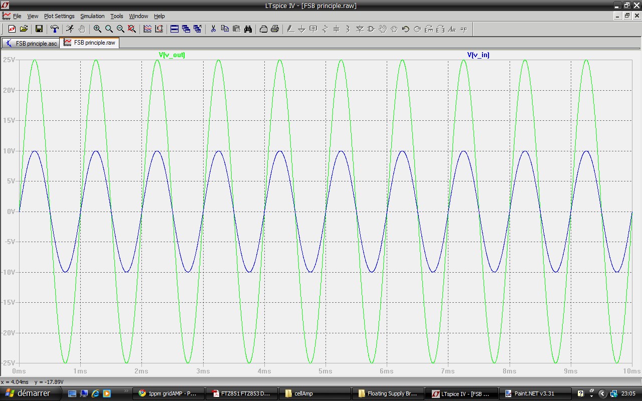

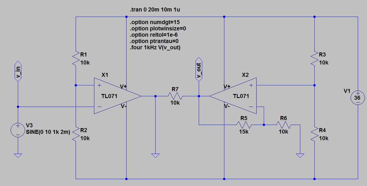

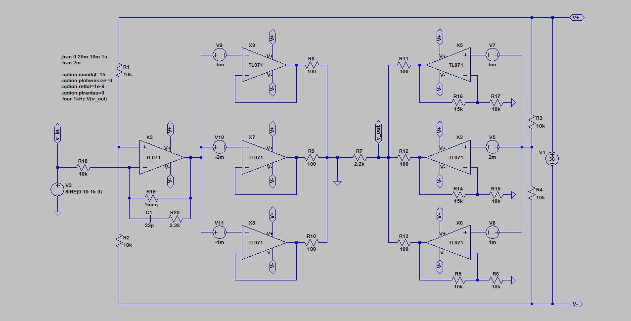

hi jcx, the floating supply bridge looks attractive. I got it simulated. Works like a charm. Many thanks. From where is the first opamp getting his negative feedback ? What's the magic ?
hi jcx, could it be the right side of the schematic of the floating supply bridge can't be implemented using parallel opamps ? With this schematic, there is a major current sharing issue in the right side of the schematic.

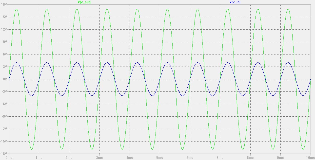

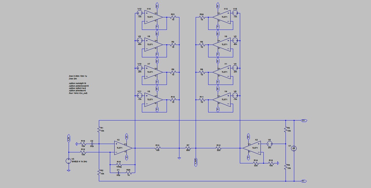

your R1,2 senses the midpoint of the floating supply which the 1st op amp moves by "tugging" on the rails through its ps pins when its output sources current into "gnd"
this inverts the sign of the gain so R1,2 midpoint provides negative loop feedback - so it should go only to 1 op amp - you can't "share" feedback in parallel op amps
to parallel output current just use the 1st op amp as the "master" and use ordinary unity gain connection parallel op amps mirroring the Vdrop of the feedback controlled output current sharing/sense resistor "A47" style
I consider 100 Ohms too large for the current sharing/sensing Rs - Cload gives phase shift which destablizes the loop, 10 Ohms gives good enough current sharing with mV offset op amps
AndrewT,
You don't get an airplane flying by adding percentages and percentages.
that's how you KEEP them flying.
Thanks for the explanation about the 1st opamp feeback path. As advised, I used the 1st opamp as the "master" then buffered it using unity gain parallel opamps. However, I don't see how to mirror the Vdrop of the feedback controlled output current sharing/sense resistor. What is the "A47" you are referring to ?to parallel output current just use the 1st op amp as the "master" and use ordinary unity gain connection parallel op amps mirroring the Vdrop of the feedback controlled output current sharing/sense resistor "A47" style
p.s. 1 : At the moment I'm using 100 ohm current sharing resistors in the simulation, but of course with better opamps and more opamps in parallel the value is going to be decreased to maybe 1 ohm.
p.s. 2 : What is the role of R5 (mid point R6/R4) in your post #17 ?

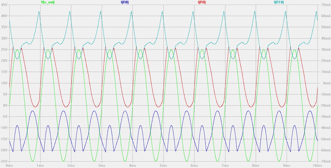

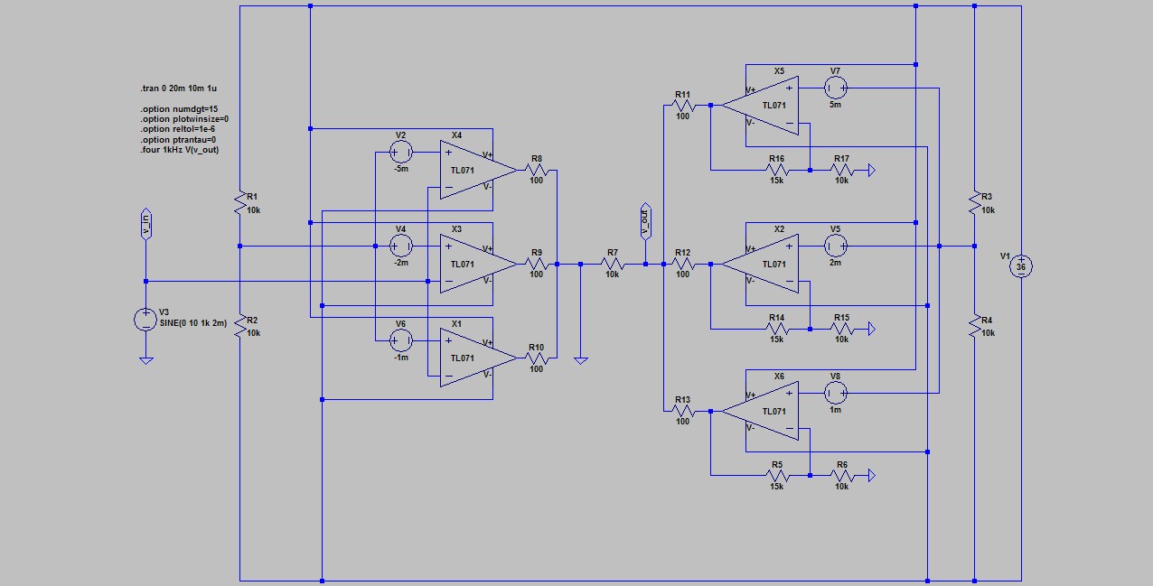

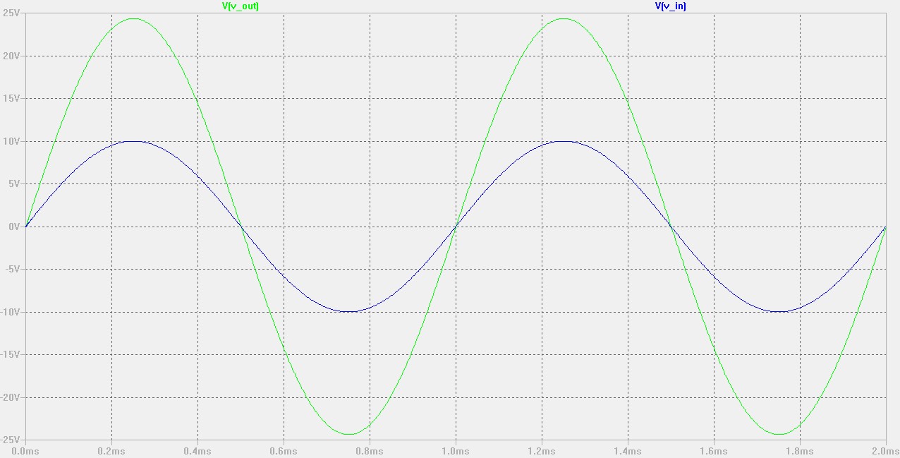

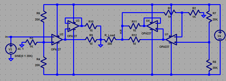

"A47" is pretty specific to headphone land but the circuit is common in various op amp app notes: Comparing The A47 and This Headphone Amp Spec'd in OPA2227 Datasheet - Head-Fi.org Community
seen in opa2604 datasheet fig 9
will be more stable with +V gain, even a gain of 2 helps
the sim below runs with Gear integration - which is known to give silightly different numerical stability in the sim vs the default Trapezoidal
maybe your transistor level op amp models will be happier
U3, R10 copies R9 current, likewise U4, R11 copies R12 current; U3,4 "slave" op amps need rail-to-rail inputs to work well in this circuit

hi jcx,
thanks a lot, I'm getting the "A47" style (bootstrapped buffered) floating supply bridge working nice on simulation using the transistor level TL071 model.
