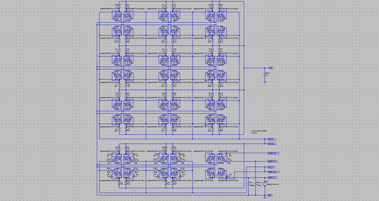

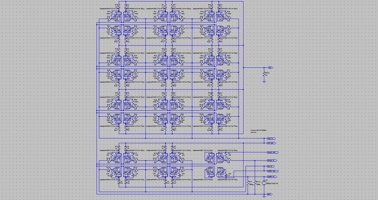

I would like to discuss the feasibility of a more advanced gridAmp delivering 9 watt RMS into 8 ohm with less than 1ppm (0.0001%) distorsion at 1 kHz. This is maybe possible using a grid of quad audio opamps in 14 pin packages like OPA1644, OPA4134 or LME49740. The 9 watt / 8 ohm signal is 24V peak peak : ((12 V x 0.707)**2) / 8 ohm = 8.997 watt. Please advise the recommended measuring equipment, being analog or digital or anything else.
For the sake of simplicity I have used LTspice to test some ideas about routing a PCB with a 3x3 grid. The grid can easily be extended to 4x4 or more. A 4x4 grid would produce the same power as the above Elektor-Self gridAmp design. I have modelled the opamps using a Laplace in the definition of a dependent voltage source. The opamp input offset is modelled using a DC voltage source in the input. This modelization is thus useless regarding distorsion. The aim of this modelization is to accurately simulate the imbalance currents caused by DC offsets and high-frequency poles differences. It also helps organizing the layout for optimizing the PCB design. Avoiding loops, keeping the layout dense, getting an untouched ultra-quiet ground, and so on.
I have generated two different approaches.
The first approach is copied from Douglas Self approach, using a grid of paralleled non-inverting unity gain buffers at the output. The resulting circuit is very easy to route on a PCB. There are almost no passive components in such a gridAmp. The big drawback is the common-mode voltage, stressing the opamps input stages. With this layout, the opamp don't deliver the best. However, with OPA1644, OPA4134 or LME49740, it could be that this simple arrangement is okay for delivering the 1kHz 1ppm 24V pp output signal into a 8 ohm load.
The second approach uses a grid of parallelled inverting amplifiers. The resulting circuit is less easy to route on a PCB. There are many resistors. They need to be 0.1% precise, but this is not an issue nowadays with Panasonic inexpensive SMT0805 0.1% resistors. This configuration is supposed to provide the best results, as the only common mode is in the optional input buffer. If you omit the input buffer, you end up with a zero common mode design. Distorsion should be minimal.
A 1ppm distorsion figure is only meaningfull if the noise floor is kept below the harmonics. For assessing a THD, you need the harmonics emerging from the noise floor. Excessive noise could thus prevent reaching the 1ppm target. In his gridAmp design, Douglas Self paid a lot of attention to noise, especially in the input stage. I don't know if this is mandatory when using OPA1644, OPA4134 or LME49740 opamps instead of NE5532 opamps.
I don't know if SMT opamps can be used. What will be the dissipation of each integrated circuit when delivering 9 watt on 8 ohm, including the quiescient currents and output imbalance currents ? If SMT opamps can't be used, we face a little difficulty as it seems that the OPA4134 and LME49740 are the only quad audio amps available both in SMT (SO-14) and through-hole (DIP-14).
If the SMT dissipation capability is exceeded with a 8 ohm load, the SMT versions can be used for trying building a 1ppm headphone gridAmp. Are there 1ppm headphones amps on the market ? Would be a 2x2 grid okay, hence 16 paralleled opamps ?
See attached LTspice diagrams.

let's assume a 3x3 grid of single opamps giving 9W into 8r0.
Each opamp sees the loading as 1W into 72r0.
That requires 12Vpk and 167mApk.
Look up the opamp datasheet and find what it says about 72r loading and about 12V @ 167mA.
Now consider that a power amp MUST be capable of providing at least double the resistive load current and preferably three times the resistive current.
Let's see if a 4x4 grid can manage that.
0.563W into 128r requires 12Vpk and 94mApk.
In to a reactive speaker we require at least 188mApk and preferably 280mApk.
What does the datasheet say about that?
Now try an 8x8 grid. I find a preferred maximum current of 91mApk.

With a 20V/µs slew-rate, a 5 MHz small signal bandwidth, and a possibly 1ppm THD, the gridAmp looks like an interesting bukding block. How to use it ?
As previously explained, with 17 Volt or 18 Volt supplies, the linearity will be preserved with a 12 Volt voltage excursion referred to ground, even when opting for the (simpler) non-inverting unity gain buffer output stage.
Say you want to be able to handle a 2 ohm load. The current is thus 6 amp.
Say that one opamp can deliver 25 mA. You thus need 240 opamps. There are four opamps in a 14-pin package. You thus need 60 14-pin packages. You may organize them in a 8x8 grid (64 14-pin packages). A 8x8 gridAmp is still very compact, especially when using SMT devices. As previously explained, the 3x3 gridAmp example is only there for showing the concept and the way the PCB layout may be organized for ensuring a clean, quiet ground.
The power on a 2 ohm load is ((12*0.707)**2)/2 = 36 watt. If you bridge the load, using four such units, the power becomes 144 watt. With a 20V/µs slew-rate, a 5 MHz small signal bandwidth, and a possibly 1ppm THD. Do you know many power amplifiers delivering such spec ? For the cooling, you may use a CPU cooler and fan applied on the grid, with or without heat pipe, with or without liquid cooling. The thermal stress gets evenly spread onto a big surface. There are no hotspots.

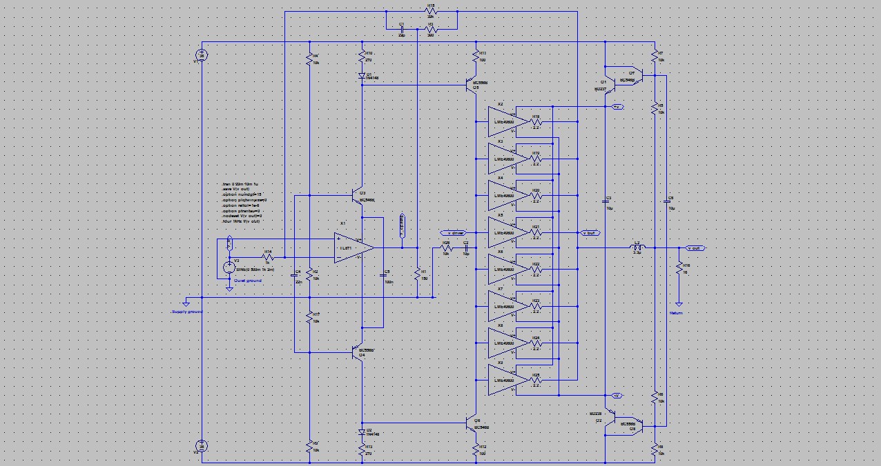

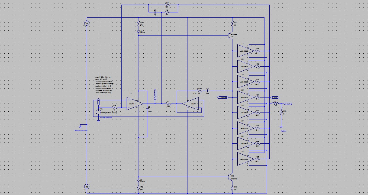

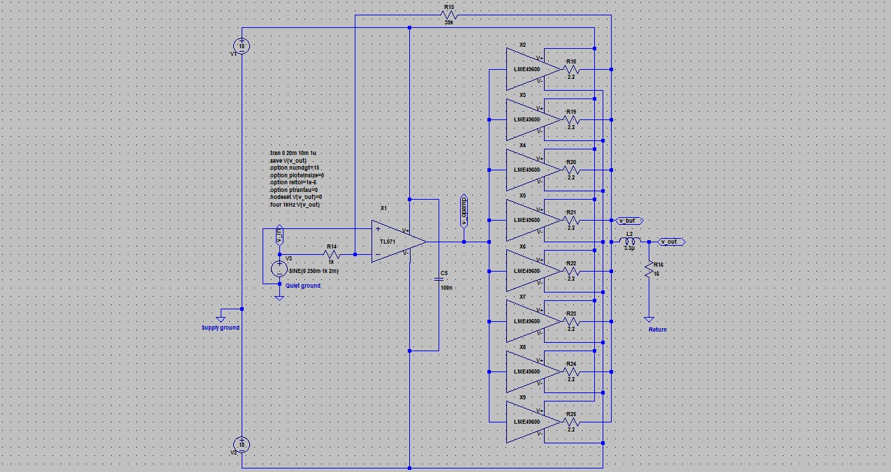

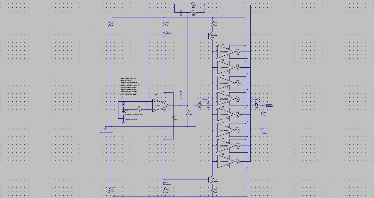

hello AndrewT, using LTspice, I just sketched a few cellAmp designs using 8x paralleled LME49600 in the feedback loop, with a TL071 as controller. I also sketched a swinging power supply for extending the voltage. Looks interesting. I also did some simulations using an ideal TL071 and an ideal OPA134. See the attached .zip.
cellAmp TL071 8x LME49600 (58.13 ppm THD) schematic.jpg256.6 KB · Views: 837
cellAmp Kuroda TL071 8x LME49600 (2.89 ppm THD) schematic.jpg216.6 KB · Views: 791
cellAmp Kuroda TL071 8x LME49600 with BJT voltage extender (6.37 ppm THD) 2 schematic.jpg229.4 KB · Views: 410

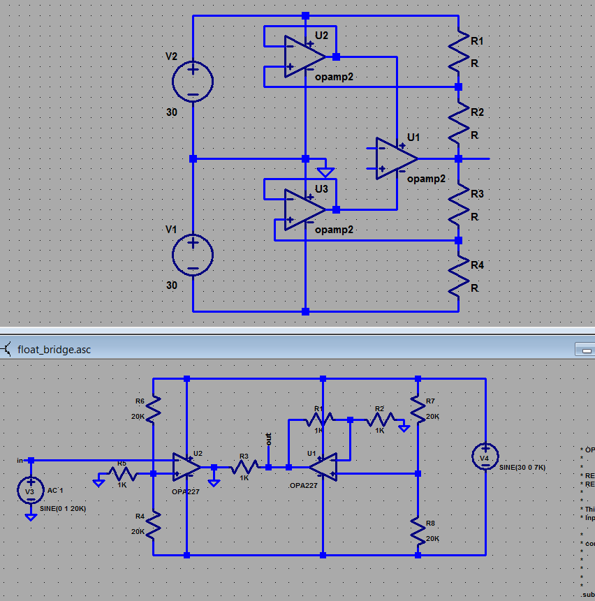

hi jcx, I just discovered your TPA6120 design. Lovely ! What do you mean by cascading them for higher drive V ?
the top is a sketch of cacading op amps for double the V swing - becomes a little complicated
the lower is a sim of one possible bridged floating supply circuit which also doubles Vswing at the cost of requiring a isolated supply (V4 in this sim)
beware of simulating these circuits - the common Boyle op amp macromodel assumes the op amp's output gain stage is connected to spice node 0
this is wrong for floating supply/modulated/bootstrapped supply op amp circuits and can give wrong indications of stable operation where additional compensation is needed

hi jcx, many thanks for your feedback.
Feel free to pickup my dedicated opamp models listed in the above cellAmp.zip file in post #15.
The TL071 model is a homemade transistor level model with accurate power supply behaviour. It is instrinsically compatible with your floating supply/modulated/boostrapped supplies.
The TL071_ideal model and the OPA4134_ideal model are homemade ultralinear models (distorsion 0.00 ppm), still accurate regarding the supplies if you pay attention to the external ground, needed as supplementary pin. Open the TL071_ideal model and you will understand what I mean.
Those three homemade models are the only ones able to cope with the Kuroda topology, using the power supply current as signal lines. They are interchangeable. Swapping a TL071 by a TL071_ideal, then by a OPA4134_ideal enables better identifying the THD contributors.

In this other thread http://www.diyaudio.com/forums/chip-amps/174540-doug-selfs-ne5532-power-amp-thoughts-anyone.html nmiljac pointed out a very interesting parallel architecture featuring moderate common mode, global feedback and symmetric distributed class A domain extension. I think I will create some opamps models using LTspice, let us call them hybrid models, having a transistor-level (BJT or JFET) differential input stage fed by a nearly ideal Spice curent source (parallel resistor), a linear 1st order lowpass VAS using a Spice RC network and a voltage-controlled voltage source, and a transistor-level class AB output stage with current limit. With no concerns for the slew-rate, for the sake of simplicity. And, possibly, accurate power supply terminals for embedding them in the Kuroda topology. This should enable better comparisons, as a starting point.
this is the Kuroda_m design. Same as Kuroda, but there is now one opamp used to generate a local ground. This way, the quality of the quiet ground greatly improves. The only connections to the quiet ground are the positive inputs of the opamps, representing very high impedances.
I was expecting getting an inflated THD figure, but this is not the case. The Kuroda and the Kuroda_m exhibit the same THD on simulation. Is there a hidden theorem somewhere ?
More research should be done, using other opamp models.
The interest of this local ground generation still needs to be assessed, comparing the Kuroda and the Kuroda_m when adding copper resistance in the ground paths. There we may see the Kuroda_m being quite insensitive to ground resistance, as an advantage.
