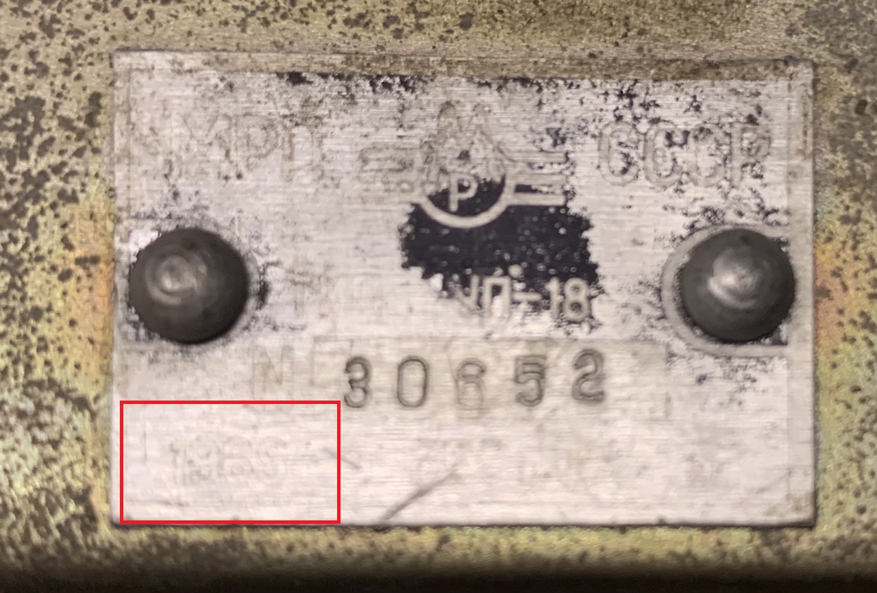

I think mine may be made in 1989 — per the barely visible plate on the radio — but i figure, just like the car itself, it was probably produced unchanged over many years.
Thank you very much! Looks right.
1989 impossible. That time the next car model, GAZ-24, was already discontinued. GAZ-21 was discontinued in late 60s.
