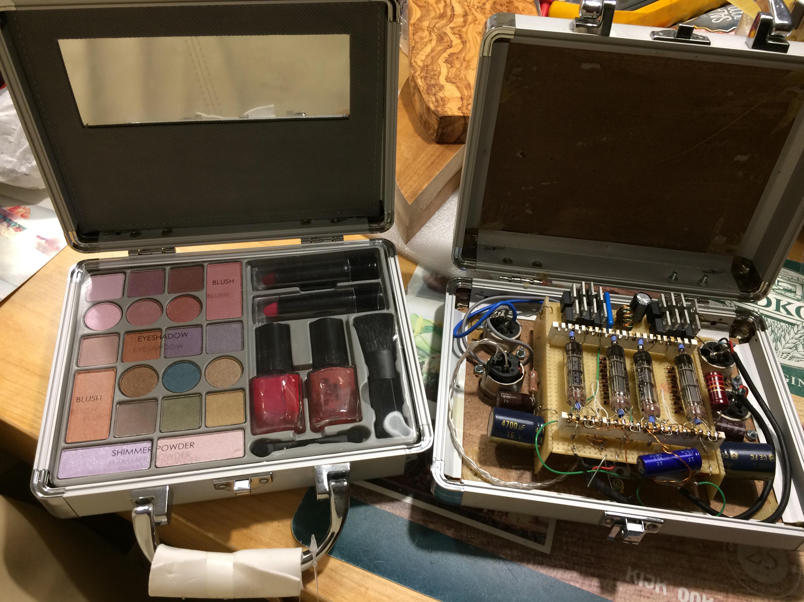

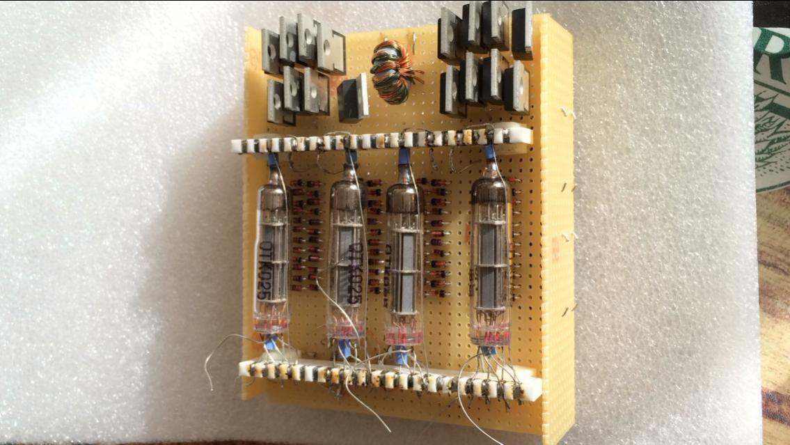

I'd guess the 1P24B would be capable of about 1W each, similarly to 6P30B.
Nice project/s
I mean, what would you need that coloured stuff for?
Nice project/s

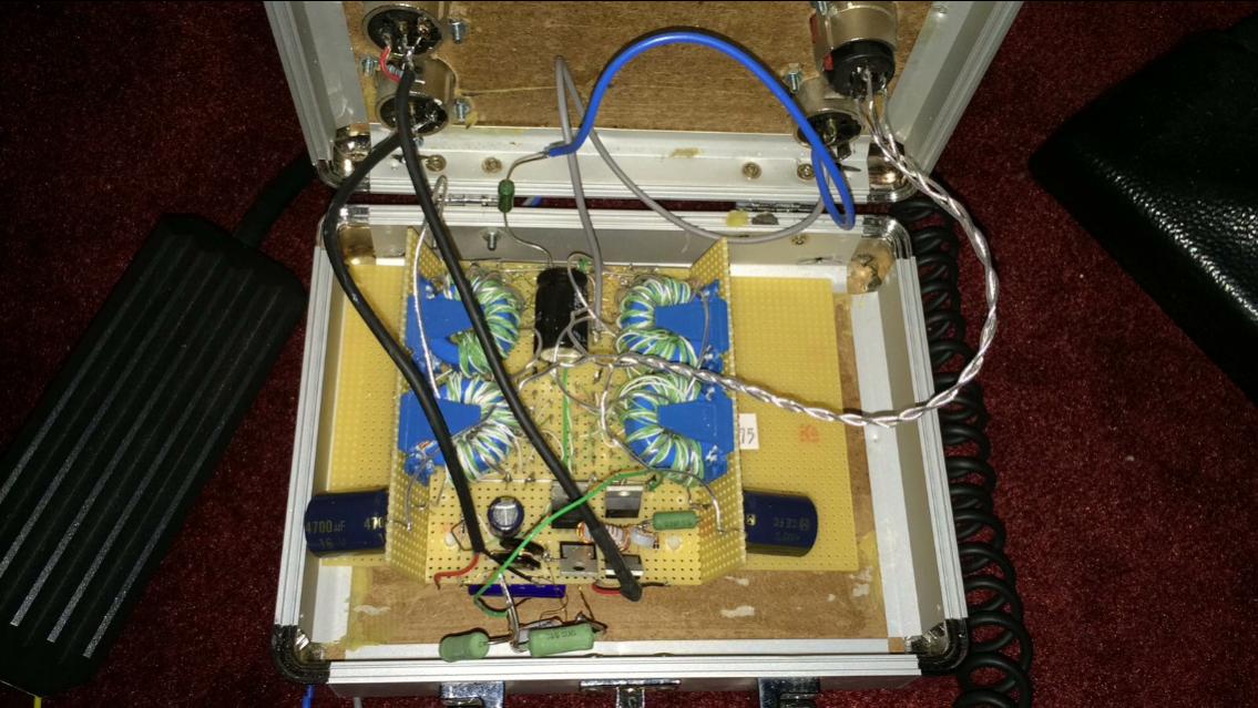

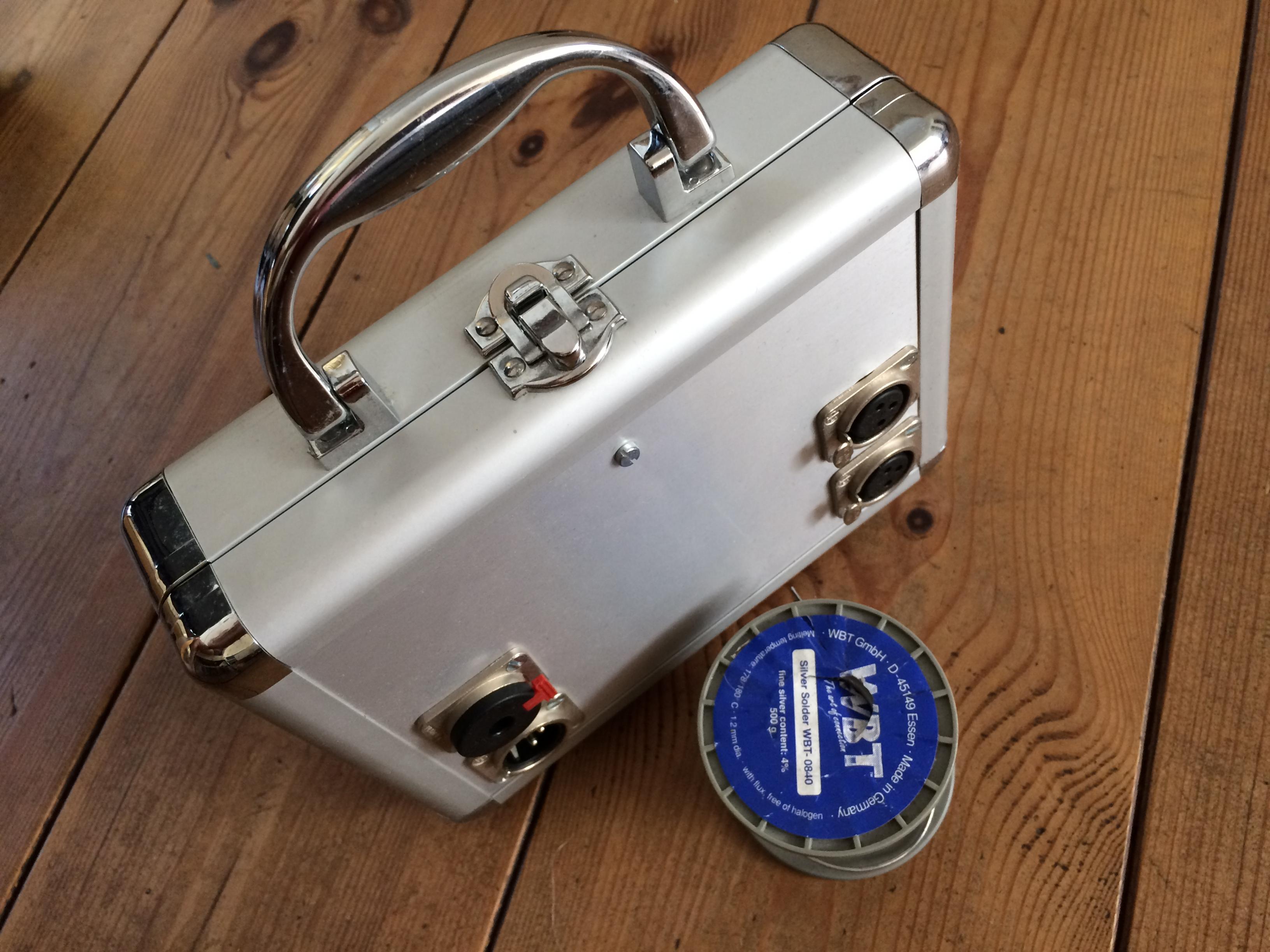

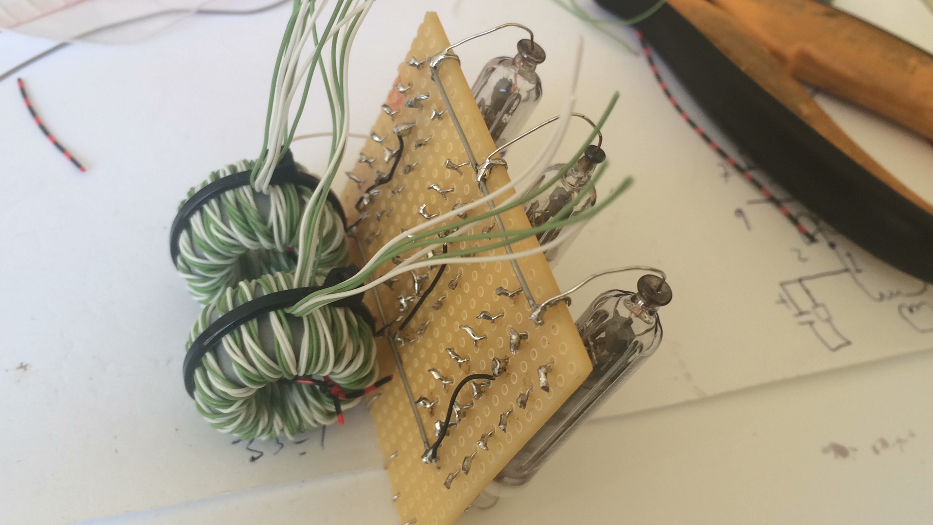

It shows the original content of the case..
The 6P30B tube could be used as well here and maybe even more powerful.

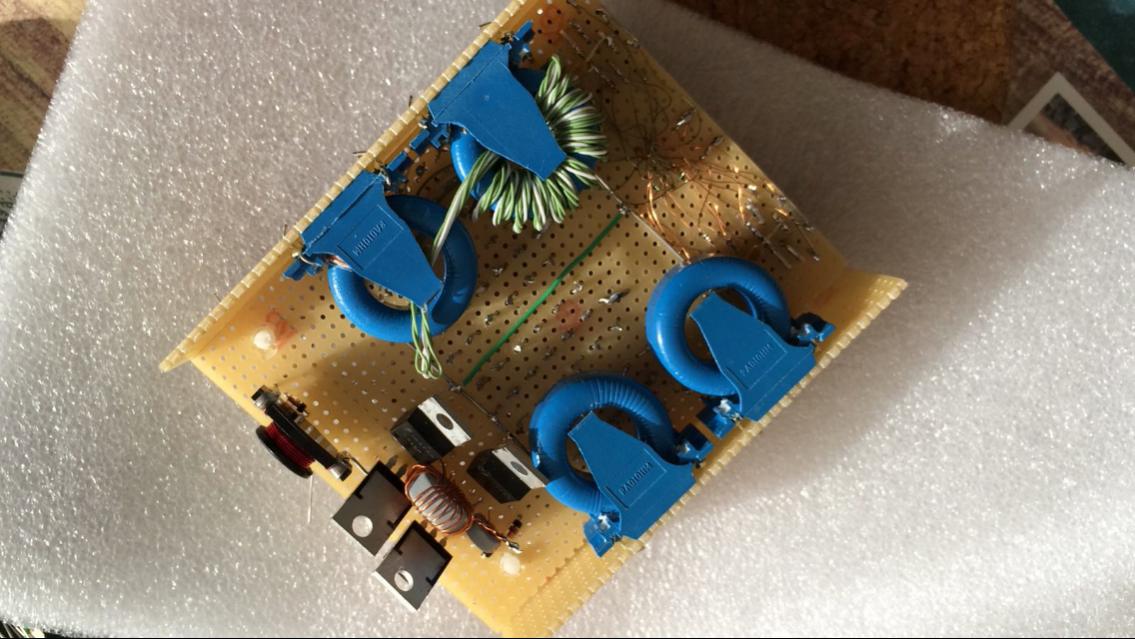

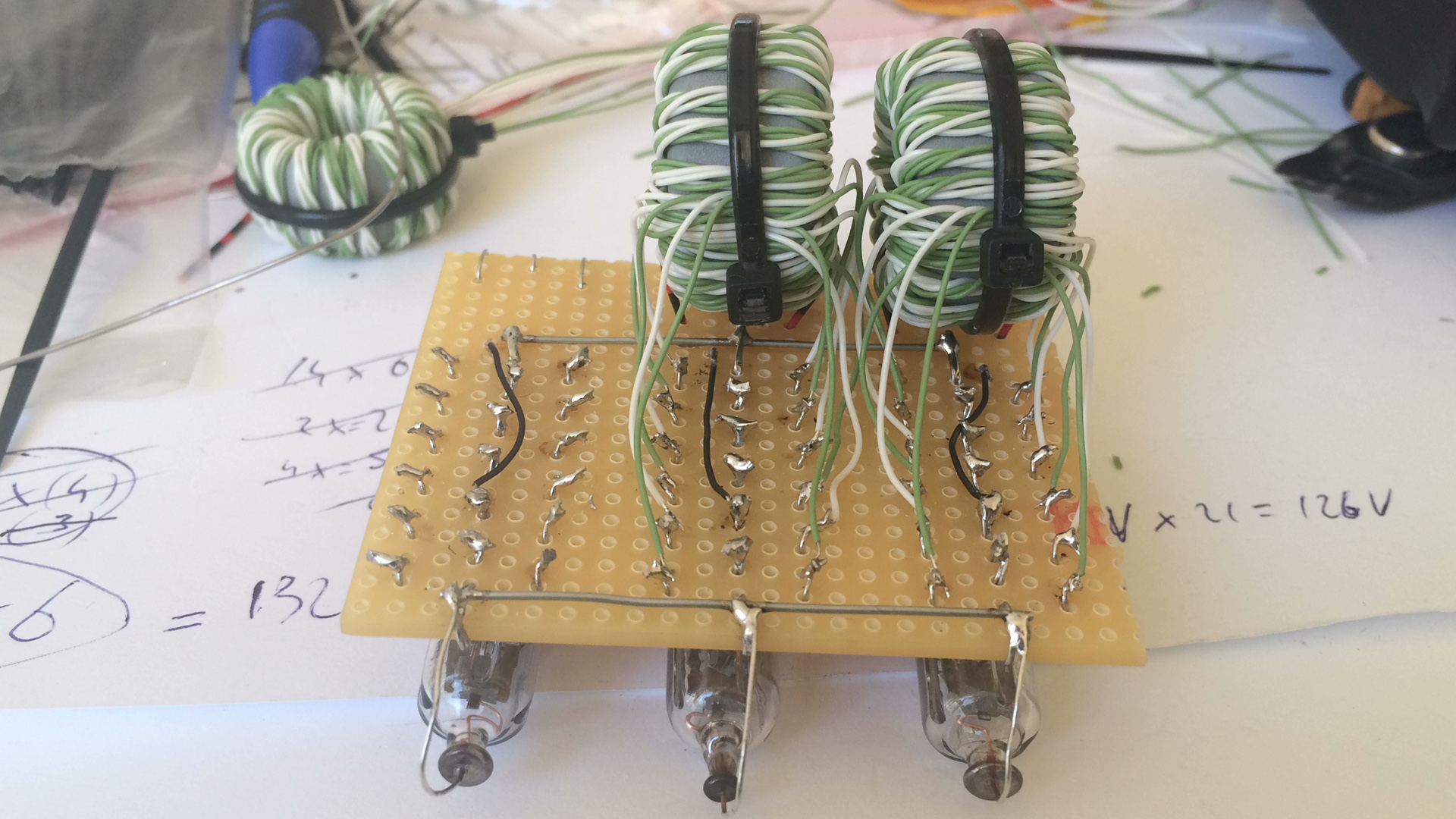

What is the toroids in the photos?
Regards
Ddimitrios
Do a search for David Berning architecture, ZOTL, in this case it is a Micro Zotl. http://www.davidberning.com/images/microZOTL/microZOTL_Manual.pdf
In these amplifiers the audio sicnal is riding on a RF carrier so that RF toroid transformers can be used for OPTs.
No schematic needed as there are only power tubes and transformers plus oscillator. Balanced input signal is required as no phase splitting is done. For the schematic check out the Microzotl manual as mentioned in the previous post.
Best regards.....

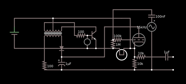

oh wow. i havent seen this thread in ages!
and i havent bothered doing anything electrical in ages, either!
but the bug bit.
and i woke up the other morning with the schematic in my head. the trick? a joule thief with a third winding, giving isolated HT (22V unloaded, sag to 15 when tubes lit) story of my life. let things stew in the subconscious for a few years... and one day it suddenly makes sense! then it takes another two weeks to find everything strewn about the shed...
cathode follower (bootstrapped high impedance input/low impedance output for piezo pickup) running off ONE NiMH.
1Ж29Б soviet rod tube. Battery powered valve preamplifier for acoustic guitar. One NiMH cell! - YouTube
feel free to criticise 🙂 nothing you say can be worse than what i can say about me!
its now on a bit of veroboard. figuring out how to mount it without drilling my guitar... as i hoped, once its reduced in size and not on breadboard it stopped hissing so bad. of course, should be even better once its shielded in a lil bit of metal. the JT runs at about 400K, so even if it was managing to get past the filter cap, its beyond audible. scope shows no ripple, anyway.
had no luck using any type of self or fixed bias other than gridleak to -neg of filament. and that -1.2 bias seems to work regardless of what loads and screen resistors i throw in there from 10k to 220k. virtually no tonal changes besides some screen compression as you get over 56k on the screen.
i was finding 47-56k gives best gain.
they are pretty microphonic, too. hope it doesnt become an issue when mounted to a vibrating guitar body...
about as simple a circuit as one can get 🙂 HT voltage is all about how the JT is wound, results may vary...
high speed diode on the rectifier. fr102 is what i had handy.
stupid simulation gets grumpy... works. then it doesnt.
reference screen to cathode obviously, 10-100k, bypass with cap to cat if you want for more bass. (pins 1,2,5 all "ground" or cathode, or nimh +pos, 4,6 and grid leak to nimh -neg.)
um. little circle on NPN base is an LED, cat to base. (lights up on backspike from base winding of inductor).
assume the bulb to be the filament.
could probably use the cat as the ground reference, and take the output from the HT neg- rail instead... lets the plug/jack switch power on then.

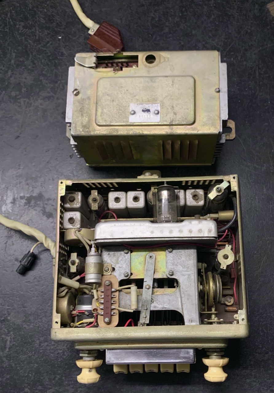

I purchased this Soviet car radio on eBay, as I was curious and the seller said it works. It has AM and OIRT band FM (66 to 73MHz). It apparently came from a GAZ Volga and pictures I saw confirm that.
Beyond that, I know nothing. In fact, until I lifted the top cover, I did not know it had vacuum tubes. The accompanying power supply (and power amp?) has transistors.
I would very much appreciate getting any info on it. Obviously a schematic would be great but even knowing it is 6 or 12V and negative / positive ground would be very helpful.

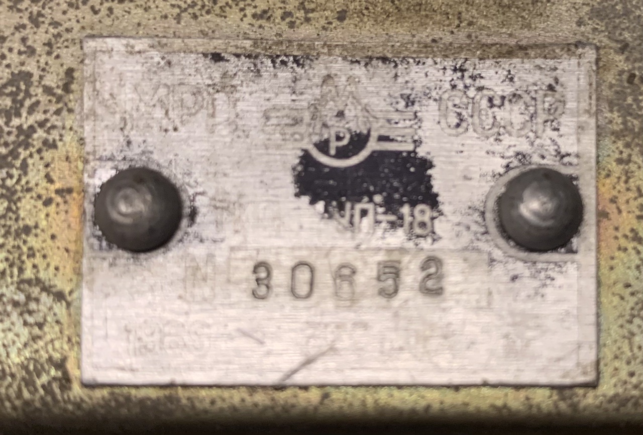

This could be your russian radio, a Murom A-18.
More information here: A-18 {А-18} Car Radio Murom Radio Works, build 1967, 12 pict
It is a hybrid, RF section has 6 tubes, AF amp has 6 transistors.
Used converter block "up-18" for anode supply, ЧП-18 label.
Preset (pushbuttons) of six fixed radio stations. Radio set for russian car VOLGA "gaz-21".
Powered from 12v with built-in up-converter to 135V.
As a guest you can download the schematic through this link : Schema Download
video: Restored Murom A-18 old Soviet Union car radio from 1967 working.... - YouTube
