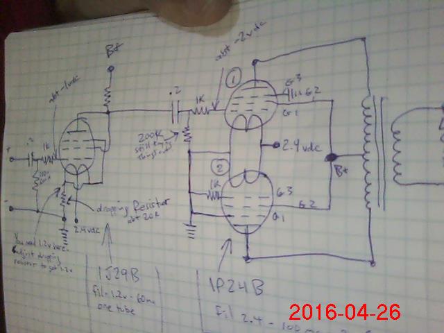

I've got a pair running pp on my bench at around 90v and it sounds great! I was just able to turn down B+ to 50v and I can confirm decent sound with less output at that voltage; no other changes... I'm driving with a 1j29b. You can bias the tube through the filament supply by using a dropping resistor on the filament cathode; ie 1.3v battery, 10r resistor... I ended up with about -2v bias for the 1p24b's which seems to be enough for a couple of watts class A.
This one's going to be a guitar amp with an extra 1j29b stage that runs off a battery. Got pretty much all the hum and chugging out of the pwm psu's. It should be small enough to fit into a small hammond box.

Well I hope you can read this,-a work in progress and I'm still messin with different values. The driver tube is 1j29b which is a nice match. OPT is a PE 4.99 special 70v 10w matching transformer...works better than some more pricey units I've tried - expect premature HF roll off but nothing to write home about. 1p24b is a nice tube to play/learn with since it's relatively low voltage.

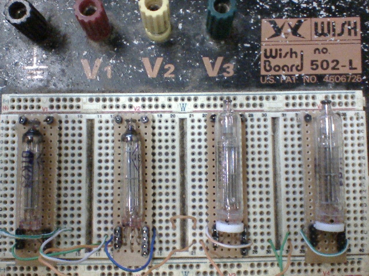

mmm, yep...these tubes dont glow, or, should i say, they dont glow in the same way as more "standard' tubes.
if you hold them in the dark, and peer inside very closely, you will see a dull red glow in there. just dont expect them to light up like el84's...
very hard to get a decent pic but hey! thats both filaments!
it was already mentioned, with your shown schematic, you need 2.4v.
btw... its far easier to work with them if you mount them on veroboard, make little boards you can then plug into a breadboard or solder to. the wires are delicate and dont appreciate too much bending around. once broken (usually right at the glass), a perfectly good tube is to all intents and purposes, a dud.
i had a single 1j24b from an ebay guitar preamp that did exactly that before i got around to veroboarding it.
sure, theyre cheap and readily available, but stocks wont last forever!
ive got 2 1j29b and 2 1p24b setup that way, they all fit my 8-bay breadboard very nicely, perfect for experimenting.
yes, i only have the filaments wired up for photographic reasons.
would you believe ive had that board for several years and this is the first project ive actually USED it for?

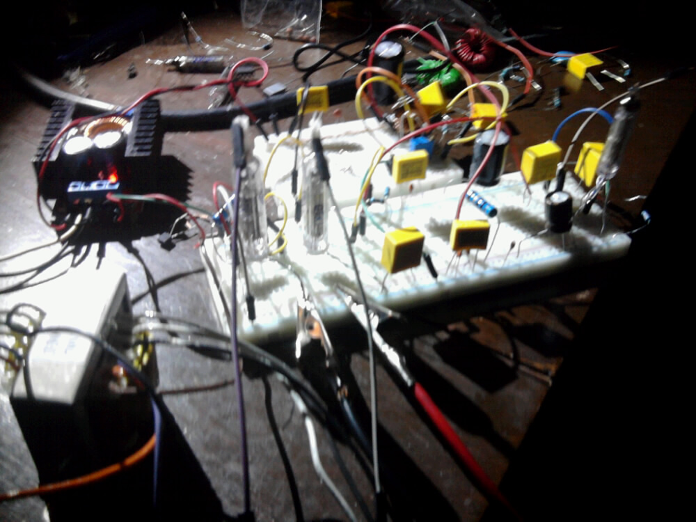

update. blew my first 1p24b. oops. accidently touched a filament with my 12v PSU as i was fiddling around. wee, did it light up! still worked with only 1 filament...but i want full power. so thats one tube down. glad i bought 10.
anyways. wired it up with a fairly standard setup, 500k grid, 10R to G2, 1.2 v across both filaments, taking both f- to ground.
60V supply, 1k:8R OPT (largest ratio thats small enough to plug into the breadboard), and with or without any bias (just another nimh for now, though i did experiment a bit and found values between 1.5k to 3.9k from f- to ground helped) i got quite a nice output when fed with my signal source of 3v. read about 1.5v on the secondary of transformer, and surprisingly loud through a 6ohm speaker.
taking G2 from anode to HT+ kicked volume up a fair amount. as expected.
now im just about to try using another transformer(CT600R:8R, or 3k:3kCT) as phase inverter, i really dont want to have to use yet another filament battery to use a 1j29b as a cathodyne PI. but will also try that. obviously for a PP output on the 1p24b's.
already looks like i will be using at least 4 batteries for this thing as it is... 2 different bias, power supply, filament heating...ARRRGH! but what else will work for a battery powered guitar amp? at least the bias ones dont need replacing too often.
just waiting for my 150V boost converter to arrive. i want an earsplitting 4W output!

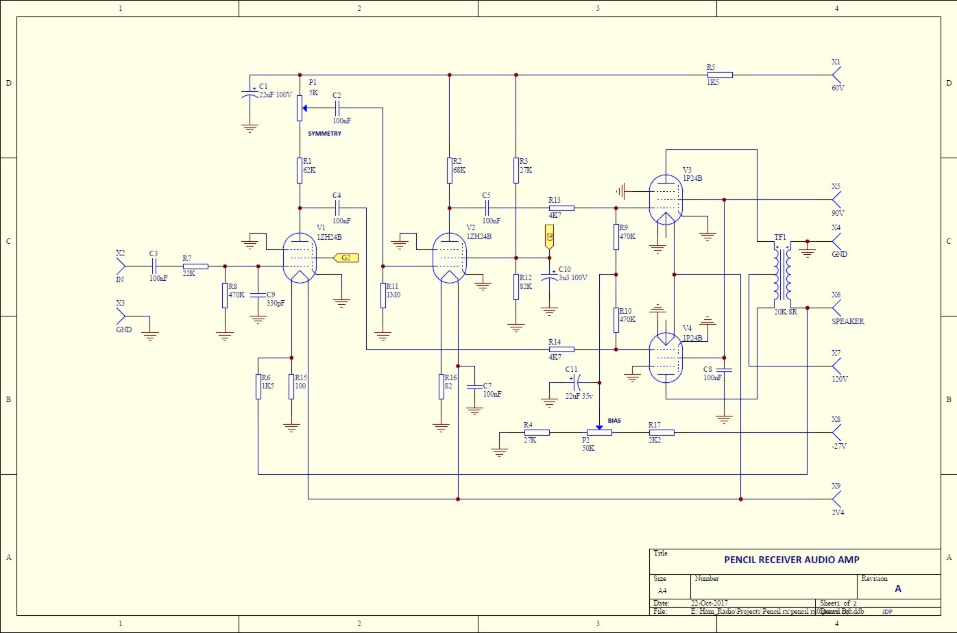

alwineden,
Self splitter push pull requires the DHT filaments to be returned through a current source to ground (or at least through a common resistor to ground).
You made the filaments return directly to ground.
The top pentode is doing all the driving of the output transformer.
The bottom pentode is a constant current source, but your circuit is not push pull.
I wouldn't recommend using the pair as a 'self' splitter'. If you use a current source, you will need a floating heater supply. I used this idea in an AGC loop amplifier (where I needed to be able to adjust cathode voltage independent of heater). In any case, common screen currents upset the equation (as the screens draw more current as the anode approaches 0v, but do not drop to zero in the other direction!). I used another pentode for the inverter. Yes, it is ugly, but preferable to using a transformer!

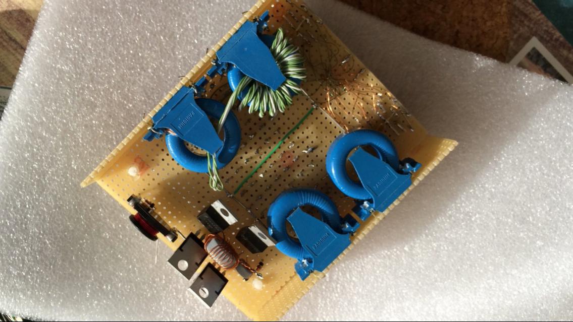

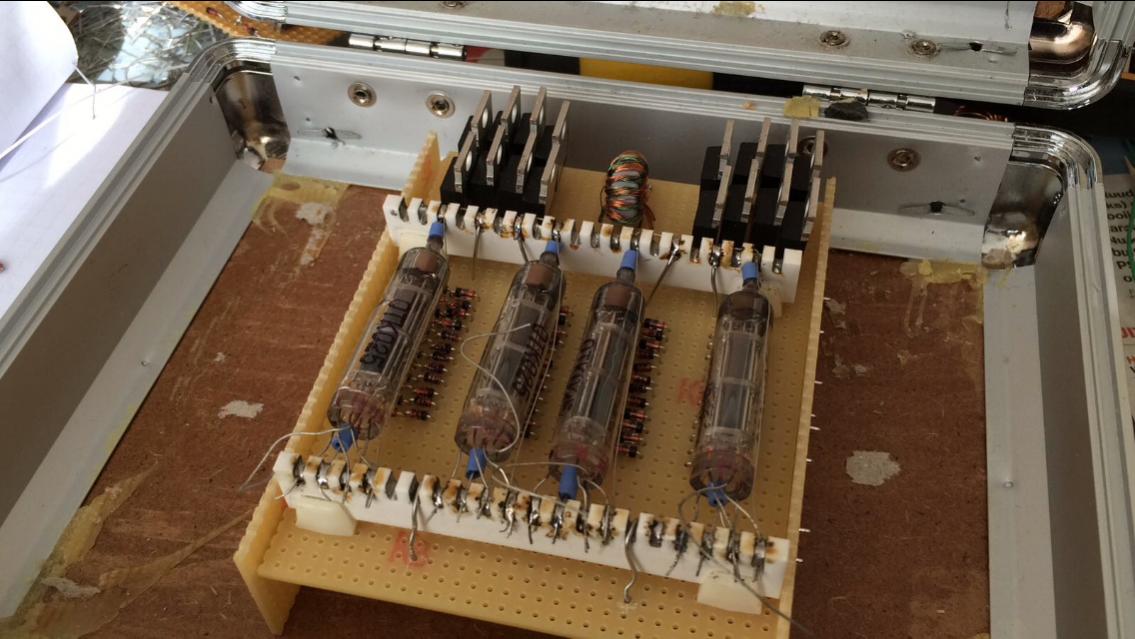

I have build a small amp with these as well using a David Berning circuit.
With this i do not need any output transformers as such.
I derived it from the "MicroZotl" schematic.
