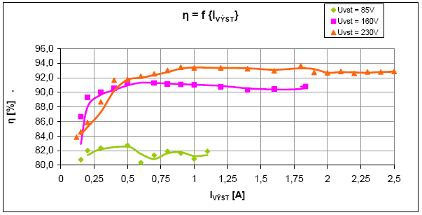

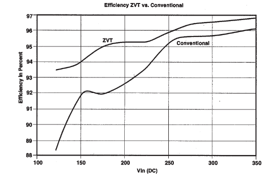

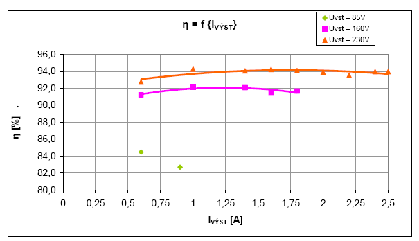

Recently I have finished my bachelor's project - 1kW active boost PFC with quasi resonant switching, controlled by UC3855. I have not used the exotic Saturable reactor (core available only from Toshiba - MS or MT type). Instead, I have used the resistive damping (44ohm 10W resistor with MUR1560 in series, from ground to ZVT switch's drain). The efficiency we measured was about 92% at 230V line voltage. Efficiency was constant from about 30% to 100% load, lower at lower voltages and loads. The ZVT diode and ZVT switch were heating the most, main switch was almost totally cool (heatsinks with about 2,3K/W for mosfets, about 6K/W for main and ZVT diode), we think it was caused by the presence of full input voltage at ZVT switch when switching on (would be reduced by saturable reactor) and a too fast -dV/dt at the zvt diode anode (because current to load flowed through it until ZVT switch turned on - this would be also removed by saturable reactor).
When we removed the ZVT circuit, the efficiency IMPROVED by about 2%, everywhere.
From this I have concluded that this circuit needs the Saturable reactor to increase efficiency against non-resonant operation
The power factor was, however, very good - above 0,98 at loads >30% and was not influenced when we removed the quasi-resonant circuit.
So if you folks will ever try to design with UC3855, you will, most likely, not gain efficiency without the utilization of saturable reactor.

That 92% efficiency figure seems a bit low for 230 AC line. Have you carefully measured every bit of energy ? At high line volts using the SGS L4981A and hard switching, I'm getting repeatedly 95-97% efficency rate using an IGBT at 100KHz. Although my design isn't for 88-120VAC, the low line 88V AC is a sure efficency test for any SMPS boost converter..(The IGBT is lossy at low line)
You may find the ZVT reactor will recover the 2% efficiency at low line volts. Again, have you done precise measurements ?Otherwise at high Vin, it's hardly worth implementing it and it certainly shouldn't be sucking valuable efficency..What operating freq are you using ?

We used 250kHz, that's because we used that ZVT circuit which should minimize switching losses so we are able to increase frequency and reduce inductor size.
No, there are no measurement errors. But it was hitting 94,3% at about 300W output, at 1kW it was 94,0 (see figures). But it must be said that we did measure the input power BEFORE the mains rectifier, so the rectifier losses are counted in the overall efficnency. The rectifier power loss at full power was, by simulation, about 20W at 350Vac. If we would measure the input power AFTER the rectifier, the efficiency would be higher by about 2% which is in good agreement with the measurement made by Texas Instruments in UC3855 app. note (slua146a) where they measured the DC input power and got about 96% efficiency with similar measurement conditions (see figure - "Conventional").
So how are you measuring the input power? Are the rectifier losses accompanied in your efficiency calculations?
