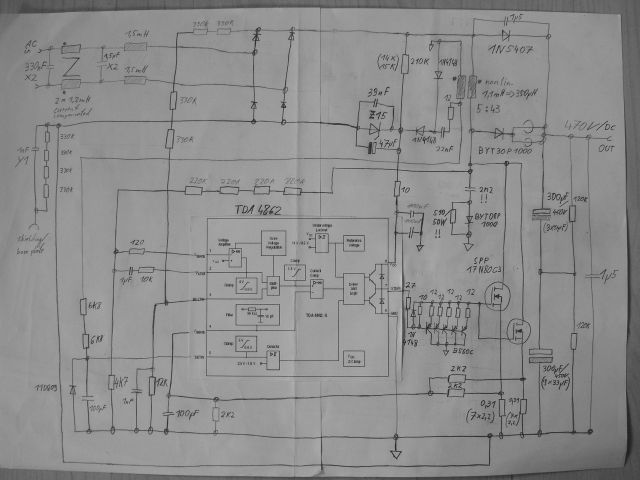

But I am not so lucky with my snubber losses.
The CDR snubber (C:2n2 , D: BYT08P1000, R:500 Ohms) looks
nice in schematic and is working fine in reality, but the losses.
...especially at low power loads...
...at 200kHz this snubber will make losses of
P=200kHz x 0.5 x 2.2nF x (470V)^2 = 49W.
:bawling: :bawling: :bawling: :bawling: :bawling:
I already tried some variations.
- smaller snubber cap:
Well, high du/dt causes two drawbacks. EMI issues and additional ir
directly can disturbe the PFC chip itself. In the beginning I was working with du/dt up to 30kV/us.... Don't ask ! My radio made more noise than music, laptop ignored its touch pad....
This happens only at high loads, because then the current in the MosFets goes up to 12A and these 12A are forcing the sloping speed of Vds during MosFet turn OFF.
The reverse capacity of the MosFets is demanding quite a low driving impedance to and I had to implement the five BC560 to drive and decouple these beasts from the PFC chip.
The snubber with 2.2nF now limits the sloping speed to about 5kV/us. Which is fine for proper operation and also for my radio and all other stuff I am using here...
I also tried to reduce the switching speed and save the snubber, because the MosFets could easily handle some turn OFF losses.
a) ..by a higher driving impedance, but I got some turn OFF oscillation around 10MHz.
b) ..by a well damped RC-feedback from drain to gate, also this
resulted in inconvinient turn OFF oscillations at high power load.
OK, I hoped that I could at least use some of the snubber energy for the chip supply... , well the snubber pulses caused some irritations to the chip and the detect signal was not detected proper anymore....
Hm, now I am thinking about some resonant "lossless" snubber, but
my brain did not come up with a proper idea up to now....
(...typically running into demag issues already in theory.)
Good ideas are welcome. Sorry for the poor quality of attached schematic.

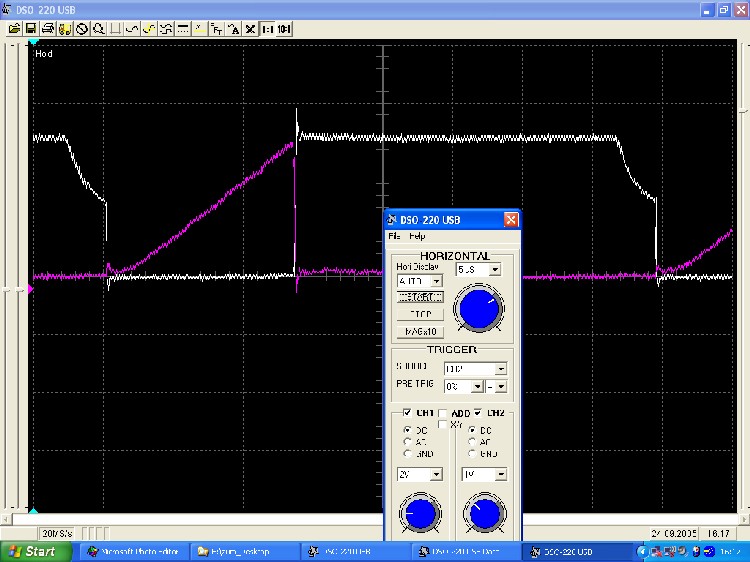

Hi Eva: Yes, that fast slopes were crazy. I did not expect such a speed. But look, an inductor that forces ongoing 12A ...
...just some pF of parasitic capacitance cannot slow the resulting
sloping speed...
Now with the snubber it takes approx. 100ns to shoot from ground to 600V . At home with my cheap USB scope at home this are just some single dots.... and some further precision drawbacks of that 200EUR toy.
But I don't want to borrow all the things from work.

At home with my cheap USB scope even the snubbered 100ns slopings are just some single dots.... and some further precision drawbacks of that 200EUR toy.
But I don't want to borrow all the things from work and if you know some principal behaviour, then even a toy with a sampling rate of 20MHz and scrabby internal amplifiers (only 5MHz) and
not perfectly adjustable probes... well, still such cheap home equipment is sufficient to get most things running.

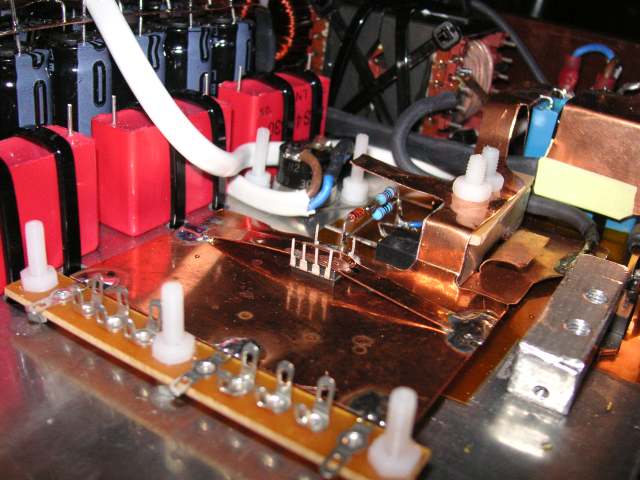

This picture shows the heart of the power stage. The power devices
are mount on a aluminium base plate. The base plate is isolated but
HF-connected to GND by 1nF (please refer to the schematic, where
“shielding” is mentioned.) Unfortunately the capton isolation looks quite similar
as copper and makes it harder to understand the construction from the pictures.
MosFet drains directly connected with 0.3mm copper foil
to the PFC diode. The cathode is again directly connected to foil
of the positive rail. The foil is splitted and carries the ferrite beads.
Below the foil of positive rail you can see the film cap.

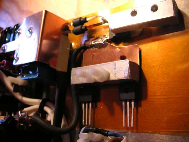

Next step is the GND foil. It is one origami foil that connects the film cap, the e-caps, the MosFet-source-resitors and the signal GND. Signal GND is the large copper area and no high currents are fed into this GND area. The signal GND foil carries the PFC chip, which is pressed with an additional GND strip onto the GND foil. ==> improved heat dissipation and optimized GND plane design in one step.

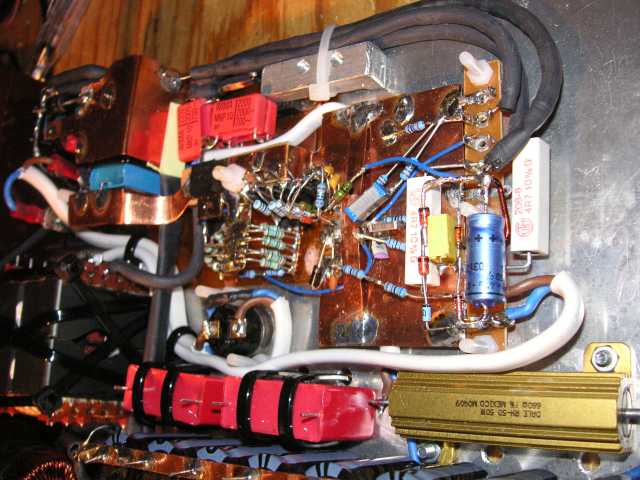

And now things are coming ugly for human perception ...all the small components in a three dimensional P2P set up....

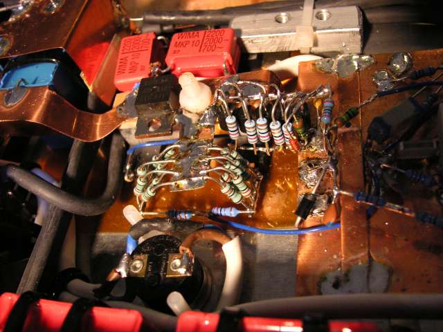

You can see the source resistors (light green) providing the shortest connection to PWR_GND.
Behind the light blue resistors you might find the 5 PNP drivers for the MosFets.
And the snubber cap (consisting of four WIMA MKP10 2.2nF/2000V) coming from the drains and connected to the snubber diode which is directly soldered on the top of the PWR_GND.
Here you can also see the discharge resistor of the snubber. The length of its connection is
uncritical (more or less...). In this set up the max. operation frequency at approx. 15W output power is around 100kHz and the snubber losses remain acceptable.
The three black sleeves carry several serial connected resistors, such as the 14x15k etc.
The sleeves are triple layered.

Improvement of gate drive: With the previous 27 Ohms between Chip and PNP driver was still some ringing at full power. It was clearly measurable that the output of the chip did not ring, while the base of the PNP already showed slight ringing and the MosFet gates again worse. Now with 10 Ohms this is fine and also the voltage and current wave forms of my MosFets are looking alright even at full power.
The white trace is the Drain voltage vs GND, 200V/Div.
The coloured trace is the current: 6,4A/Div.
Time base: 5us / Div.
