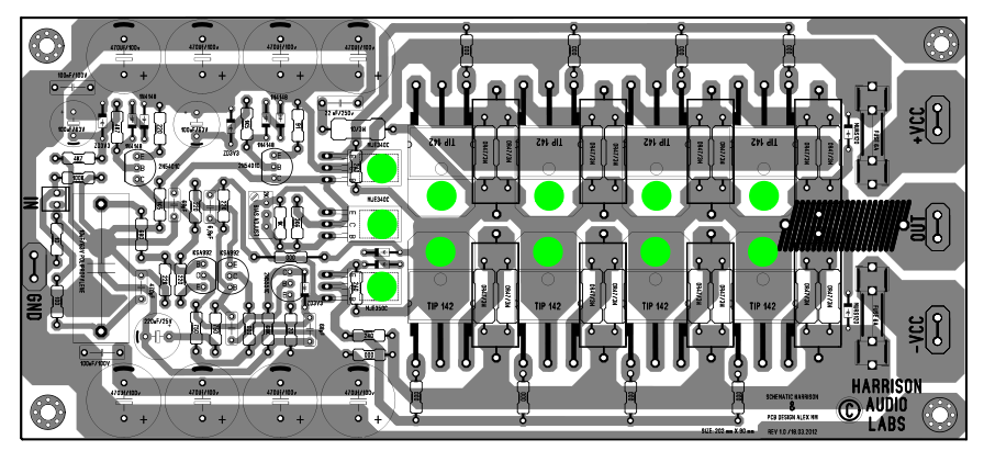

Hi Toni,
Here we go. You will need to get some spice libraries from the respective manufacturers websites as they hold copy right. On-semi Fairchild etc
kind regards,
Harrison.

Hi Alex. Remember this.😀 Your quite the crafts man
  • PCB HARRISON ALL GREY.pdf

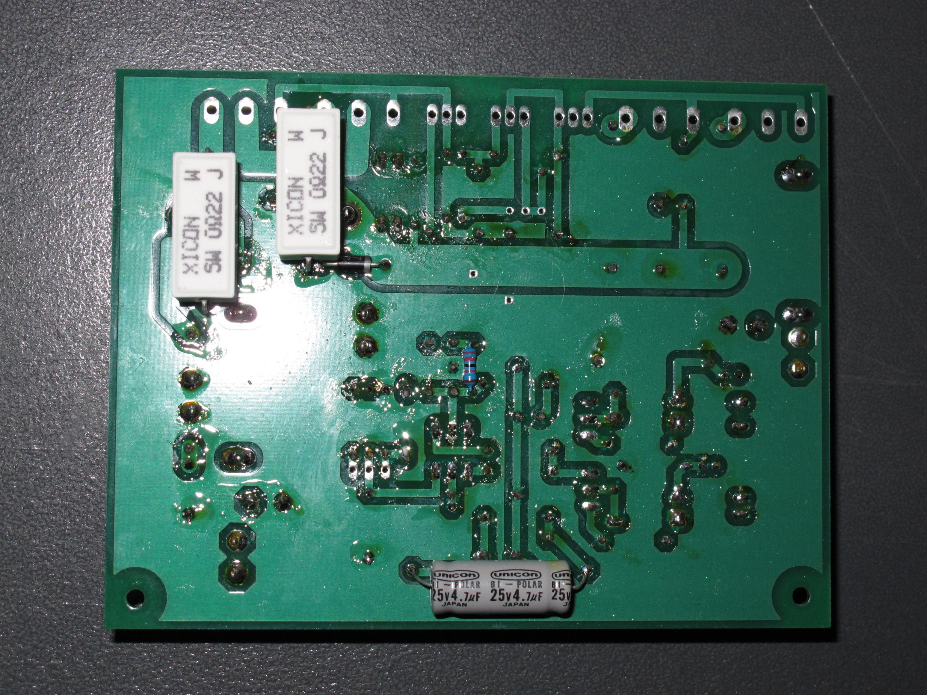

Progress...
Almost fully stuffed, save for the MPSW42. Local retailer didn't have that and I'm not too keen to order the two I need from my regular sources due to shipping costs. It might run the 2N5551 a little hot but is it a passable substitute? Any other suggestions for the MPSW42?

Hi Jason,
Beautiful.😀
The 2N5551 with some sort of heat sink will work. Try to get the MPSW42 though😉. Will check for alternatives, the last time I did that was one year ago🙂. Might find new transistors on the market.
kind regards,
Harrison.
Hi Jason,
Looked around for substitute. Not much has changed in the last one year concerning transistors. There were new types but the case style was more surface mount.
You could use BD139(but ensure the rail voltage does not exceed +/-40), MJE340 etc.
kind regards,
Harrison.
Service Note
The 2N5551 (with heat sink) and MPSW42 need to be checked for replacement when servicing a blown out output stage.

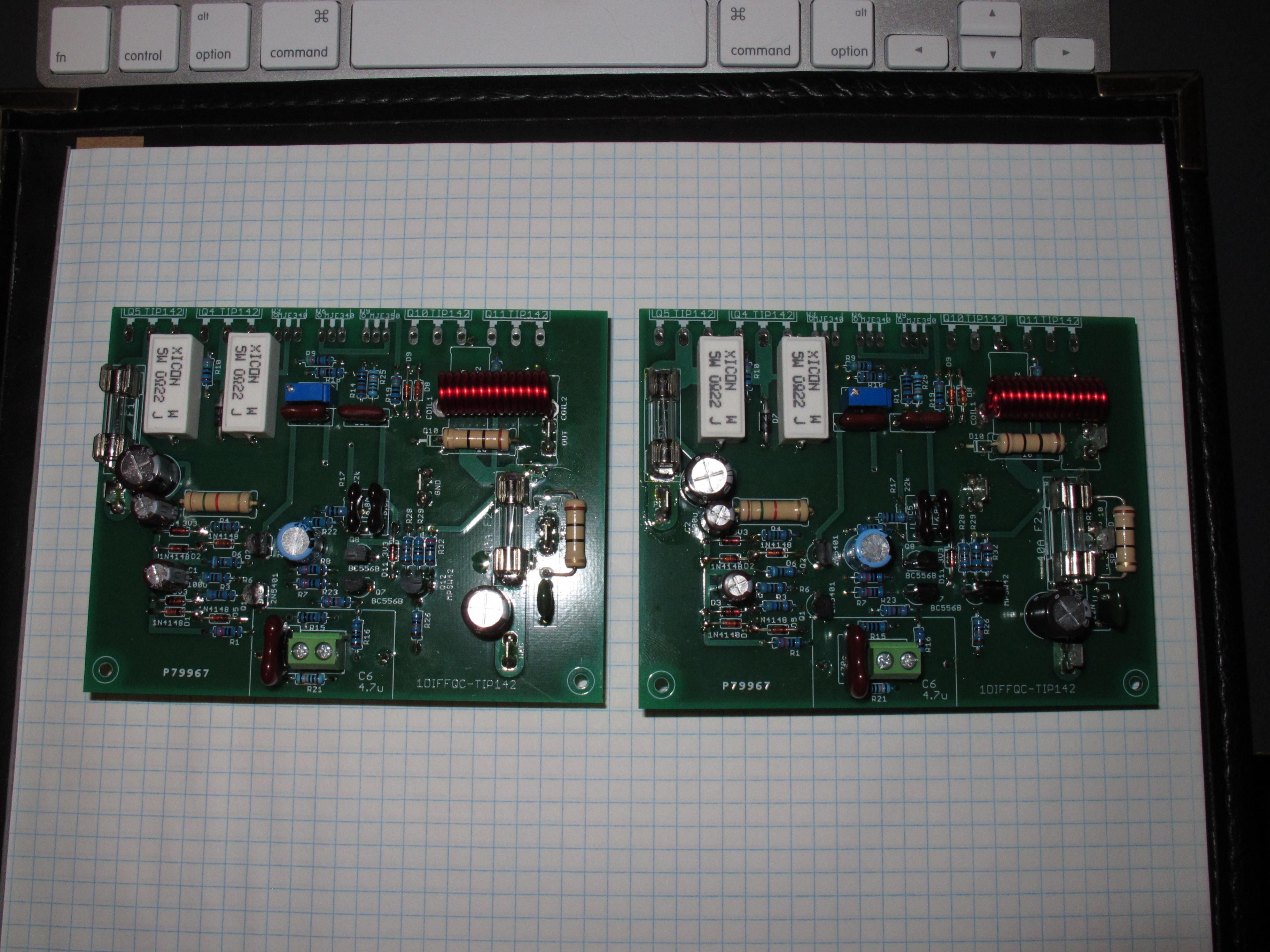

Well, thanks to the kindness of Harrison I now have two fully stuffed boards aside from the heat sink mounted transistors which are waiting patiently for me. I just need to decide which of my available heat sinks to use and which orientation I'd like to mount the boards in.
The coils, yes I think they turned out quite nice. I actually made a mistake buying 14ga magnet wire for those; the coil leads literally just squeak into the holes. I'd suggest to future builders to use 16ga wire to make winding and installation easier.
