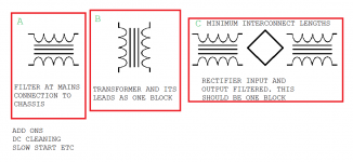

thanks so ill go with a 600va transformer that puts out 28v+-. as for that link im not sure what that attachment on your other post means.
i do like experimenting but dont want to use much money in the process as i have to buy everything.
with that said im buying this board to use as my power supply and im wondering how i should configure the capacitors on it. would having 2 larger 10,000uf caps be better then 4 smaller 5,000-6,800uf caps. i figure having the 4 smaller would allow for faster energy when the amps need it and possible better filtration. although i may be thinking about this all backwards.
That thread refers to using line filters to keep things clean and reduce listener fatigue. Very nice board. Use the 10,000uf, will attach a link of a good sample shortly.
For a few more bucks you can add two more filters and maybe DC cleaning. Its more effective than the current (ineffective) stock solution of strapping a capacitor across the bridge rectifier 🙂
