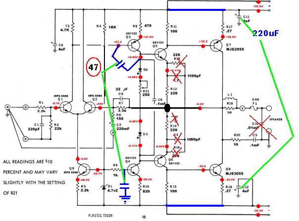

Lament for a Tiger
Tiger tiger burning bright,
your output circuit is black as night
Your front end looks great
but its the overall oscillations that we hate
They are, we fear, linked to that Output stage
and that really shows your age
For the culrpit is that common collector
that really screws the transfer vector
We see excess gain and poles galore
and then, just when we thought it safe, even more
no miller capacitor just like Doug told us
this I tell you is why there is a fuss!
So friends, lets ditch this burning design
and go for something a bit more benign.

I've got a 215/A here, yes it is like a Plastic - Tiger .01, dual diff front end, output triple. This amp needs work, anyone have a schematic scanned or know of it online?
Turned out to be one open and one shorted PSU cap, bridge also failed. Fixed all that, it is otherwise fine.
Decided to take a look at the stability and tendency to blow up when the input jacks are inserted or removed hot. Brought it up on a Variac to about half voltage so that the outputs are well within their SOA. Tapped the input terminal with a screwdriver, then with my finger on it. Syncing the scope on the hum, I see about 2 volts of hum on the output, however, there are slivers where the output goes rail to rail. I believe that it is oscillating.
Next drive it with a square wave, then into clipping, the tops and bottom of the square wave become about twice as thick with fuzz on them when in clipping. I believe that it is oscillating here due to the reduced OP stage bandwidth in saturation. I can also see odd behavior on the edges of the square wave, and looking at the VAS I also see bursts of oscillation.
Considering some mods to the circuit to correct this, difficult to do given that there does not seem to be any "normal" method of compensation used in this design.
Anyway, anyone have a schematic scanned to make this a bit easier? I have the Tiger .01 schematic and it is very close, but it would be better to have the actual.

Has anyone fooling with this topology tried the combination of adding the normal Miller compensation and the taking the lead comp from the output of the VAS instead of the outputs? With other high-feedback topologies it has woked well for me resulting in very stable amps. Some of which get used in pro apps where I do swap them hot.

wg_ski said:Has anyone fooling with this topology tried the combination of adding the normal Miller compensation and the taking the lead comp from the output of the VAS instead of the outputs? With other high-feedback topologies it has woked well for me resulting in very stable amps. Some of which get used in pro apps where I do swap them hot.
I am considering this but I'm not sure that it is worth the time and effort. I do want to take a closer look at the simpler Universal Tiger, not the .01.
