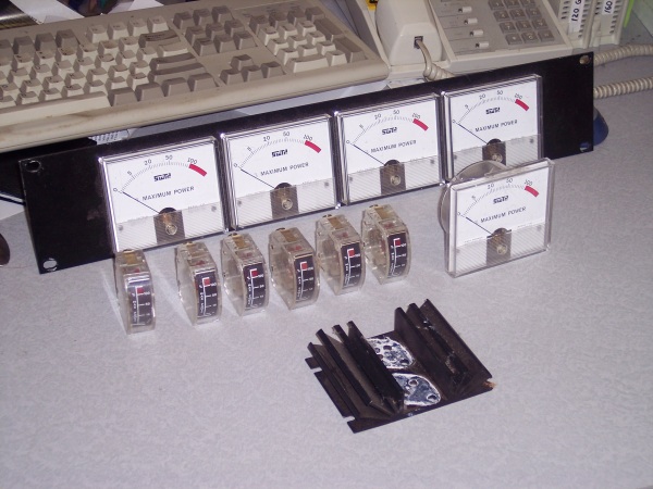

Just to provide a blast from the past, I remembered I had the VU meters from the tigers and the 215's in a cabinet...so here's a pic...the tigers are the biggies, the 215's had the edge meters.
Ooooh, where's my manners. The heatsink is from the tiger, it was one of 8 per amp (so I was up to my ears in them). Half were drilled mirror image, and were mounted inside the amp case (where their sole purpose in life was heat capacity.)
The tigers had a bulb with a green plastic cover to give green illumination, they charred within a month..
I don't know where the other 3 tiger meters are, but I'm sure they'll pop up someday..

btw...the meters were rather robust...I was able to use the slap of the meters on the right side of the unit to guage the loudness...biamping hides so much...

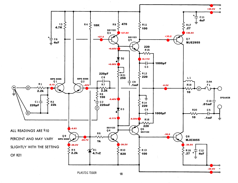

The provided transformer for the Plastic Tiger was 42VCT at 2A, and gave about ±30V rectified and filtered. The 40V listed in the magazine article is a misprint.
The safe area of the MJ3055/2955 is 90W at 30V, or 3A. This would be a 90° load line, a pure capacitor. A real load would not be this bad. The pair of amplifiers would have 360W of safe area at room teperature, and the transformer was only 84VA. Not too shabby in my book.

SS1122 may be replaced by a BD 138 and SS 1123 by a BD 137, which avoid using of the small (imho, nasty) heathsink for old TO 5 case. In the schematic voltages are missed. My advice is to limit to a +/- 25 Volt maximum.
There is also a wasted opportunity in the schematic (of, pherhaps, a plain error in drawing... I don't know): connect R11 and R13 to the output devices PSU and connect the second PSU directly to the VAS and input section. This separe the amplifier in two distinct section as should be (imho).

Here's what I would do:
1) Add emitter degen resistors to the LTP. 220R would be good enough, given the 2.0mA tail current.
2) Replace the 4.7V Zener with a couple of red LEDs, reduce R4 to 12K, and reduce R5 to 2.0K. LEDs are quieter (but they didn't exist in 1971).
3) Consider replacing the bias resistor and diode network with a Vbe multiplier.
4) Consider replacing the Sziklai pairs with full complementaries. Even though Sziklai's are supposed to have better sonics, they can be unstable. Not sure the difference is worth risking blowing something up.

Mine still work (with their original TO-127 3055/2955).
Tens of thousands of a similar amplifier were sold with the TO-220 version of this output that put out 50W into 4 ohms.
Even more of the bigger brother that would do 75W at 4 ohms from a single pair of TO-220 2N6488/91.
The basic design seems sound.

Plastic Tiger Schematic with Voltages
I just found this forum recently and it brought back many fond memories of building and hoping.
I built the Plastic Tiger from PE back in 1972. It took awhile to gather all the parts locally, however I had to get the SS1122, SS1123 from SWTPC. I built twin 30V+/- supplies as per the article design and housed the assembly in an old fridge tray made of aluminum with giant heatsinks screwed on the back for the outputs and biasing "diodes".
I was using a Dynaco PAT4/ST120 combo at the time with my AR 2ax speakers. After listening to both amps critically I unhooked the St 120 and never looked back.
This was my main sound system for about 15 years until it got replaced and retired to the shop where it has been running for the last 15 years continuously 24/7.
Amongst my collection is this schematic with the voltage test points that was published by SWTPC.
Thank you to the poster for the magazine scans as I failed to find my treasured dog-eared original copy.
By the way I "smoked the first set of SS's by hooking up the biasing diodes backwards. Imagine the teen angst at the wait for replacements from Texas to Vancouver.
I have loved the performance of this little bugger for these many years. The little plastic tiger gets to spend his "golden" years driving an old original pair of Dynaco A-10s spoonfed by the PAT-4
I just might try to build another one with the transistor substitutions. If anyone has suggested mods that I've missed maybe someone could reference this diagram for modification locations.
Thank you all for the contributions
G
ps: I hope the attachment worked
- 1971 Plastic Tiger
