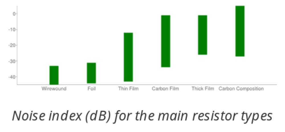

Searching Digikey from the left side of the pond must be much more difficult than from the right side, since it took me about 10 seconds to find these:
MOX5002002GSE Ohmite | Resistors | DigiKey
This is thick film, 6 or 7 more wirewound types, 3W and 5W.
Thick film are not recommended for sensible audio.
Thin , foil, wirewound is better quality.
