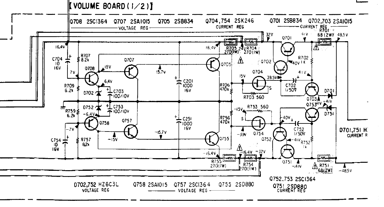

Hello safesphere,
I think if I were in your shoes, I might buy a power transformer with 18VAC or even 20VAC secondaries. Then I think I would probably build a cascade of two voltage regulators in series. There's plenty of voltage headroom to do this: 18VAC + Schottky rectifiers gives 24VDC raw. Let the first regulator have 2V in-to-out and let the second regulator have 4V in-to-out. Then: 24V --> reg1 --> 22V --> reg2 --> 18V
The only objective of the first ("upstream") regulator is to reduce ripple and create a much cleaner supply for the second ("downstream") regulator. Now, for the second regulator, you can apply whatever nifty circuits you like, secure in the knowledge that they will operate in a clean(er) environment.
And you get an extra 40-70dB of PSRR at the mains and 2Xmains frequencies.
You can also install RFI filtering and even ferrite bead suppression, before each of the two regulators.

Hello safesphere,
With so much great advice here, I plan to start with building 2 or 3 different designs to see if any of them sounds better. I can use the same transformer/rectifier to compare different regulators. Then I can put them in series like you've suggested and see if this makes any difference in my system. Than you for the idea!
