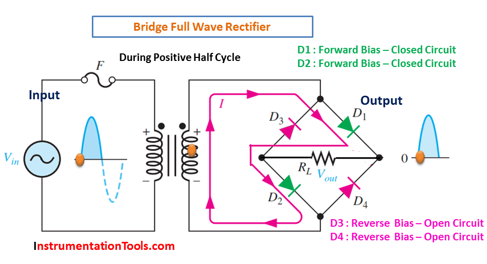

Superb. Thank you Jan! So, do I just put AD797 in place of AD825? What changes, if any, do I need to make for +/-18V instead of +/-15V? Also, the link says, "The regulator boards accept a DC input from your favorite transformer/rectifier/reservoir cap". Where can I get any help on this? Such as at least the schematics and BOM?
Thanks so much!
You should not use the 797 in this design; the 797, while superb in signal chains, has a tendency to instability in regulators.
Both Walt Jung and myself recommend the AD825 for maximum performance.
For the transformer/rectifier/reservoir capacitor, there are many designs here, and it is not critical at all. Even Google 'full wave rectifier' will show you lots of examples. To keep the two regs fully independent, with no shared grounds, it is best to use a transformer with two separate secondary windings. For +/-18VDC, secondaries of 18VAC on a 100VA transformer is fine.
Use fast, soft recovery rectifier diodes, and don't overdo the capacitor value; it has no performance advantage and might generate fast current transients that propagate into the circuit. Something like 4700uF/35V would be fine.

Thank you Jan, this is super helpful! Could you please clarify a few points?
1. So, Schottky diodes are OK (fast and soft) right?
2. Do I need a 100VA transformer (my maximum power consumption is 10W)?
3. If I can't find the 18VAC secondary, would 17VAC or 20VAC be better? Or does it have tobe 18?
4. The preamp has a common ground, do I still need separate secondaries?
Thanks so much for your help!
Alex
Two separate secondaries means that you can make two fully separate DC inputs for each reg (pos and neg) and only connect their grounds at the reg outputs. No common ground returns = cleaner outputs. You will have two rectifier bridges so two capacitors.
If you need only 10W you can do with a 30 or 50VA transformer, yes. If you can't find a an 18VAC xformer I would go for 20VAC, 17VAC is cutting it close especially with low mains voltages.
Schottly diodes: not sure they are fast and soft recovery. They may be fast and they have low drop voltage, but look for soft recovery diodes. They switch off softly which lowers spikes. If you go to Mouser you can select diodes and progressively narrow it down to say 100V, 1A continuously. Probably https://www.mouser.be/ProductDetail/ON-Semiconductor/MSRD620CTT4G?qs=ZpPixqFcBtxVfHzz/hqSiQ== will do.
