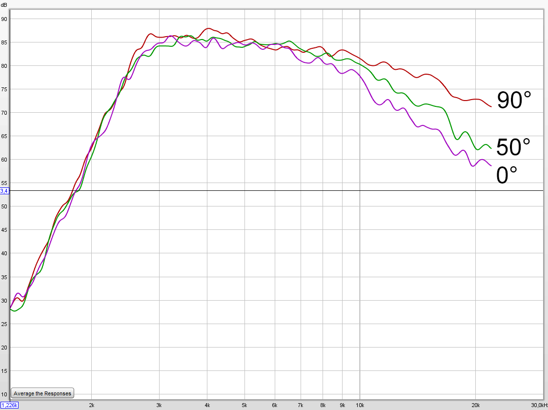

Sorry for the really slow reply. I finally now had time to check it out. I don't have a program yet to produce the usual polar graphics, but I did measure the response with REW in my living room.
Starting straight ahead (90 degrees) at 3 meters and then keeping same distance, measuring every 10 degree steps all the way to the side to zero degrees.
The tweeter has the frequency response already corrected to the way I normally listen it, so that's why it's quite straight. Also it has 4th order high pass filter at 2900hz. I have found it to be a good choice when it's like this, bare naked without the XT1086 waveguide.
Under it is a wooden holder I quickly made for testing, it's ok as it does not produce reflections.

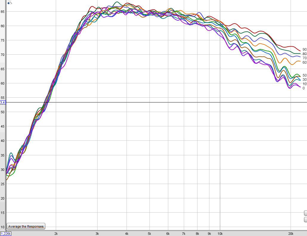

In this graph I included just three of the measurements, so it's not so cluttered.
Here are all of them.
This verified what I have heard while listening, there are no major anomalies at any angle, and the field is quite wide which suits my purpose well, since I often have people listening and dancing all around the room.

Machismo, Your measurements support why Troels Gravensen decided to add a super tweeter above the 18 Sound NSD1095N to his "The Loudspeaker rev1 & rev2".

Moreover the measurements shows why such a driver needs a horn/waveguide if you want to use it below 3kHz (in this case).
What about them suggests this?measurements support why Troels Gravensen decided to add a super tweeter
I don't think this measurement showed that, if you are just talking about the response plummeting below 3khz? Like I wrote earlier, while I did this measurement, I had an active 2900 hz high pass filter there, so it should and it will go down anyway because of that.
However like I said before, my other measurements(which are not visible here) indeed showed that it does need a wave guide below 3 khz.
Not sure what you mean, since the NSD1095N extends way past 20khz and my measurements did not reveal anything about the actual sound quality.
I checked his build:
The-Loudspeaker
and unlike me, he does not use any digital correction and he built a traditional crossover.
And like his measurements show, I also noticed the NSD1095N with the horn has a big dip at 17khz, so I think that was probably one reason why he decided to add another tweeter.
I also feel(as usual), that there is some room for improvement in the sound quality department too, so his route makes sense.
He does not talk much about this, but states "What the Fostex adds is airiness to the overall sound"
I agree that when you have a dip like that, some airiness will be missing for sure.
Or maybe it was the horn that he disliked, without it the sound had certainly more airiness in my opinion. But of course he could not get rid of the horn because he needed to run the driver much lower than me.

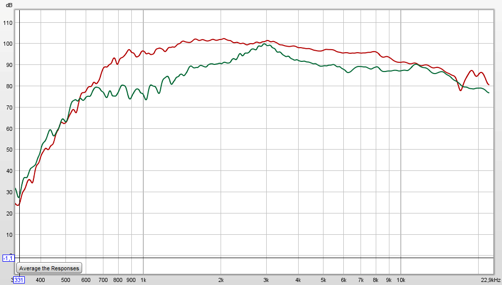

wow, it performs like 1" dome without horn. wonder whats its sensitivity @20k? 95db maybe?
Yes, I didn't then expect much from this experiment, but was pleasantly surprised. It does work, but you must EQ it aggressively get all the benefits.
Since I see there is interest to this, I made another measurement from straight ahead @1 meter away, to show the actual difference with and without the waveguide.
This time I did it straight with no correction or EQ, just with a 500hz 4th order highpass. From this chart you can also better estimate the sensitivity.
Red is with the horn, green without.

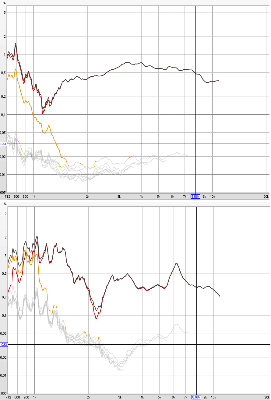

A distortion plot would be fun to see as well. 🙂
Here are the plots, black line THD, red 2nd order, yellow 3rd order. First one is the horn, second without.
To get really comparable results on the distortion in real life situation, I would have needed to match the volume first on all frequencies, since bare driver needs more power for the same spl. However I think I did it in the past and I recall the results were quite even.
