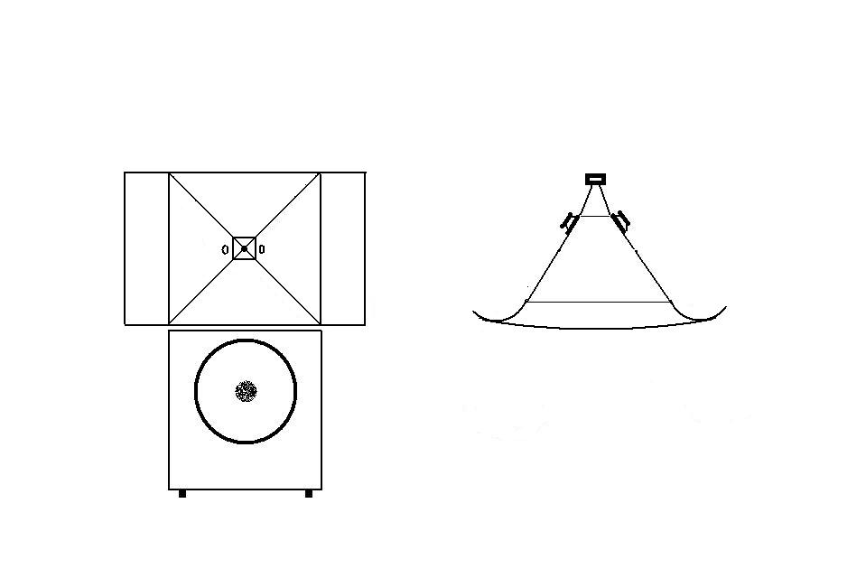

I have some CD-Horns too (HR9040a + Fostex D-450, Il like 'em with foam), and even though they were EQ flat to 16 Khz (my hearing stops at 17 Khz) it didn't sparkle at the top as much as I liked.
So i thought of adding a supertweeter. Alll tweeters I had a the time did not only add sparkle, but also the in-your-face "sizzle" that drives Dr Geddes nuts, too.
Since all Tweeters I had were of the beaming type, I got me some Beyma CP-21f slot tweeters. Which now gives me just what I was looking for.
I for one would go looking for the tweeter that suits your taste best. But if you really want to stick to a Mid-High-WG then I would start looking at the WG for the fault and not the driver.

This is one I would like to try 🙂
- 18sound NSD1095N v's B&C DE250
