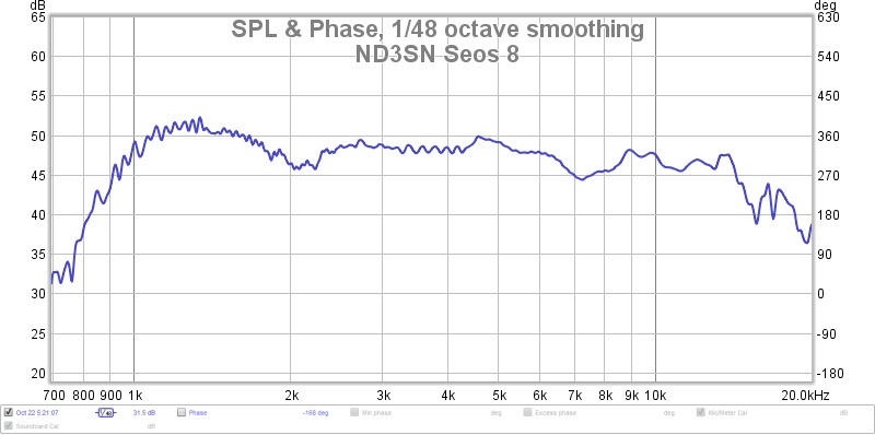

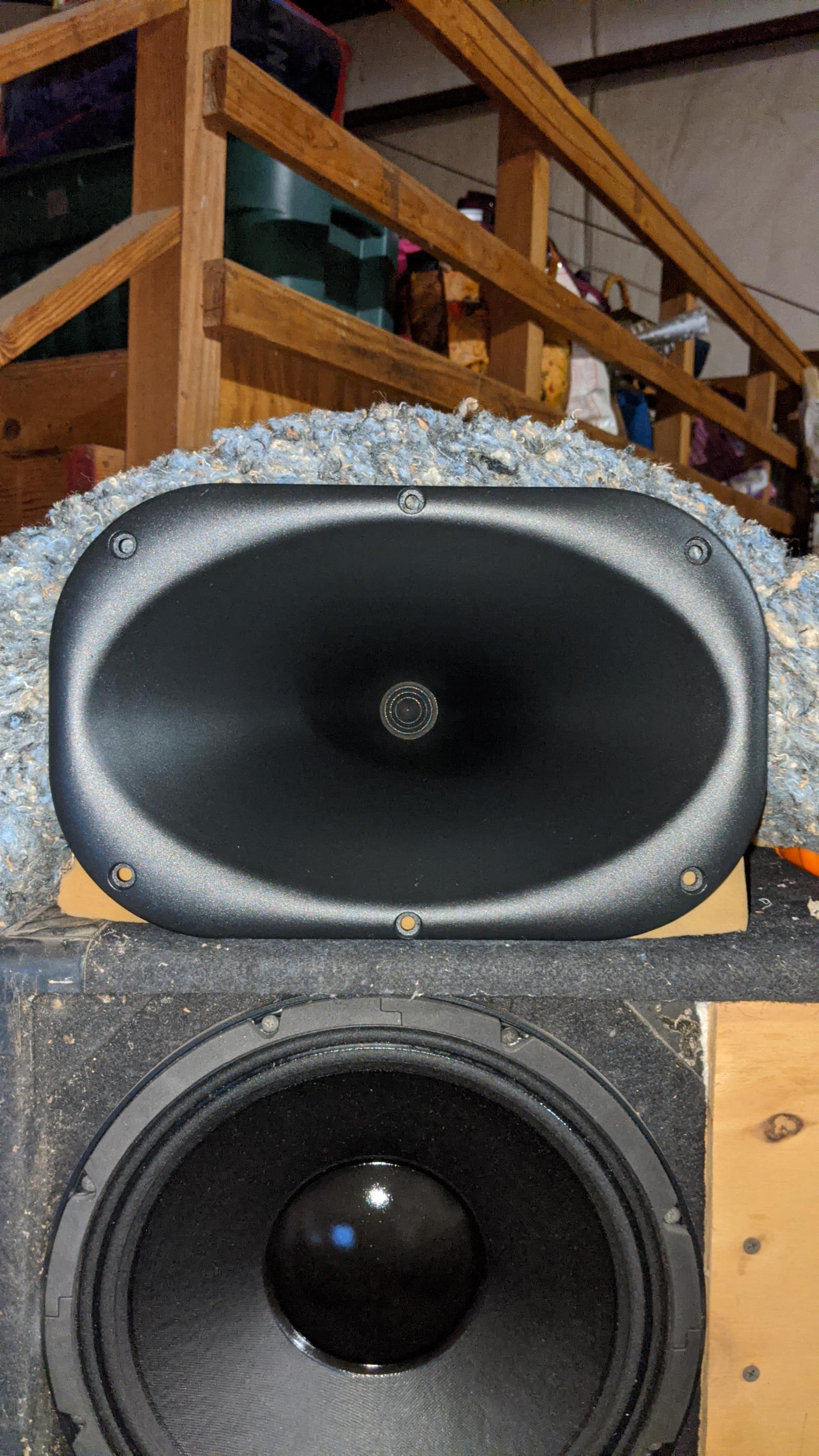

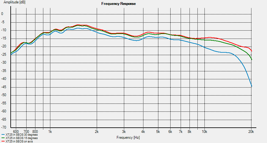

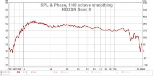

ND3SN 1 meter from the mouth no eq. Peerless XT25 on the same waveguide courtesy of Pete Schumacher.

Not sure where the shortfall in the measurement chain is but I couldn't find any major differences on paper.
During music playback in a system it is clear the 745NEO has quite a bit more hash. The ND3SN sounds more laid back while having better instrument separation and detail. I'm surprised how audible the difference is. Guess that's where beryllium would help for the Radian.
Will live with them for awhile and maybe give the HF1440 a try. Although I'm pretty happy with these at the moment.

Current setup is just a temporary mono stack for testing purposes. Compared both drivers mounted through a flat baffle with 1" foam on the surface. Didn't like how the waveguide was interacting with the top octave. Eq'd relatively flat from 2khz. Crossed at 2khz LR24 to a prosound 8".

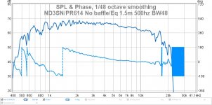

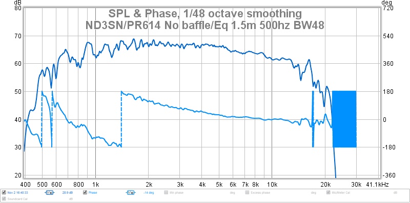

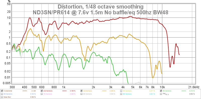

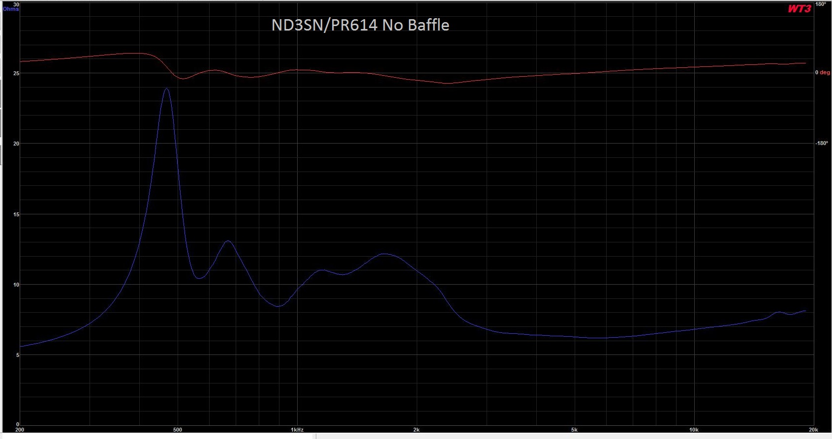

Some data on a horn. Off-axis response is similar to the XT1464(quick RTA check). I was hoping for less beaming in the top octave but it's still very controlled up to about 14khz. Must be a result of the conical exit.
Distortion is actually pretty good imo. This was a very loud sweep and probably the most I'll ever need out of them. Gives me flexibility in a nested horn effort. Will listen to this stack for a while and try the NEO745 later.

Been listening for a week now crossed at 1.2khz with semi-linear phase alignment. I don't have any desire to try anything else in the near future. Works well without a baffle if you have some kind of damping material on the mouth edge.
It's deceptively loud and clean in the highs while the 1200w mid channel is clipping the 98db/w 12" mid-bass. Excellent resolution I've only heard on good direct radiating domes up to now(Bliesma T34).
