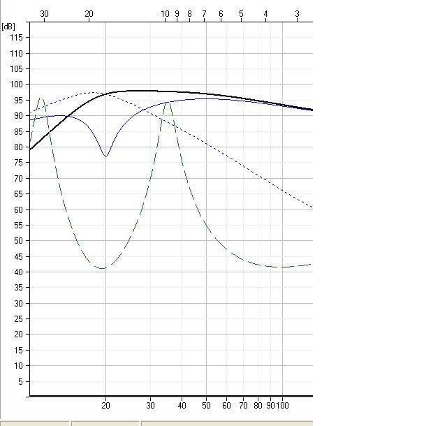

Running the simulations in 3 different software sources, I get an F3 of 45 for sealed 2.8 cubic foot boxes and F3 of 25 in a ported 5.3 cubic foot box.
I see so may guys running them in huge boxes sealed that would be a Q of .5x. Bigger than 5.3 in ported boxes would kill transient response wouldnt it?
Whats the big rave about these subs? Am I missing something?
What am I missing? Wouldnt 2 15" TC LMS-15 in ported 10 cubic foot boxes be a much better choice? Sealed they drop to 37hz Im not hating on the 18 just trying to understand the reasoning. two of the TC 15's even cost less. I'd rather have less cone weight and more drivers for power handling not to mention it beats the LMS ultra in extension out of the box. Lighter, deeper, more cone area, and cheaper.....
This is what I get. Output is from Basta!
vented box size: 160 liter

As it relates to transient response, yes.Aren't you just talking about Qts?
I'm sure you have heard that.Didn't I hear somewhere that a good portion of what we interpret as "bass speed" is actually from higher frequencies and proper time alignment? Maybe I just need more coffee this morning.
I have been involved in such discussions.
Although much of perceived "punch", "speed", or whatever you'd like to call accurate transient response is above 100 Hz, accurate transient response below 100 Hz is also needed for accurate reproduction of music and special effects.
