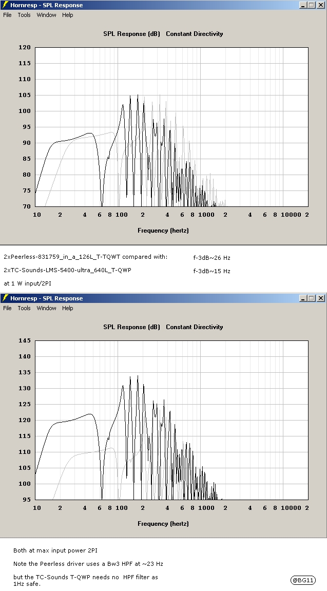

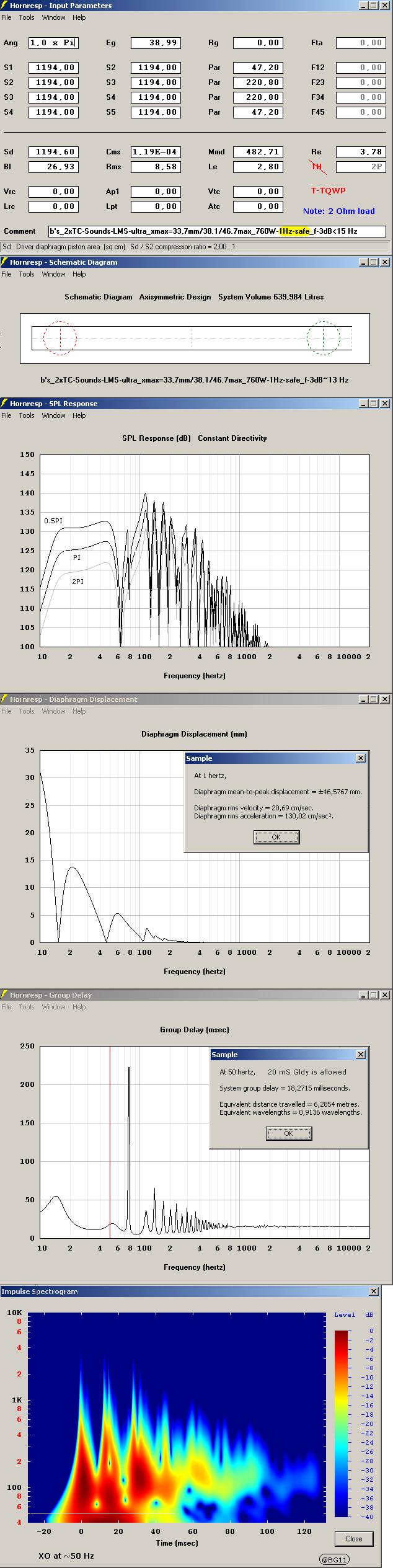

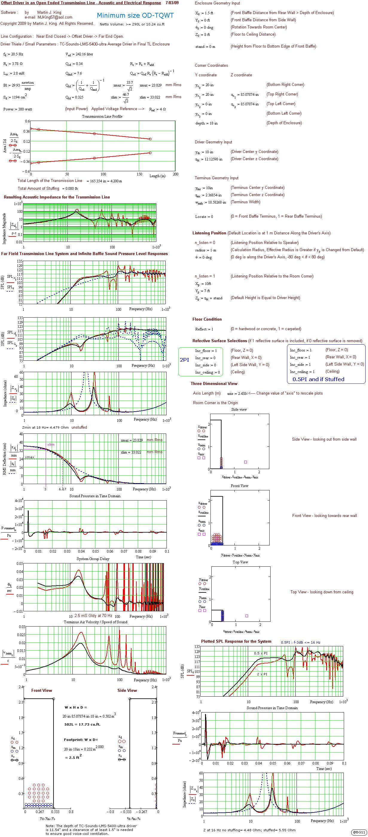

I remember bjorno posted a T-TQWT sim with an LMS 5400 Ultra and it looked brilliant on paper, I didn't save it though, dangit. I should have, because if I ever got a couple of 5400's that's probably what I'd try first.
Imo, Transmission line and/or quarter wave tube type designs are for main speakers and are not meaningful for subwoofer design. Atleast what I consider subwoofer requirements. At that point you might as well design a nice horn design. (Interesting you post that, I was reading that TH or T-TQWP thread 😉 )
Oh, the frequency response looked phenomenal. I wish I could find it again. As far as the quarter wave tube sub, I've had them for a while and I love em more than any of the sealed or vented boxes I've had over the years. I'll never build another BR or sealed sub as long as I live 😉
Not a fan of subwoofer horn type designs myself, too big and they do not extend low enough for my requirements. Hence the reason a driver like the LMS5400 exists.
I think the one I saw f3'd at about 13 cycles or so, but without the sim he posted I can't say for sure.
