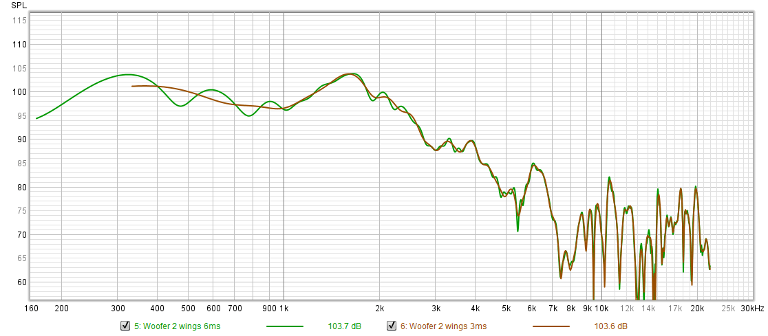

I don't think there are any room reflection within 6ms. Maybe 1.2ms from the floor bounce.
Here is 6ms and 3ms

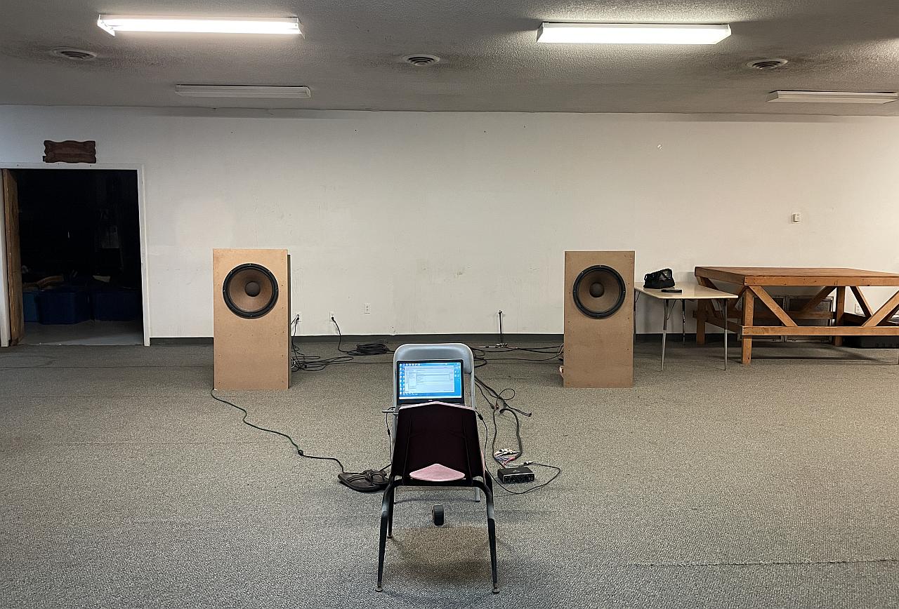

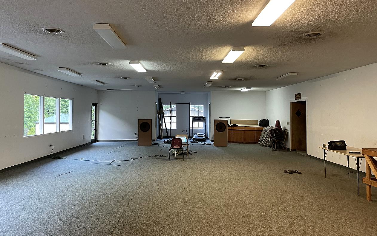

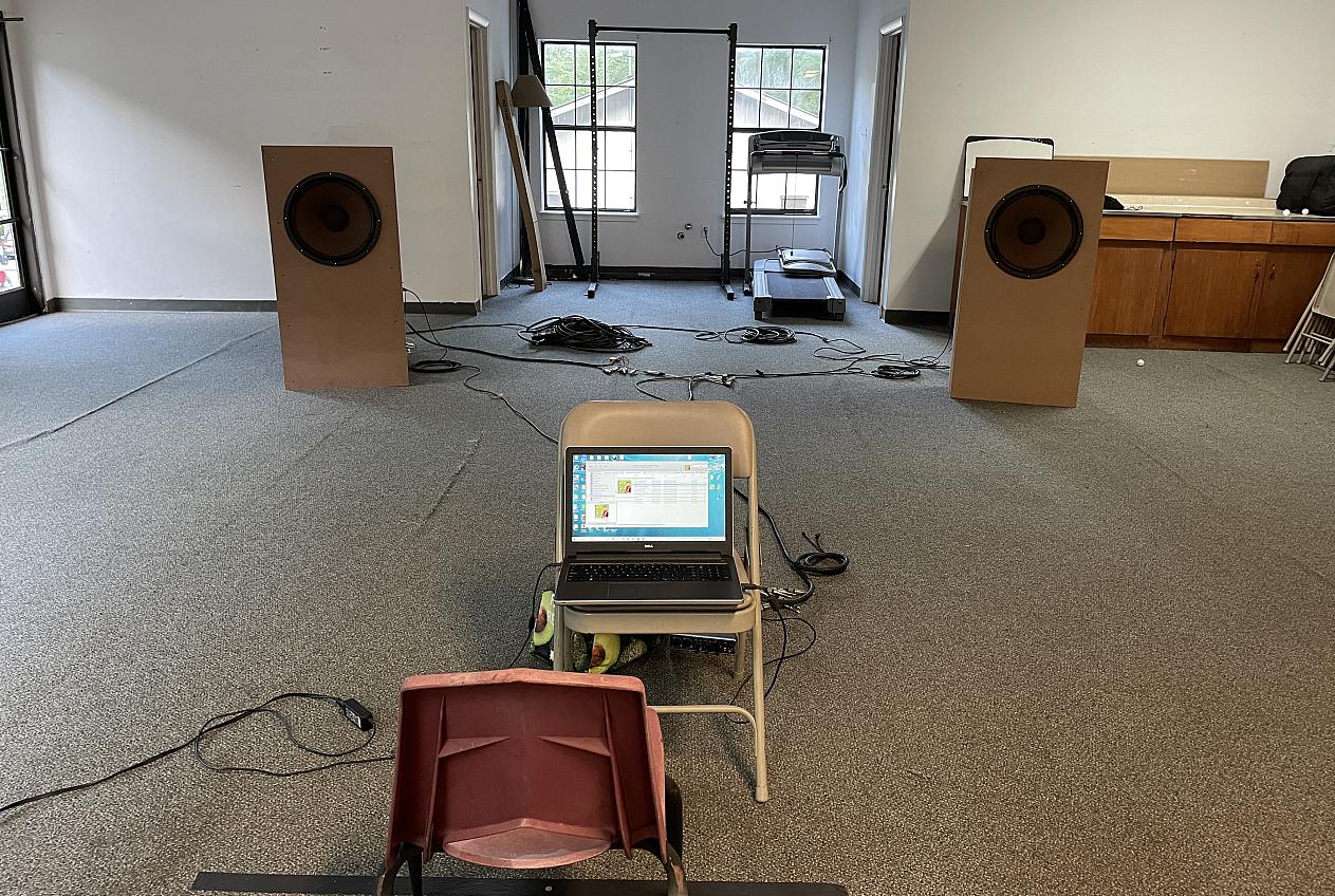

I've spent some more time working on these speakers and the results are worth it. Of course there was crossover work and some room positioning work. One major difference yesterday was that I switched to the long wall of the room, so that wall behind the speakers was a plane, not a stepped alcove like the short wall. Here are photos of the two different placements. In both cases the rear of the baffle was 7' (~2m) from the wall, or 7 & 13' (4m) for the alcove setback. These are large speakers, but hardly look it in a room like this!

These two placements sound about as different as you would imagine. With the dual depth provided by the alcove, the sonic image had good depth, but almost everything with depth ended up back in there, the spread usually wasn't wide. Playing the flat wall, there was less illusion of depth, but the image was wider and not many sounds stuck to the speakers. Voices seemed more present and realistic on the short wall. One odd thing that was noticeable was how the depth was flipped compared to my lava cave system. https://www.diyaudio.com/community/threads/caveman-speakers-the-troglodytes.269864/ The cave system would put voices right at the speaker line, with orchestral stuff behind, for example Frank Sinatra with orchestra. But this room and speakers flipped that with Sinatra deep and the orchestra more up front. :xeye: I don't understand how that happens.

Crossovers. A lot of different configurations were tried. On the short wall I tried a 100Hz low pass and 2kHz high pass, both first order. This did work well and help vocals, for sure. But it wasn't perfect. After trying a few more things I settled on 60Hz low pass (1st) and 800Hz high pass on the horn, 2nd order Butterworth. Horn same polarity as the woofer. That cleaned up vocal and had the best tonal balance of anything I tried. Still not perfect but getting there. These two different crossovers sounded similar, more similar than expected. A PEQ was used to bring down the horn peak at 1550 Hz by 4 dB. It made a bigger difference with the 800 Hz 2nd order high pass, as you might imagine.
Moving to the long, flat wall, the mixed 1st & 2nd order was not the preferred filter. After a good bit of trial and error, I ended up back at the all 1st order - this time low pass @90 Hz and high pass @2 kHz, I sill used the notch at 1550 Hz, but it wasn't absolutely necessary. EQ and levels were tuned by ear and with non-correlated pink noise. This is where the system ended up on the long wall, with the crossover just mentioned.

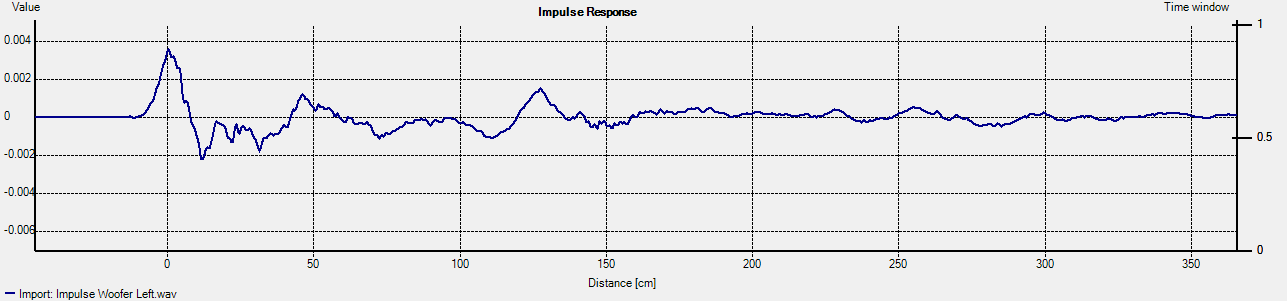

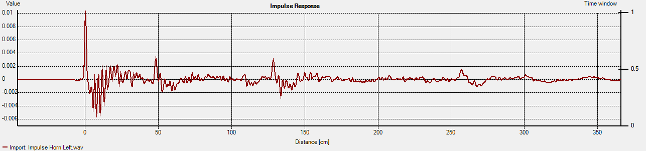

Joined 2004
Yes indeed, other than typical floor bounce, he ceiling is the major reflection. The floor and ceiling can easily be seen in the impulse plot at 48cm and 128cm path difference.

One thing I realized when looking at the sort wall is that (of course) there are a lot of reflections off the wall from the woofer, but almost none from the tweeter horn. That means that everything below 500Hz has a lot of room reflections and room tone, whereas above 500Hz the ratio of direct to relfected is much different. My first successful OB was with 15" woofers and an Altec 811b horn and it did work well in a much smaller space than this. Getting it right wasn't easy or quick.

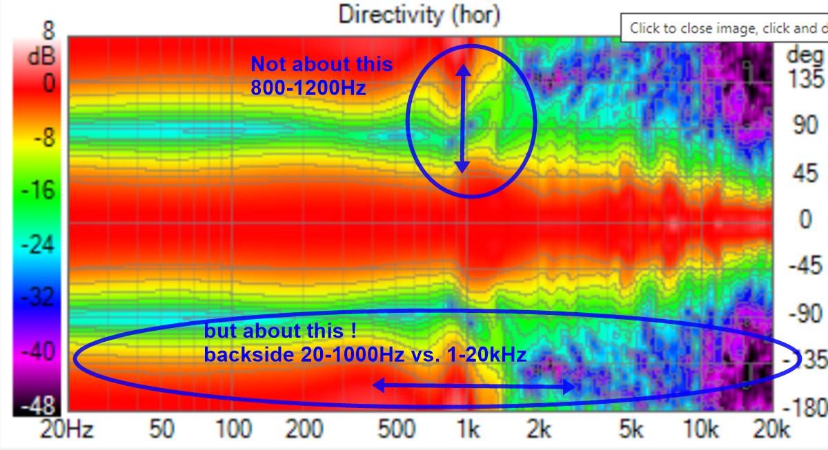

Yep, a dipole woofer and cd/horn are IMO too different for companionship. Horn totally misses rearside radiation and beams so that it doesn't excite early reflections.
This kind of huge transition should happen below room's Schröder F or above fundamentals (above 3kHz)
Reactions: 1 user

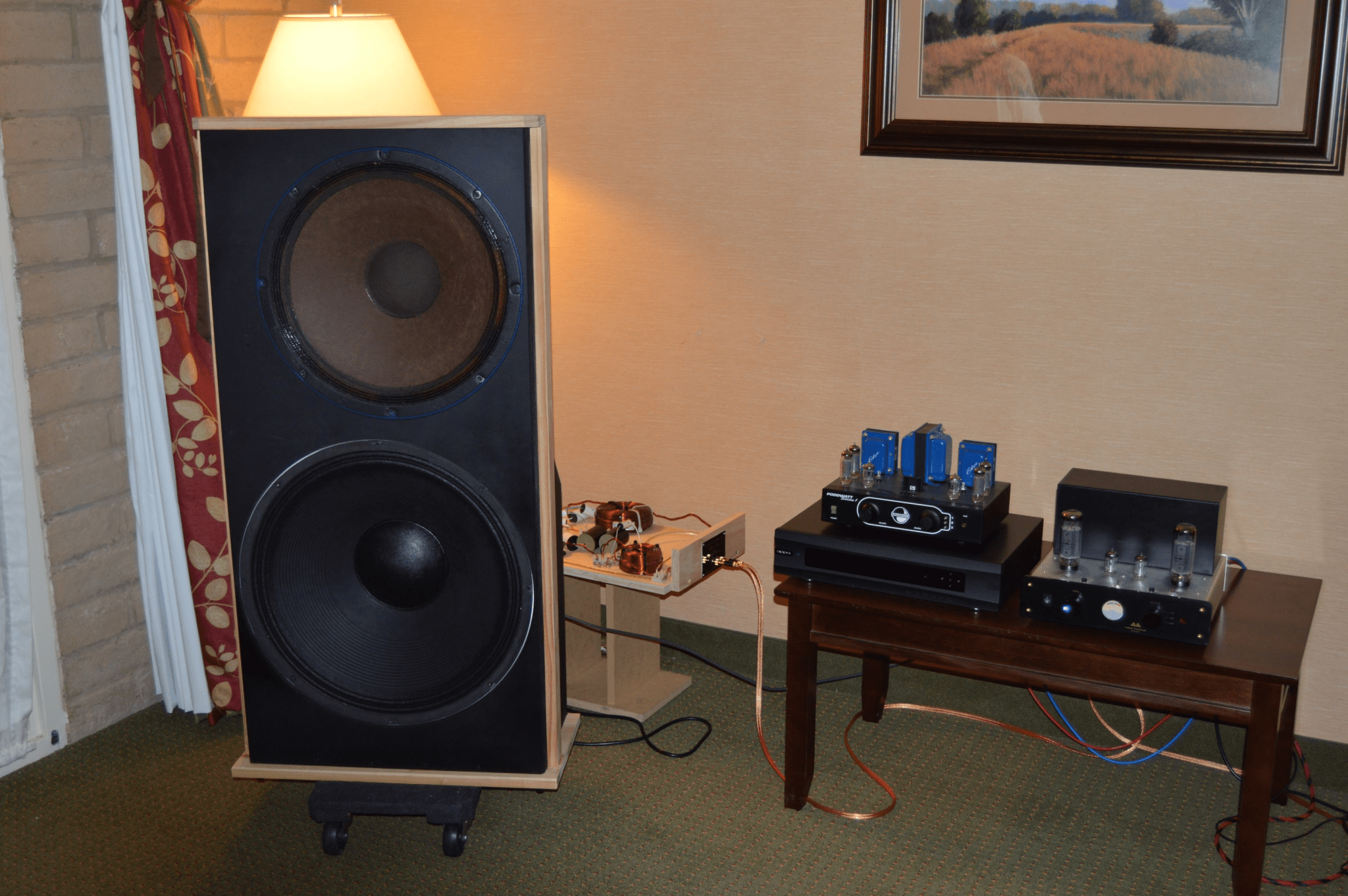

I did find a photo of our RMAF 2008 rig. Small room, big speakers. We got shut down by the neighbors, who were family of "The Absolute Sound" :D
Now if I could just reverse engineer the crossover from that photo......

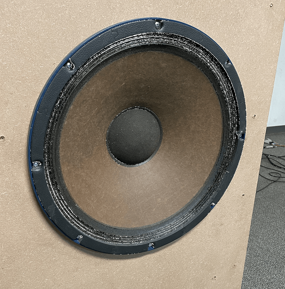

@DavidVicente Those look very nice, never seen them before. The basket and magnet cover look Altec inspired, but the coax horn not at all.
The 0.6 QTS would do well on OB. My favorite OB woofers were Selenium 15s with a Qts of 0.6-0.7 IIRC.
